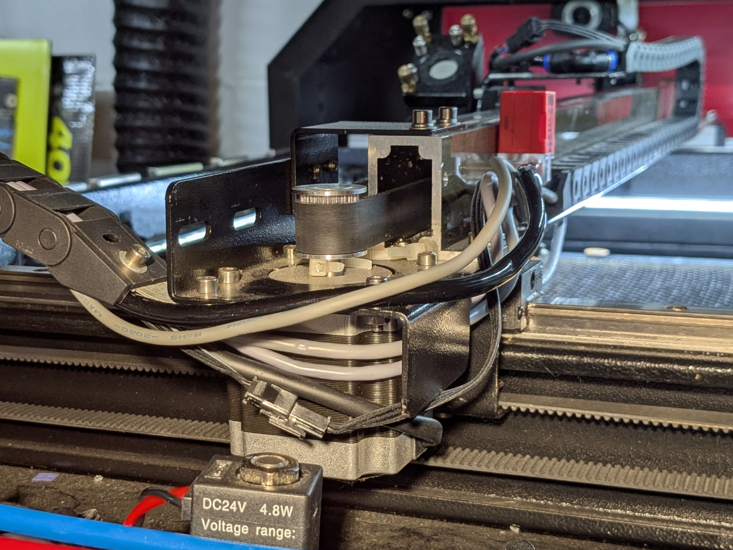

I managed to thread silicone ribbon cable through both drag chains to fix the autofocus “pen”, but I had to dismount the X axis chain for enough elbow room:
Crimping a connector in the middle divides the task into two smaller pieces:

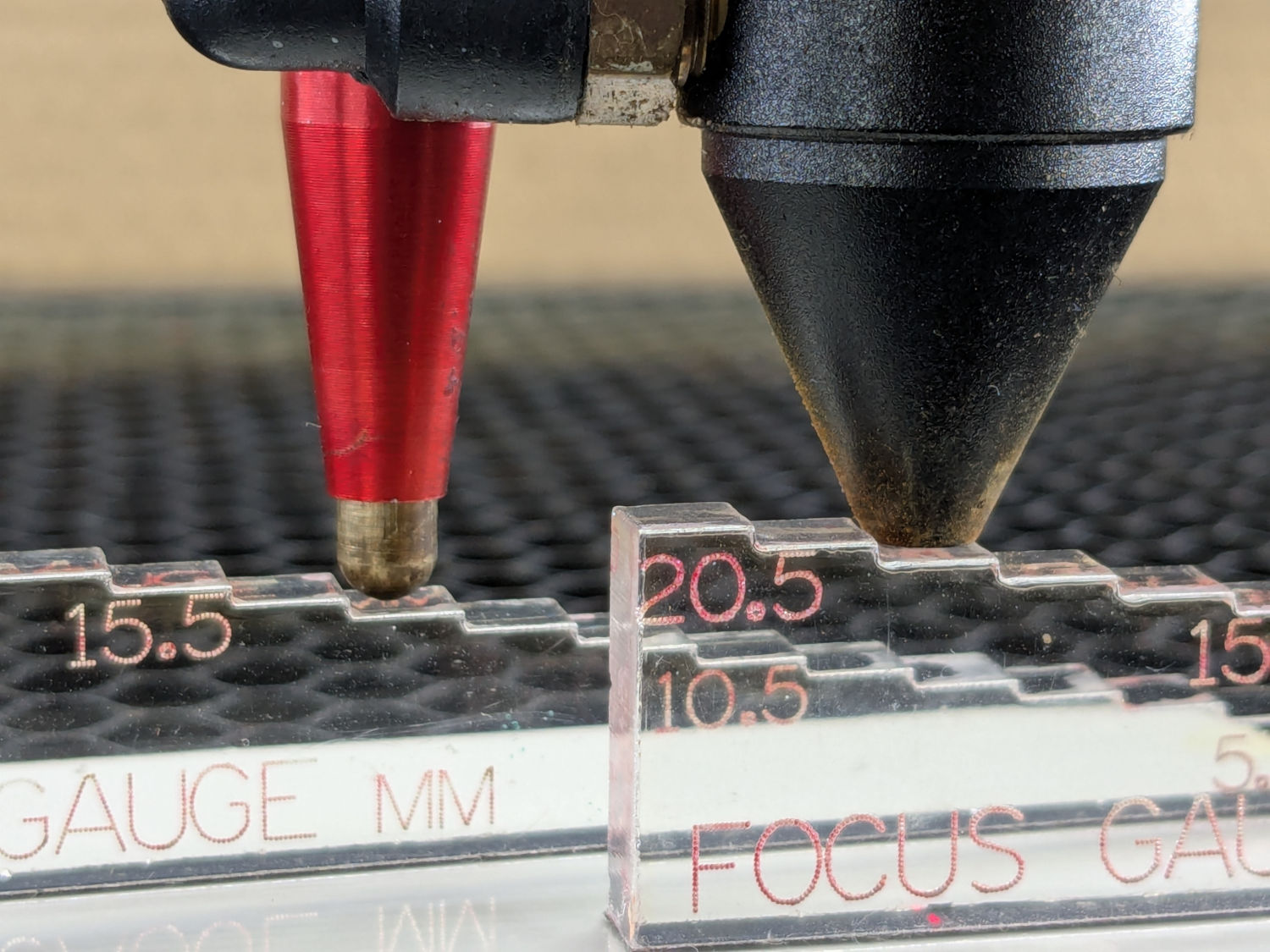

FWIW, reducing the pen overtravel shrank its stickout to 5 mm below the nozzle:
Good enough for my simple needs, but your sensors make a whole lot more sense! :grin:
