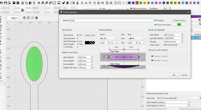

I am not sure I know how to ask the correct question…I would like to use Millmage to make a wooden spoon. I have tried carving a number of spaced circles to make the “bowl” portion of the spoon, and while it works, It is often not shaped as I want or requires so much sanding that it is not worth the effort. I know what I want the tool to do, I do not know what commands I need to use? Or is this an issue with Millmage not being a full 3D program (yet)? Any thought would be greatly appreciated.

if just using core im thinking use fluting will take bnit of time to draw it up
I have been trying a variety of approaches. Most look like I cut a hole in a spoon shaped piece of wood. I have not yet tried fluting…and I agree, I would rather do it myself…thanks.

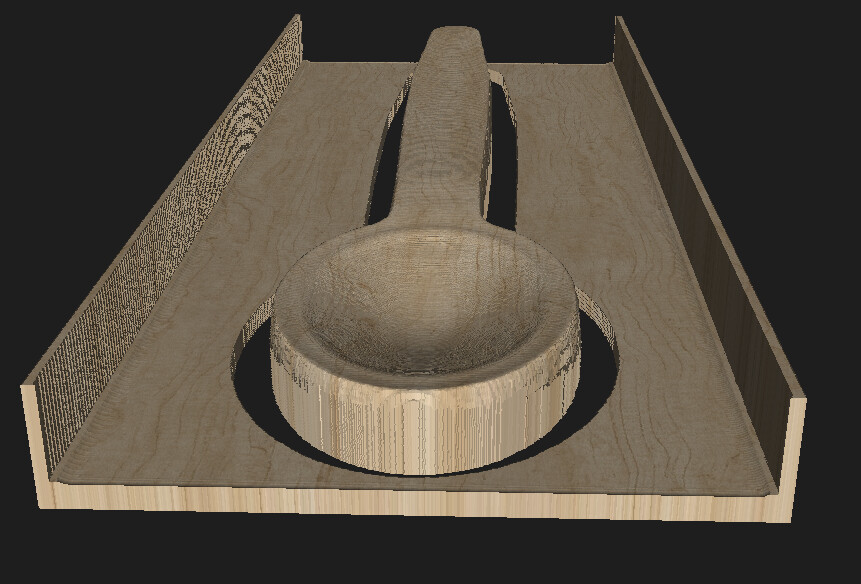

I like what you have there! Was that from your 3-D modeling?

no created it with fluting , give me a sec ill see if the screen record worked, nope ddont want play ball today
spoon.mage (21.1 KB)

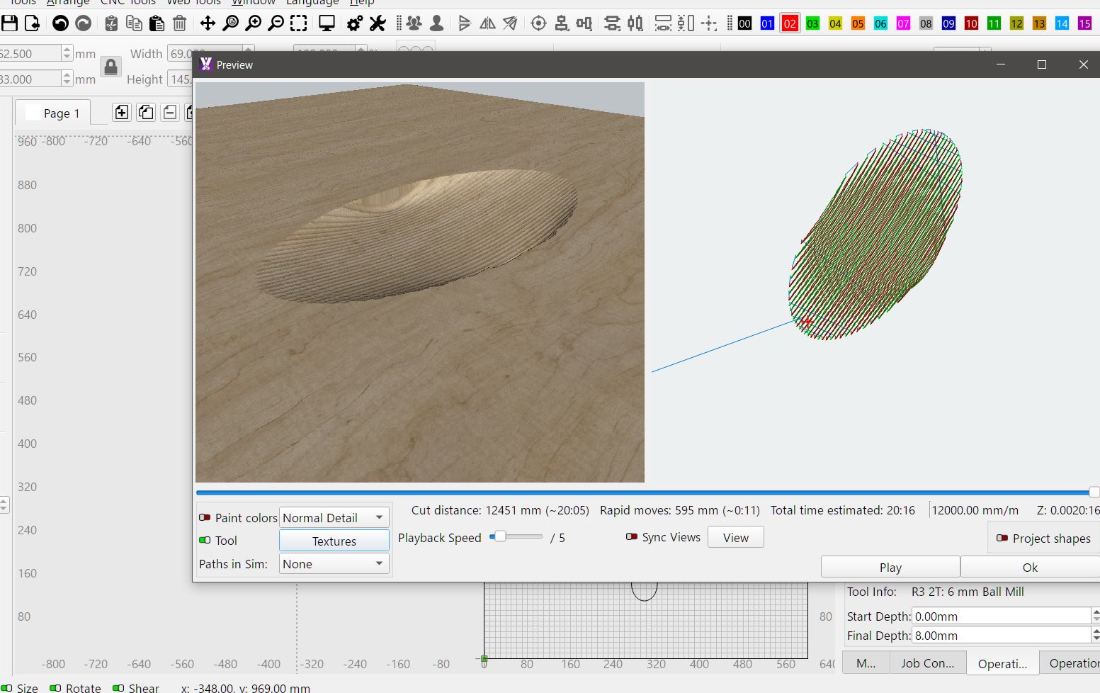

there will be a way to round out the edge where it is ssquareish using flute maybe change lines to a diamond tatch , you will see it in preview , i drew one line in center than create grid array one way than reselected that group then went other way , slow part is deleeting all the over lapping lines . brainss not playing ball thiss morning there will be a quicker way to acheive it

It definitely looks possible to do what you want using a height map.
Just keep in mind that you will need to use the MillMage Pro trial in order to use the 3D carving.
one of thesses things , might take bit of trial in settings to getit to work being so big .but its prob going still leave steps cause of the square edge

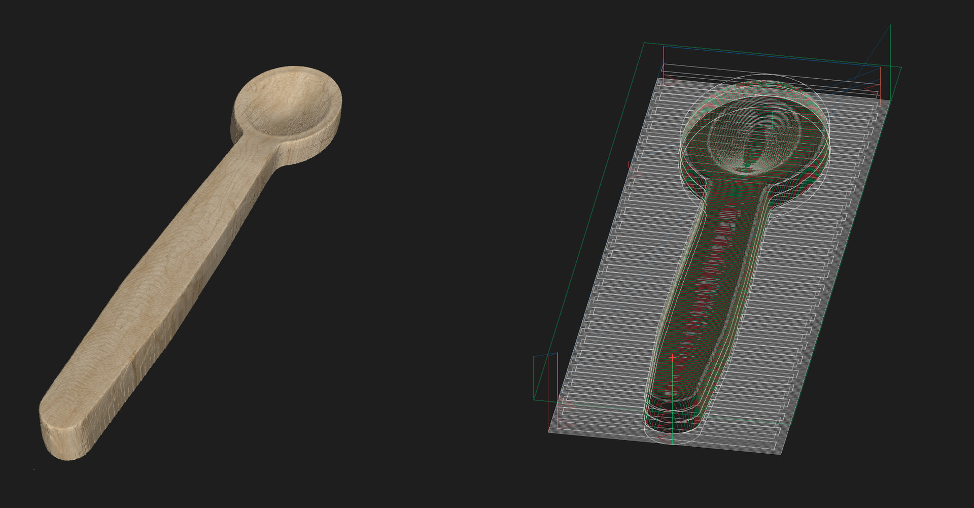

Thanks for the model…great starting point!
After you can reverse the spoon and mill the other side for a full 360° 3D.
