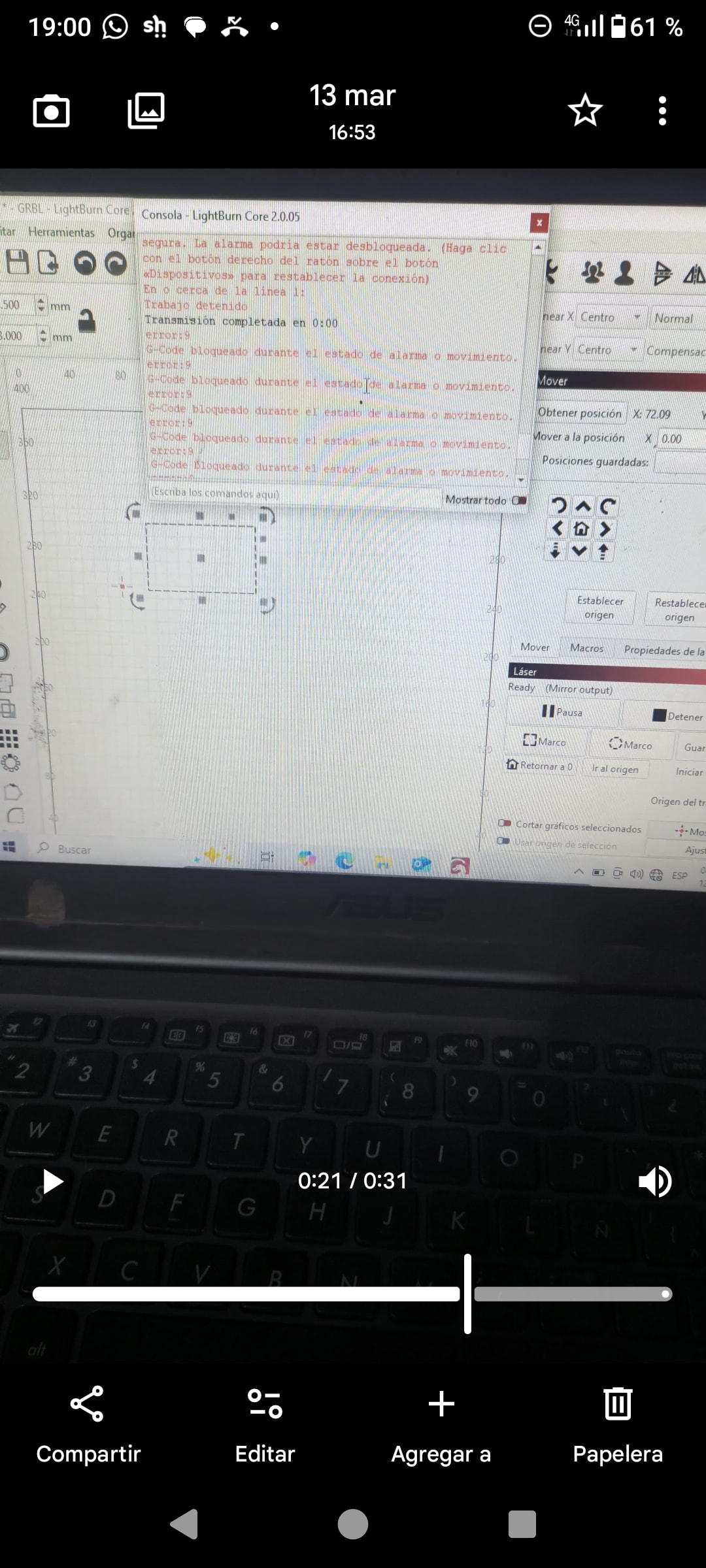

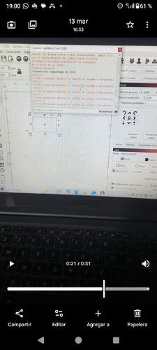

Hola me puede ayudar con 2 cosas
1 cuando tengo en modo mandril y quiero comenzar a grabar me aparece como error 9 y no me deja seguir .
2 si me deja hacer el grabado me sale alargado del tamaño del vaso me puede ayudar por favor
Gracias
You cannot just plug in the rotary and expect it to work. The red text in your image is telling something is wrong. I cannot translate from the image, so I do not know what it is saying. But you created an alarm situation (overtravel?) and need to do a Reset to gain control of the machine. A rotary has infinite travel limits, but your Yaxis does not.
You cannot just plug in the rotary and expect it to work. You need to turn off and/or adjust some GRBL parameters. You also need to perform the Rotary Setup properly.
Do you have the rotary aligned with the travel of the Xaxis?
