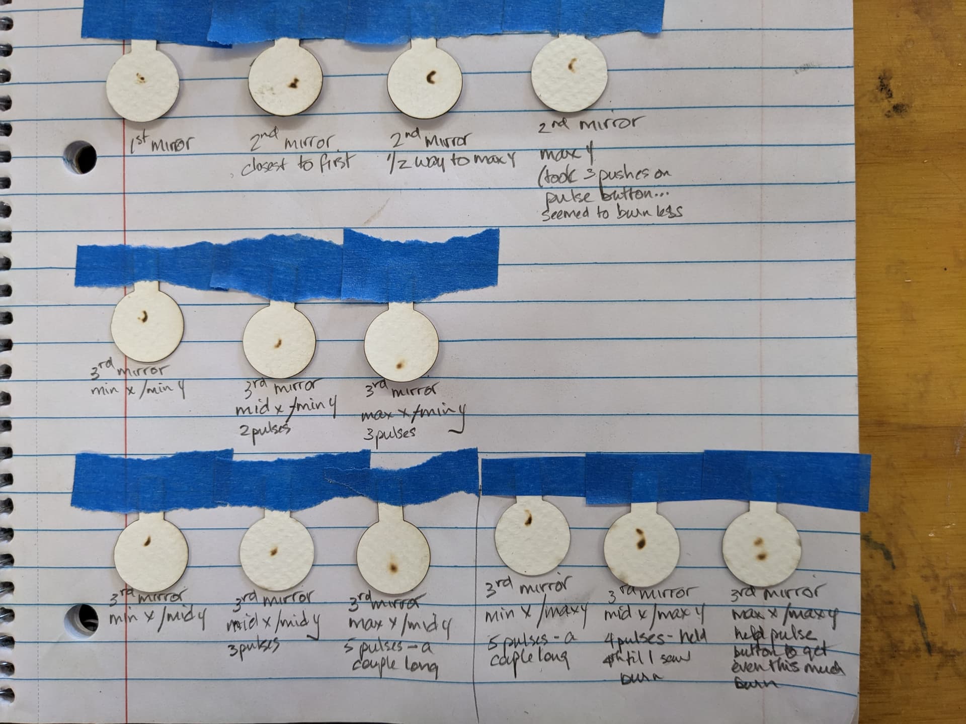

I posted a question here recently about how much ‘power’ should be lost vs the distance traveled. That is - the power is reflected through 3 mirrors and ranges in distance from \<12" (top left corner; min x/min y) to probably approaching 48" (bottom right corner; max x/max y). I had been using painter’s tape to try and align the mirrors and it was suggested that I should use ‘watercolor paper’ and cut out targets instead.
I removed the mirrors ostensibly to replace, but in yet another post - determined that I have the best quality mirrors already (polished metal?). So I merely cleaned them and reinstalled.
I am STILL struggling to try and get any kind of ‘cutting power’ when I work in the max x/max y area and one post suggested that my laser may be deteriorating (same post where I think I got the watercolor paper suggestion… sorry - sometimes the information ‘sticks’ in my brain, but the source disappears).
I cut out a bunch of watercolor paper targets and then started testing the alignment/power sequentially with NO mirror adjustments. Attached is an image of all my results with comments. Remembering that my reference is ‘top left’ is min x/min y (least traveled light distance) - I am looking for input/opinions on what I may be seeing/encountering. Personally - I THINK mirror alignment is reasonable… I wonder about the ‘shape’ of the beam that seems to be odd on a couple of the targets. Remembering that I am manually pushing the pulse button on my Ruida controller - there is some definite inconsistency in how long each ‘pulse’ would be. If someone can suggest a method to create a consistent pulse length and power - I would be open.
Thanks again in advance… this forum has yet to let me down!!

![PXL_20230325_215517231](https://forum.lightburnsoftware.com/uploads/default/original/3X/6/e/6e51a3e781997dd2820806ca84b943113474bebd.jpeg)
DANG it! Forgot to include the pic on the original post… sorry about that folks ☹

> [@WallyWood](#):
For Ruida controllers, you can set a pulse duration by digging into the `Menu → Laser` settings.
For GRBL controllers, I think you could hand-hew a G-Code file to turn the laser on, pause for a while (with `G4 Pxxx` where `xxx` is either seconds or milliseconds or something, depending on your controller), then turn the laser off again. You’d send that file to the controller every time you want a pulse.
With that said, I think all your targets show a defunct laser tube that is not operating in TEM00 mode. At the entry to the first mirror, the beam should produce a nice circular disk, maybe 3 mm in diameter depending on the power & duration, not the tiny spot you have.
The `C` shaped spots are completely wrong, no matter where they occur.
Given enough travel distance, the crappy beam spreads enough to look almost normal, but that ain’t normal.
Other folks will surely chime in with different information, but IMO the reason your laser doesn’t cut properly is due to a bad tube.

You need to tell us what kind of laser you have… the one in your profile seems like non-sense.
IMHO, this pursuit is a waste of time.
You simply have no control over this, so is it academic?
Looking at your targets (up is up in position?) You have more serious issues than the path loss to get this working.
Your [TEM0](https://www.civillaser.com/news/all-laser-spatial-mode-graphic-comparison-1093/) state appears to not exist, so it will never work correctly.
You impede our ability to help you with no information about your laser. So help us out.
@ednisley has given you the bad news… probably true… I bought my last tube from Cloud Ray…

> [@WallyWood](#):
> Based on my tube measurements (length x diameter) it would appear to be correctly rated
The tube may measure properly … many good tubes manufacturers produce grade B tubes. They don’t sell them to the good customers of theirs, but to the vendors building these machines at low cost. A grade B 100W tube may produce 90/95W instead of the correct power output for the current draw. This is generally attributed to mirror alignment during manufacture. These have to be very precisely aligned.
A grade B tube, they tell me, has it’s gasses degrade quicker because they have an incomplete lase operation…

> [@WallyWood](#):
> cut through a 3/4" pine board I provided in 3 passes
So it was defunct when you got it.
My alleged 60 W CO₂ laser cuts ¾ inch pine in one pass at 70% power = mid-30s W, moving 2 mm/s. A 100 W laser should cut pine like (rather smoky) butter, assuming the seller knew its capabilities and ran it at a reasonable power for the task.
Here’s _my_ problem: you’re a new laser user (as we all were at one time!) and, as you try new processes, you will ask The Forum for help. _Every [obscene gerund] time_, we will go through a tedious debugging process to rediscover you’re using a defective tube that _cannot_ produce the results you expect.
It is entirely your prerogative to keep using a bad tube, but IMO you’re pretty much on your own, because ain’t nobody got the time to help you re-re-rediscover your laser has a bad tube.

> [@WallyWood](#):
> way to understand what ‘state’ it is
I think you can if your a physicist 🤪
I think it has to do with both mirror alignment within the tube and effects on the gas mixtures within the tube that you depend on working in a certain way.
A great tube will go bad sitting on the shelf, it will also go bad when driven with too much current, too warm and I’ve been told by low power levels. Most recommend a certain power level during the lase operation. If you check out a lot of the tubes, they will specify a minimum/maximum power output.
One had a 180W as a minimum of 36W meaning it wasn’t meant to operate below 20% power.
My 50W machine from OMTech turned out to be about 44W (Mahoney meter). I replaced it with a 40W from Cloud Ray and it produces 40W as specified…
These low cost vendors are where the grade B tubes show up… Just buy from a good vendor.
