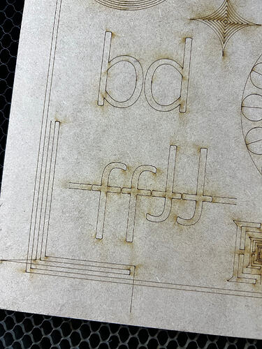

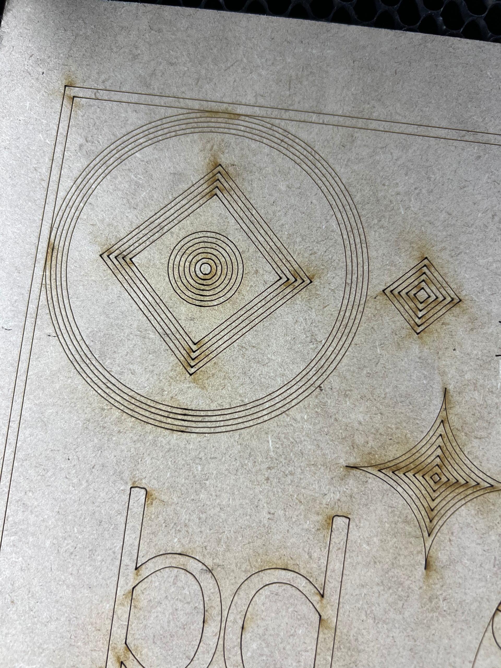

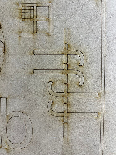

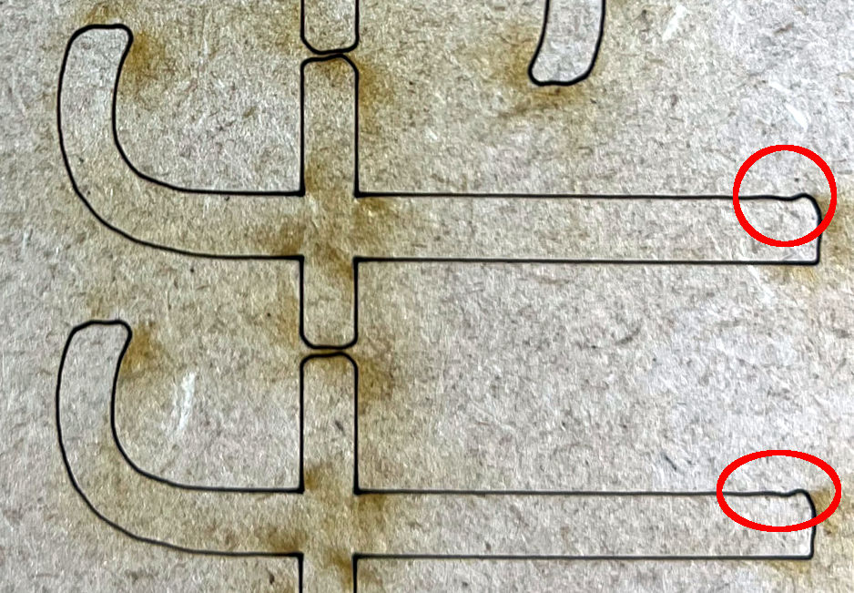

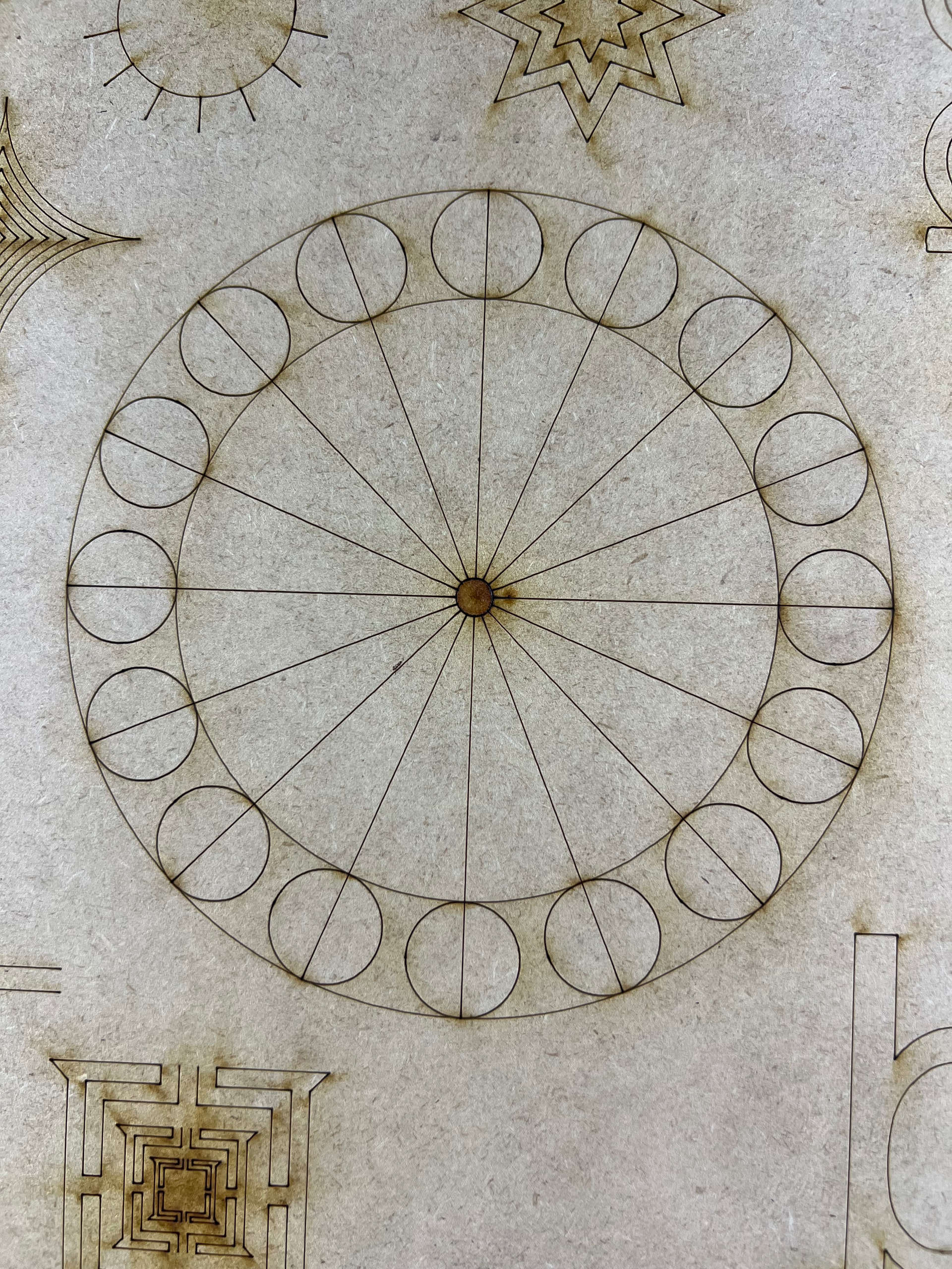

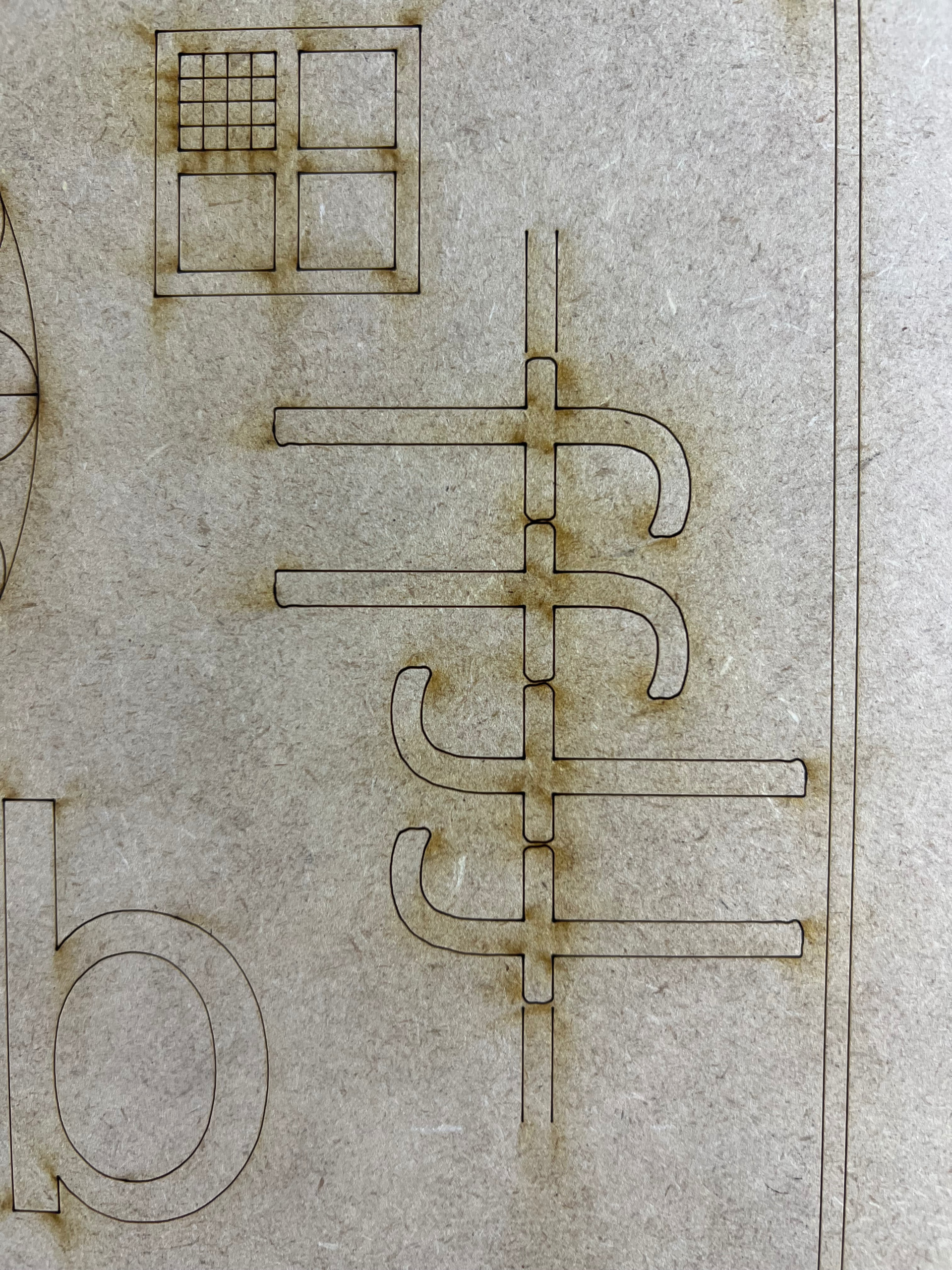

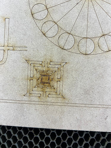

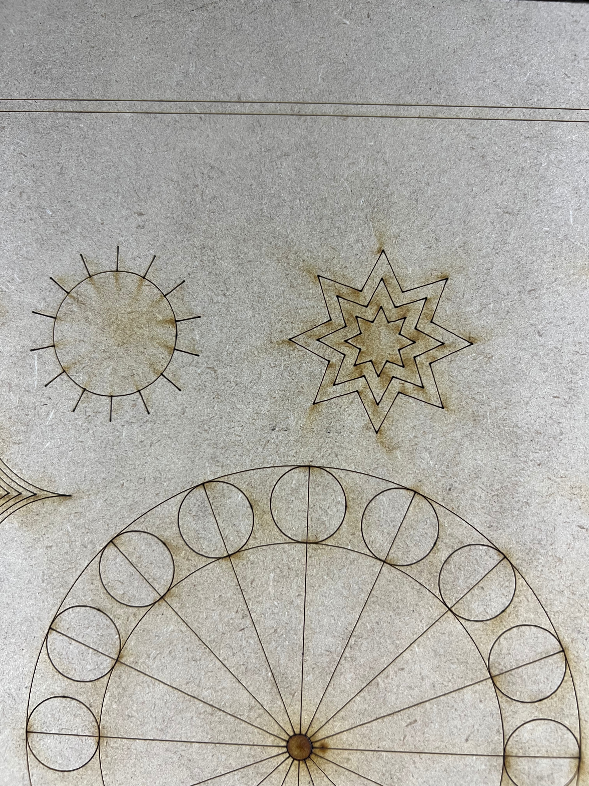

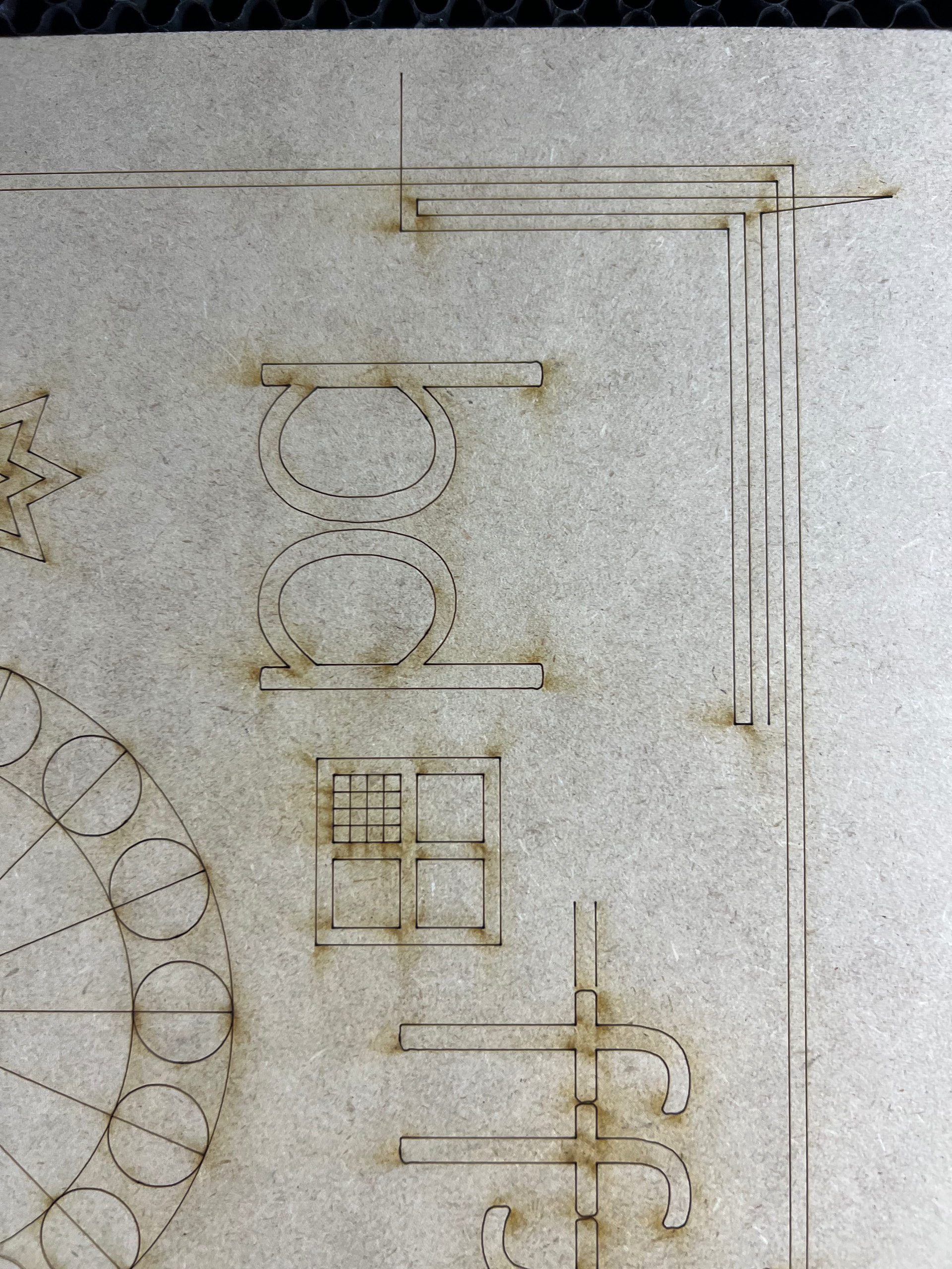

So here are the results from my backlash test, I noticed a few things but I’m unsure how to interpret them.
 ![IMG_4953](https://forum.lightburnsoftware.com/uploads/default/original/3X/1/c/1c6d59d4c8daa57ae11639f4acc6e5c16db87671.jpeg)

Given that we don’t know which laser you’re using, it’s hard to be specific, but there’s nothing seriously wrong with the pattern.
The small wiggles on the stems suggest it’s a gantry CO₂ machine:
 ![LightBurn - slight Y axis wobble](https://forum.lightburnsoftware.com/uploads/default/original/3X/6/5/65afc491ec2334ba7e61bb05a58647348b31c766.jpeg)
That’s due to the slight wobble inherent in the heavy laser head suddenly changing direction in the Y axis. There’s not much you can do to fix it, because typical machines cantilever plenty of weight far out on scrawny bent steel brackets.
Unless you have a specific problem with a design, it’s time to Fire The Laser! 😁

What things did you notice?
I would say overall it looks good enough to not mess with anything. I see a litle resonance (squiggly lines), but that may be due to the mechanical design of the machine.

I have an Omtech Pronto 40, thanks for the reassurance! @MikeyH thank you as well!!!

I’m unfamiliar with the definitions used (particularly speed), but overall, if my machine produced an identical result, I would be very satisfied.
Unless you’re aiming for “perfect perfection” (if such a thing exists), I wouldn’t change a thing.
