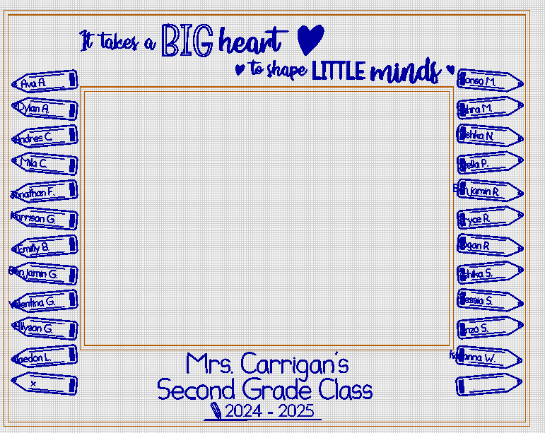

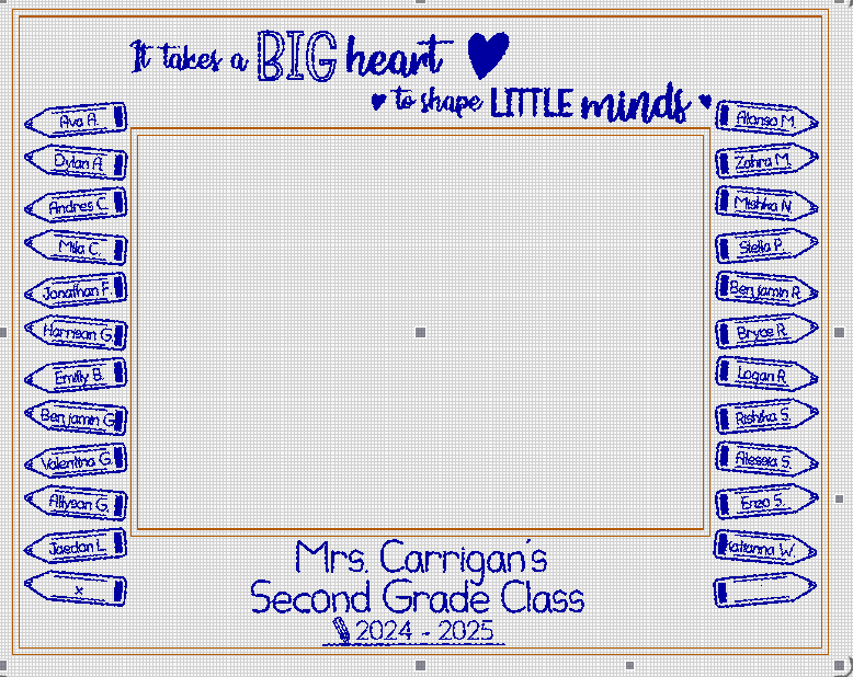

When testing variable text, the text is correct, but when I bake it, it moves the text to the left.
Test view
 ![Screenshot 2025-04-28 162952](https://forum.lightburnsoftware.com/uploads/default/original/3X/9/3/937e2674208865df36aee9219d64efd832fc7ed8.png)
Baked
 ![Screenshot 2025-04-28 163220](https://forum.lightburnsoftware.com/uploads/default/original/3X/8/f/8fef4ba5dc9c3997cbcae2cac80dd3915bfff1e3.png)

That’s very peculiar. If you would, upload the lbrn2 file and the csv. I’d like to investigate.

My wife deleted the .csv file and recreated it and the issue went away. It must have been an extra space or something. It was just odd the preview looked fine.

That’s what I was going to look for, something odd in the csv file. You’re right, it is odd that preview and baked were different.
