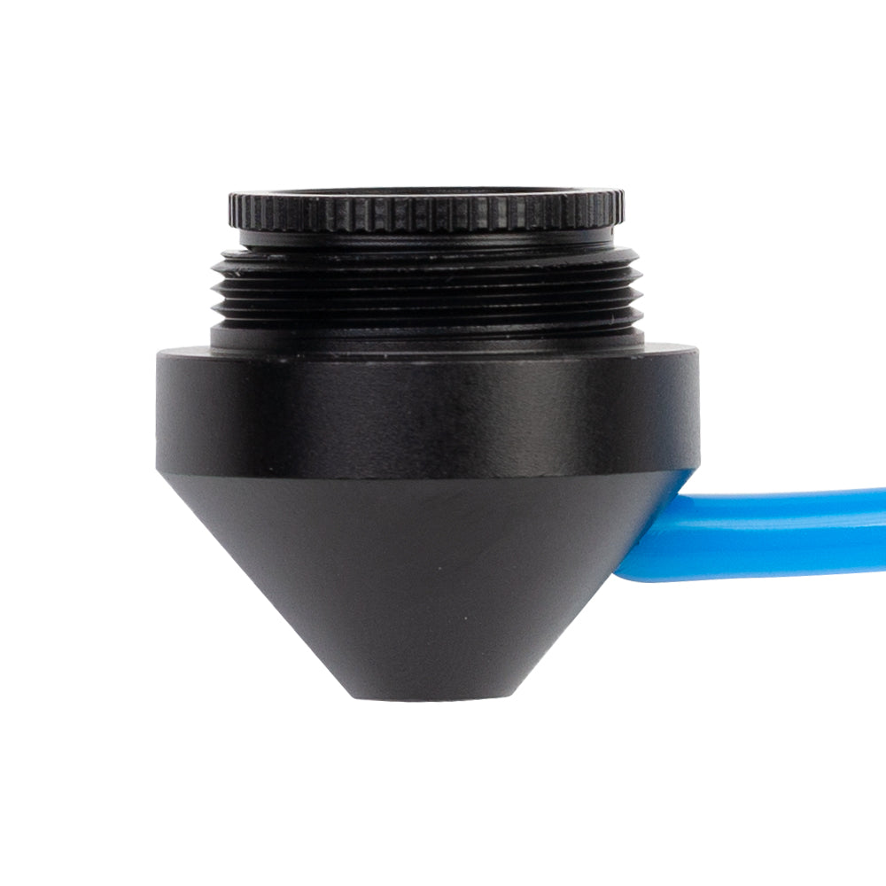

4” lens are fine except you still need to get air down into the cut. In my case I need a long nozzle which is difficult to find. My attempts to print one have now worked out. It would be interesting to see how others supply air to long lens.
<div class="post-metadata">
**Post date:** [November 22, 2023, 5:39pm UTC](https://forum.lightburnsoftware.com/t/benefits-of-a-longer-focal-length-lens/117469/7 "2023-11-22T17:39:53Z")
</div>
Like this…
 ![image](https://forum.lightburnsoftware.com/uploads/default/original/3X/4/d/4da98bffacd5af973082ecd54641e6f54c1c8e87.jpeg)
Using the tip for a cut, 4.5mm between tip, for high pressure and 17.8mm for an engraving tip for low pressure.

> [@dean448](#):
> where you got it
If you mean the nozzle, it was from Cloud Ray as is the C series lens tube.
> **[Cloudray N03 CO2 Laser Nozzles](https://www.cloudraylaser.com/products/cloudray-n03-co2-laser-nozzles)**
> N03 nozzle is used for diameter18mm focal length38.1mm Lens. Cloudray,Laser Nozzles,CO2 Laser,CO2 Mechanical Parts,Nozzles & Lens Tube,N03,Air Assistant System
> **[Cloudray N04 Universal Compound Engraving Nozzles](https://www.cloudraylaser.com/products/cloudray-n04-universal-compond-engraving-nozzles)**
> The Compound / Universal Engraving Nozzle is designed by SarbarMultimedia. If you need further info about this nozzles, please follow SarbarMultimedia's Youtube Channel: https://www.youtube.com/watch?v=ATu-7EGZGMA&t=823s Compond Engraving...
