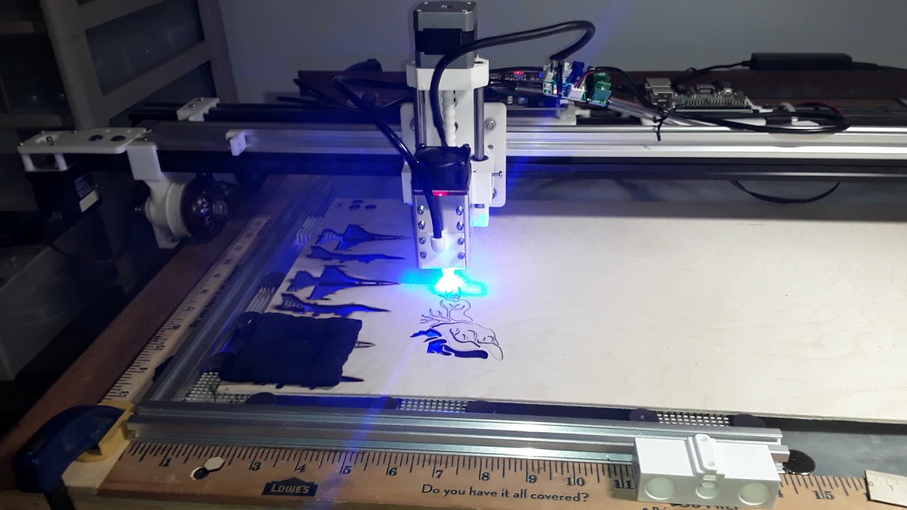

**Author:** ![dkj4linux](https://forum.lightburnsoftware.com/user_avatar/forum.lightburnsoftware.com/dkj4linux/32/5535_2.png) [@dkj4linux](https://forum.lightburnsoftware.com/u/dkj4linux)\
**Post date:** [November 30, 2021, 1:43pm UTC](https://forum.lightburnsoftware.com/t/best-parameter-for-cut-3mm-birch-plywood/52768/12 "2021-11-30T13:43:25Z")
</div>
I don’t know which laser module you are using but [here](https://forum.v1engineering.com/t/module-laser-neje-a40640-40w-good-or-not-good/29809/37?u=dkj4linux) is my air-assist setup for a Neje A40640 dual-diode ~15W (optical output) laser. Cutting 3mm birch ply at 180 mm/min, 100% power, 1 pass.
 ![20211122_114351](https://forum.lightburnsoftware.com/uploads/default/original/3X/f/2/f21337b4dd106f86f86589ac7bcba29a95c4ff08.jpeg)
 ![20211122_115153](https://forum.lightburnsoftware.com/uploads/default/original/3X/8/0/801c99a09f6fa4bf769682b6b40065be8098cc73.jpeg)
 ![20211129_105513 (1)](https://forum.lightburnsoftware.com/uploads/default/original/3X/8/8/8832806f60d94fd18074e615971f474d35adb584.jpeg)
 ![20211117_151250](https://forum.lightburnsoftware.com/uploads/default/original/3X/9/4/94455feb025e362cfa7447e8b4d99186c8ef38b8.jpeg)
In action…
[![](https://img.youtube.com/vi/KaU86DKxS1A/maxresdefault.jpg "Mostly-printed Z-axis with Neje A40640 ~15W laser module.") ](https://www.youtube.com/watch?v=KaU86DKxS1A)
Uses small aquarium compressor [similar to this](https://www.amazon.com/gp/product/B07ZG998F3/ref=ppx_yo_dt_b_asin_title_o06_s00?ie=UTF8&th=1&psc=1).
