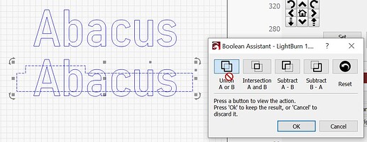

For a test I generated some sample text, and made a second copy. Using the Offset Shapes tool selecting inward and bevel to generate a smaller spline for command strips.
Result:

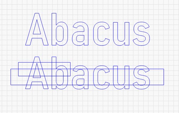

Another option:
Copy the text and draw some rectangles on top of it.
2023-02-14_11-27-05 copy text draw rectangles
Union the rectangles together:
Subtract the Union of Rectangles from the copied text:
You are left with the original text and some small pieces.
2023-02-14_11-32-57 small standoffs for command strips
You can use the offset tool to make the small pieces smaller than the original text. You can also use the Docking tool to push all the small pieces (or even the letters) together to save material.
I love the unionised rectangle option, which I will recommend to the client as an idea. Thank you John, very helpful indeed.

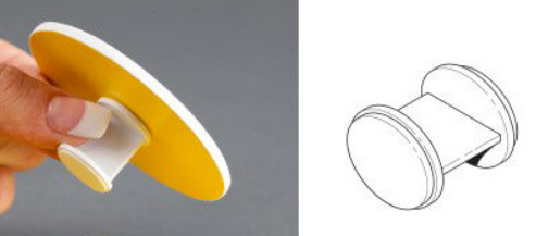

I found some great adhesive spacers online which could also work well.
Screenshot 2023-02-15 185901
However, I like the idea of the letters having more body to the tops and bottoms using the rectangle method, I think that could look great!
