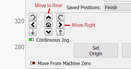

Bewegungsrichtung. (Direction of movement.)
Bei Richtungsauswahl in “Bewegen” verhält sich der Laser entgegengesetzt. Pfeil nach oben, Laser fährt runter. Pfeil nach links, Laser fährt nach rechts. Der 0 Punkt ist links unten und korrekt eingestellt. Laser ist ein atomstack a10.
When selecting a direction in “Move” mode, the laser behaves in the opposite way. Up arrow, laser moves down. Left arrow, laser moves right. The zero point is in the bottom left corner and is correctly set. The laser is an Atomstack A10.
You can correct the direction of each axis separately using the Machine Settings window (laser must be connected). The parameter to control the Jog direction is $3.
First, use the Save to File to save a copy of the GRBL parameters.

If I set parameters for X and Y direction in the input fields of “Go to position”, the laser works correct. Only if I use the arrow field the laser works in opposite direction.

Hallo Mike,
I found the mistake. In the picture in your last answer I saw that the switch of “Continuous Jog” was in ON position. That was the difference to my setting. Here it was in OFF position. If I changed from OFF to ON the laser reacts correct.
The problem is solved.
Many thanks to you for your really quick, qualified and helpfull support.
Best regards
Hemut

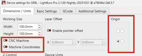

The jogging direction should be the same with and without “Continuous Jog” enabled.
I’ve seen the Jog buttons working in the opposite direction, if $J Continuous was enabled.
The solution in most cases is to make sure the Origin in the Device Settings is correct.
On the Atomstack A10, this should be bottom left.
Also, disable both “CNC Machine” and “Machine Coordinates” options. If these were enabled, it would explain the situation.

Hi Aaron,
I try to explain what I did after the last email from Mike.
  1. positioning the laser in the middle (205/200)
  2. Change the $3 X-parameter from disabled to enabled. The laser moves to the right front. I stoped it.
  3. Change the $3 X-parameter back to origin (disabled)
  4. Loading the “basic frame test.lbrn2”
  5. The lower left corner of “bread slice” was at appr. 50mm (X) and also in appr. 50mm (Y).
  6. red and green squares are at 0,0 corner. the frame I started was ok.
  7. After that I see the difference in “continuous Jog”
  8. I switched it to ON. Thes system reaction was ok for all 4 directions.
After that I switched it to OFF again. Laser reaction is ok. You are right: The jogging direction is the same with and without “Continuous Jog” enabled.
The “CNC Machine” and the “Machine Coordinates” were disabled the whole time. The situation was as shown in your picture.
I can’t explain, but after changing the ON/OFF position of “Continuous Jog” the system reacts correctly till now.
I hope the information helps you a little bit.
