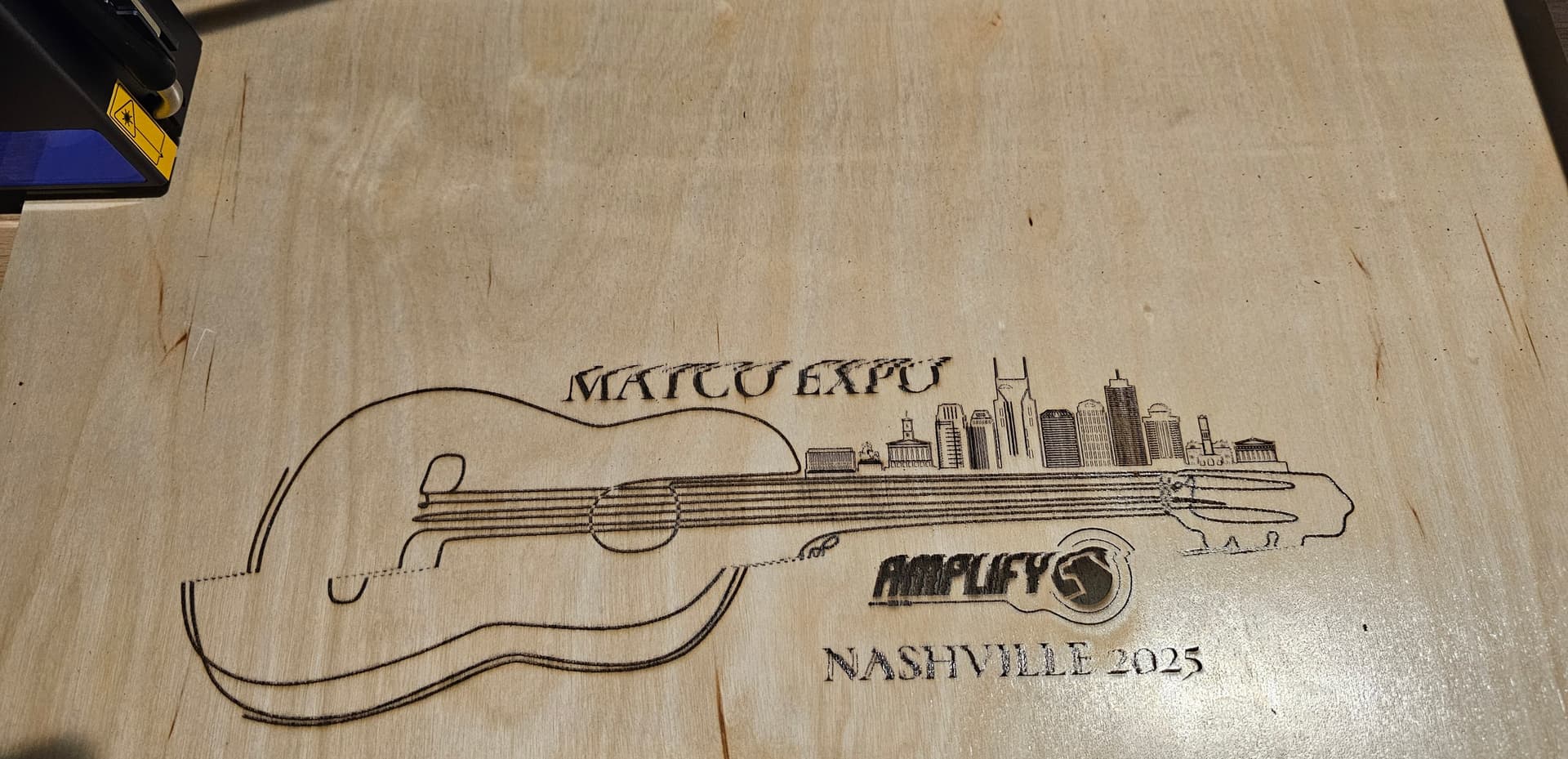

Newbie here, looking for some assistance. I just received my Acmer P2, 33W and am trying to set up for a job I am doing for work. I’m using Lightburn and I’ve attempted etching a project from an .svg file and as a jpg file. The first pic is the jpg and the second is the svg. These were just test runs so ignore the wood but in each case things went well in portions and then something caused a shift or distortion. Pic 3 is what it should look like. I appreciate any suggestions.
That is called backlash. It is caused by loose pulley or coupling set (grub) screws. Get out the Allen wrench and tighten them all. Don’t stop when you find one loose.

That’s not backlash, that’s losing steps.
Backlash is the play in the drive system. That thing is all over the place.
Did you hear a grinding noise during cutting? Was the laser head hitting anything?
I did not hear any grinding and the head was not hitting anything.
An additional problem: USB communication glitches trashing the G-Code commands moving the laser head.
These errors seem more common with higher-power lasers, due to the higher current drawn from what might be a marginal power supply.
One of the first steps is to get a USB cable with a ferrite core on each end, bought from a reputable supplier rather than the usual low-end Amazon / eBay seller of USB cables / beachware / lipstick. The USB cable packed with a new machine is typically the cheapest cable available and replacing it seems to produce more happiness than you’d think possible. :grin:
To me that looks like a physical obstruction. check you have enough slack in your air hose and cable routing …

I check all belts and pulleys and swapped out the USB cable, also checked for any obstructions to the cables and air tube. I installed Lightburn on a different computer and tried a couple of different jpg files and still was not getting good results. The strange thing is that the first engraving I did well and then each one after that got progressively worse. I’m on a timeline so I sent it back and ordered something different.

It was very likely a loose set screw on one or more shafts. That would explain why it got worse with use. It started snug and didn’t slip, but as it loosened up, the slippage got worse. I wouldn’t expect any better performance out of another machine. Manufacturing quality is sorely lacking on these machines in general.

I agree with @thelmuth and think you have something like a grub screw that’s loose. Since we don’t know which is top or bottom or X/Y, we can only speculate.
