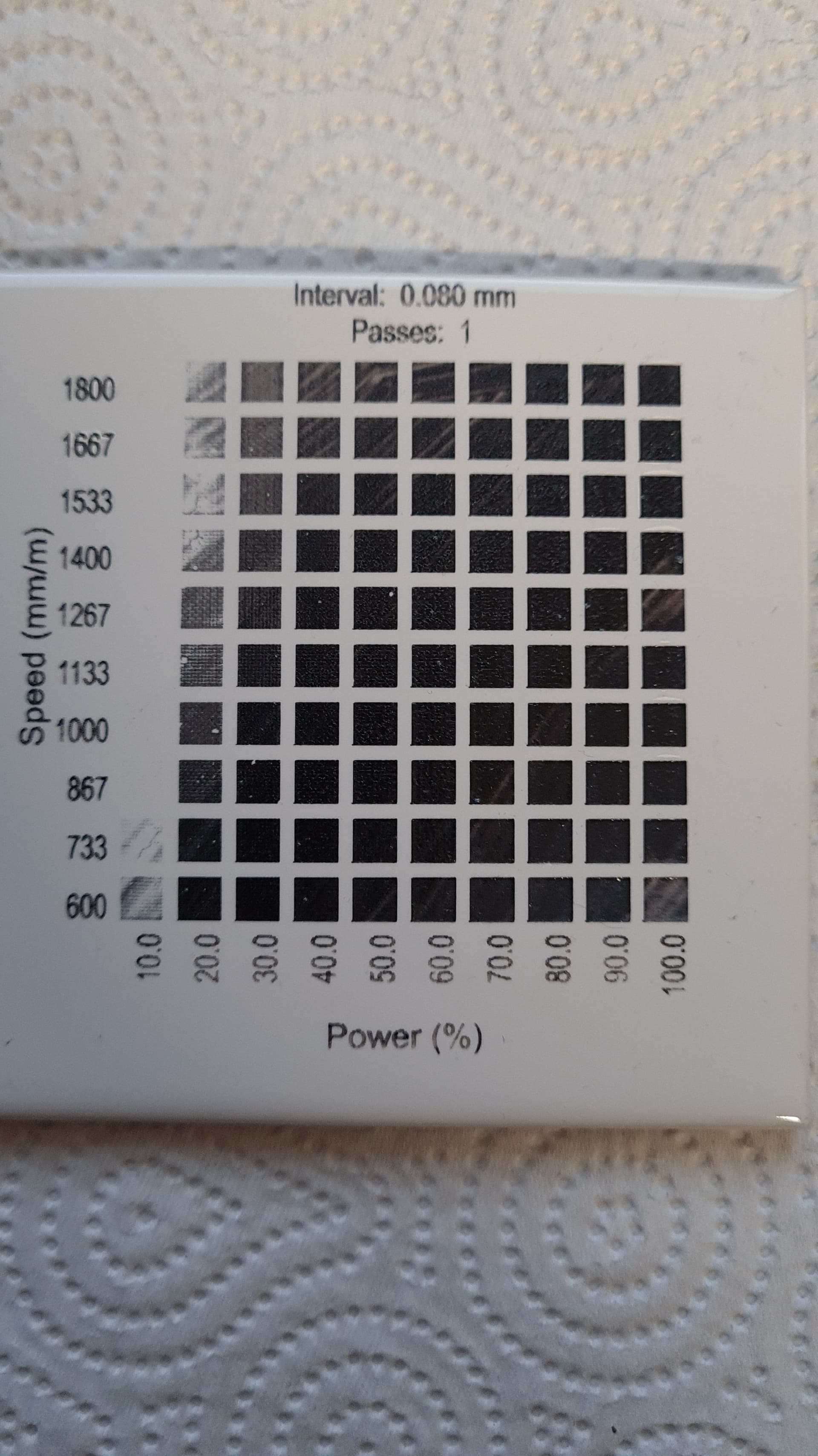

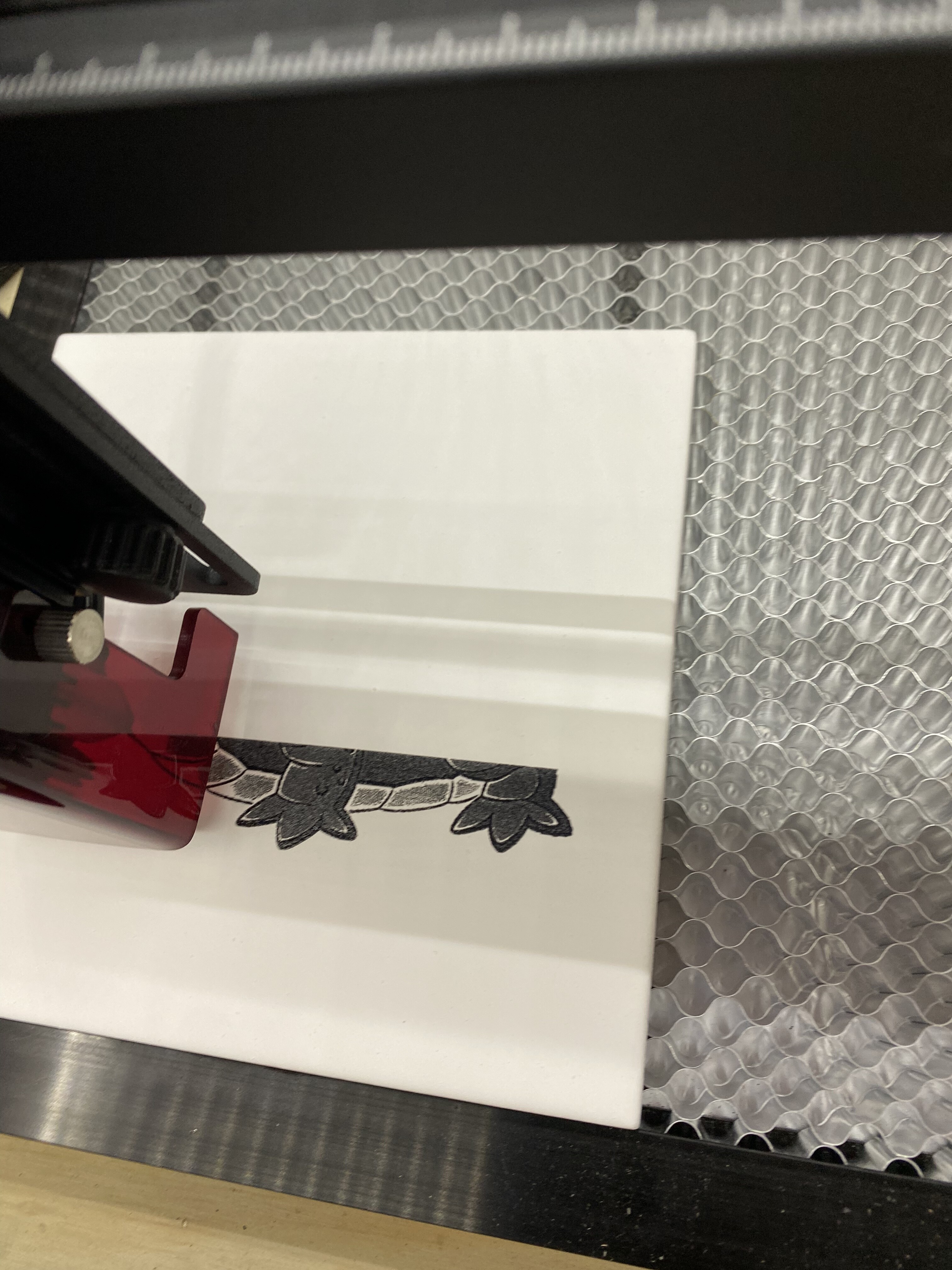

Ok, so I finally had the time to sit down and do it - trying just the paint + TiO2 first… I think I got my mixing wrong? When using a brush you can clearly see the brush marks left, I think it’s too thick? Or is that how it’s supposed to be? Should I have a nice, smooth even coat?

I thin it down with water so it is a bit thinner and flows out after 10 or 15 min sitting flat. Needs a light touch with the brush. Pretty easy to wash off if it is to thick, or to thin for that matter.
I used the recipe… perhaps I added too much Titanium. Running a material test now, I’ll try thinning it out more so the water drains off
Not so the water drains off, just enough so it flows smooth after 15 min.
Yeah, that’s what I meant, sorry.

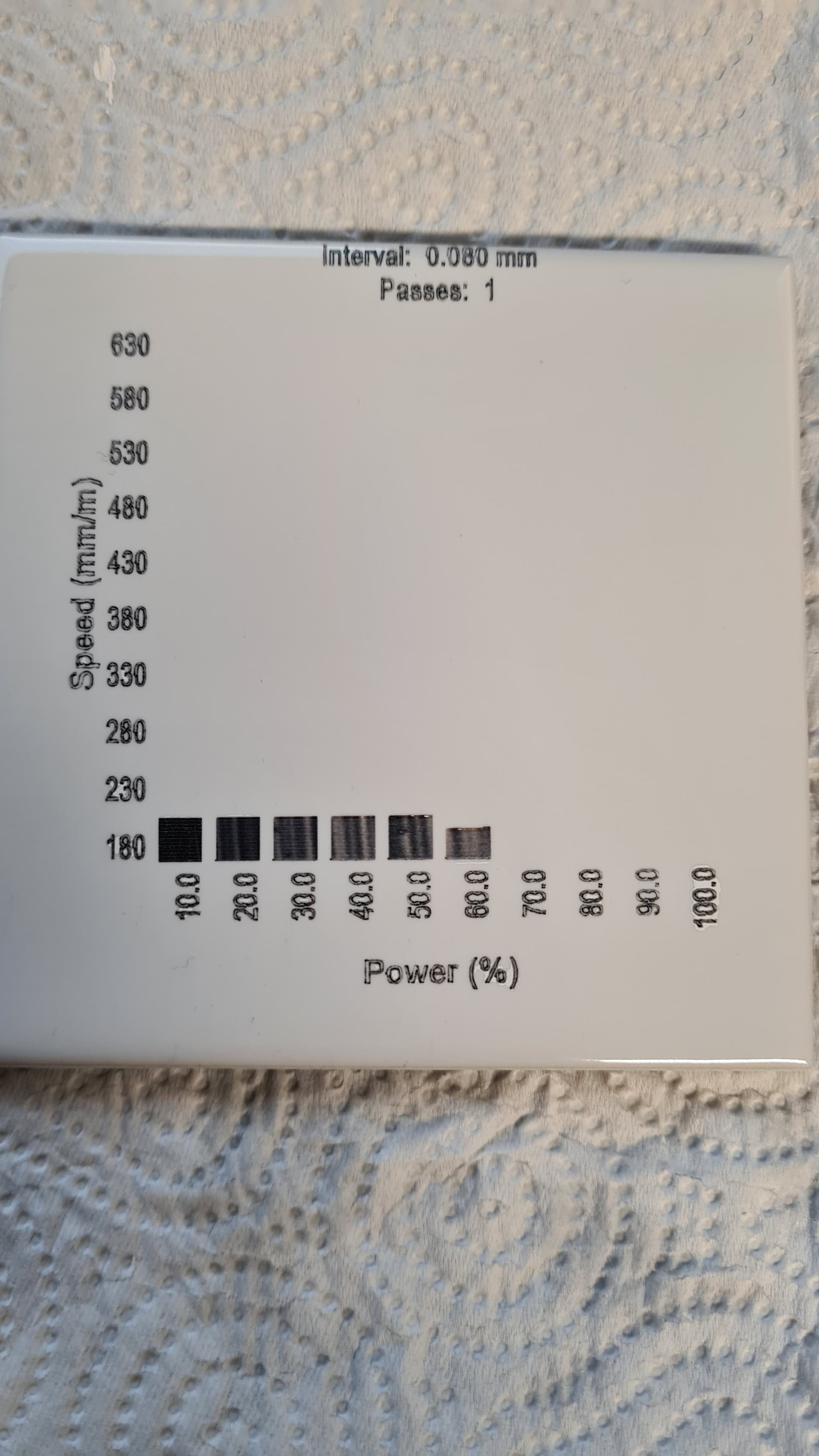

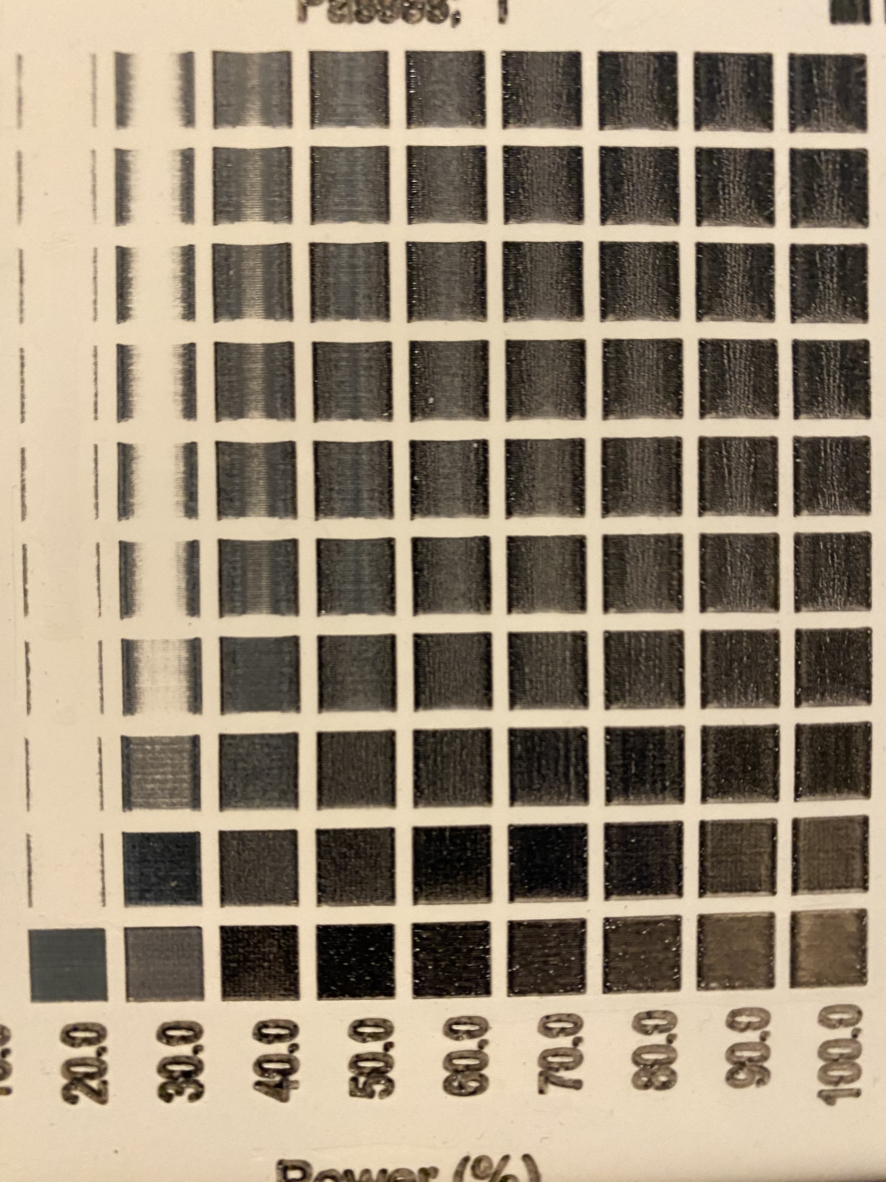

I stopped the first tile because the results were both good and bad. Clearly my testing parameters were waaaay too strong. The 60% power where I stopped it is significantly depressed in the material :smiley:
Going to run the second tile with better testing parameters

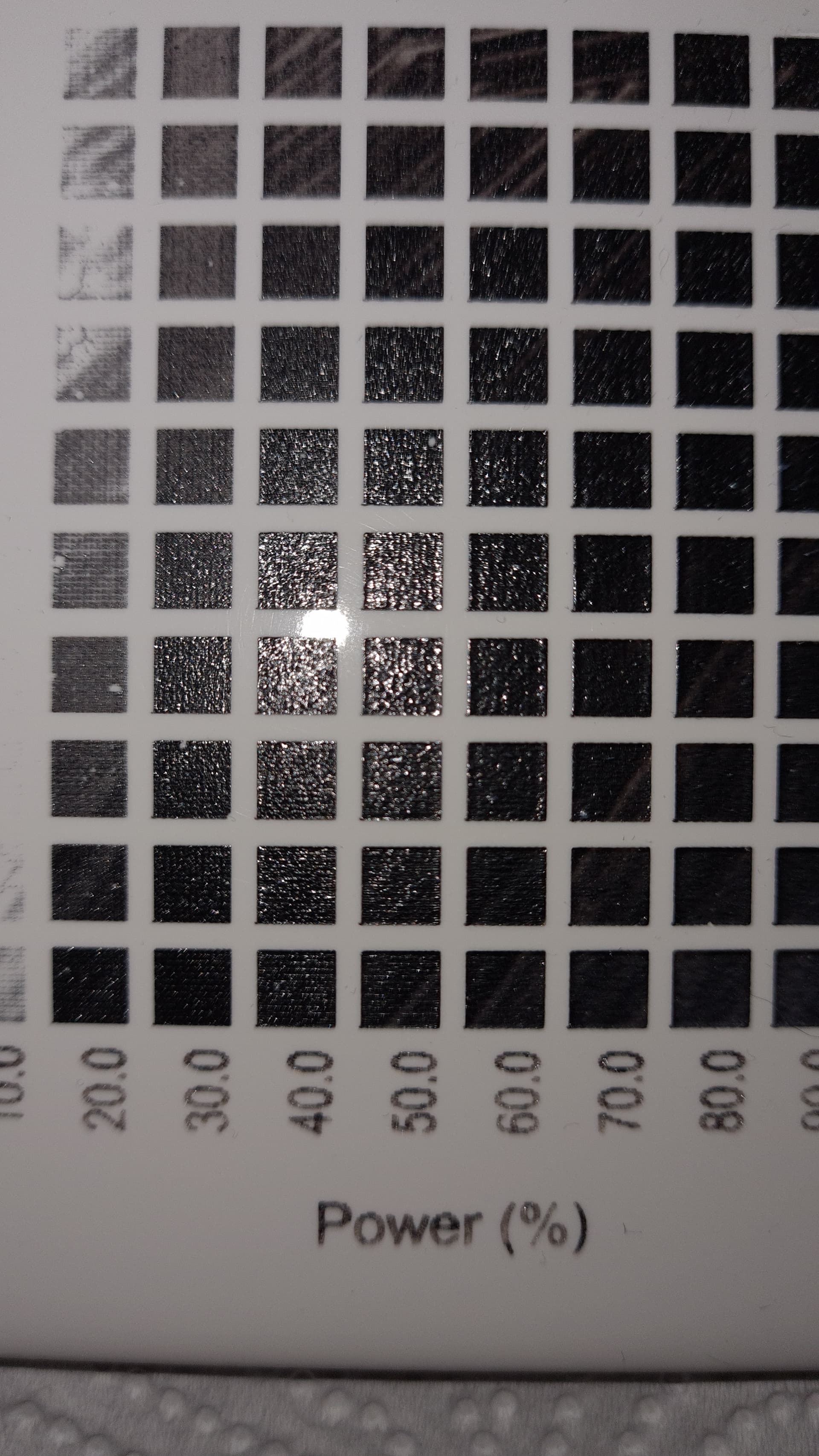

Second tile has much better results! Still a bit too much power (there’s very little gradient, it seems like. Need to run more granular tests, perhaps)
Before and after cleaning it up - I really went at it with a scrubbing sponge (and used toothpaste, that’s the gentlest scrubbing I have… I’m happy with the results!

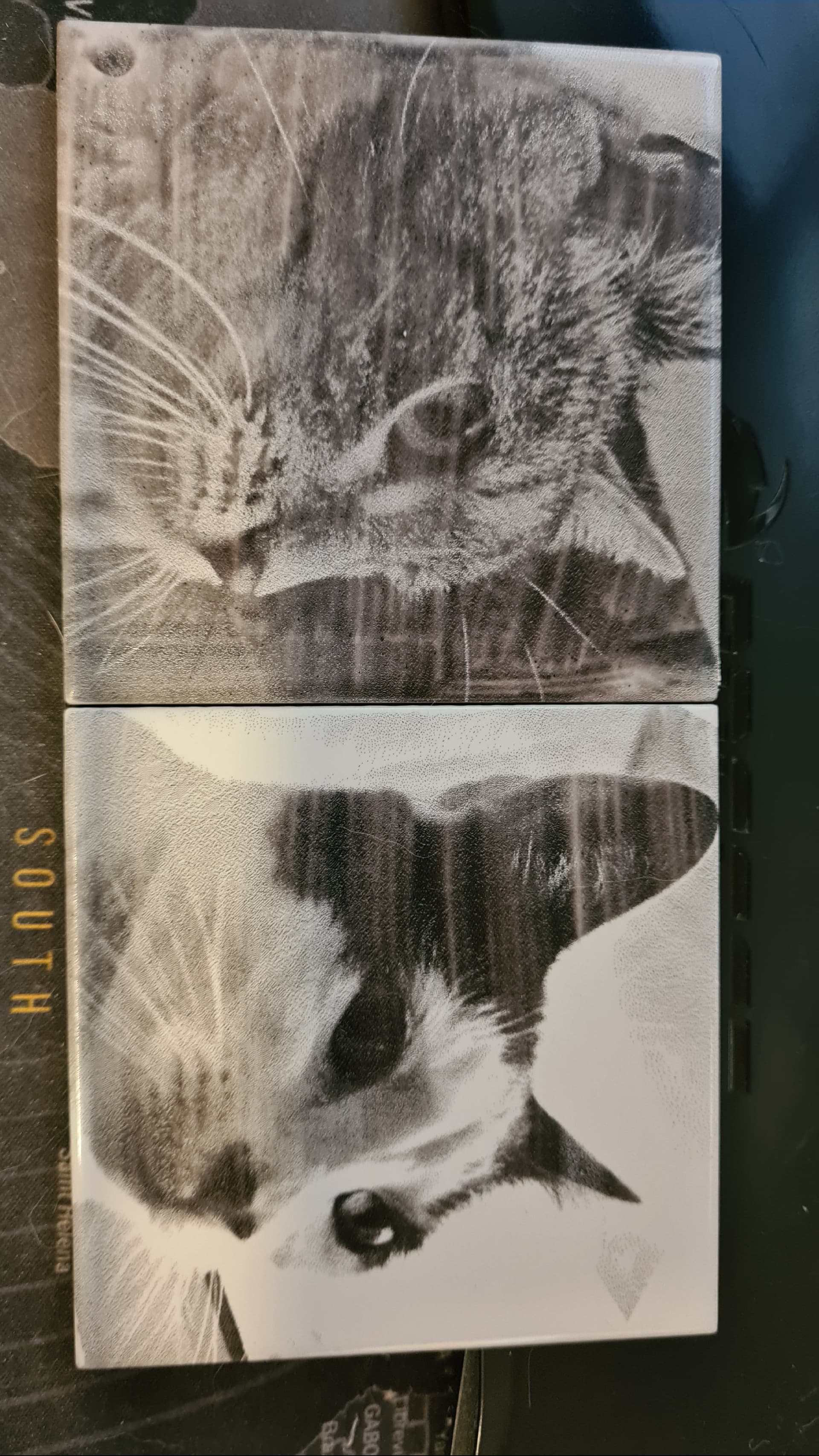

I’ve got two other tiles drying, I’m excited to dry photos and art on them!
First photos on tile! I’m happy with the quality, though you can see I didn’t have an even, smooth coating

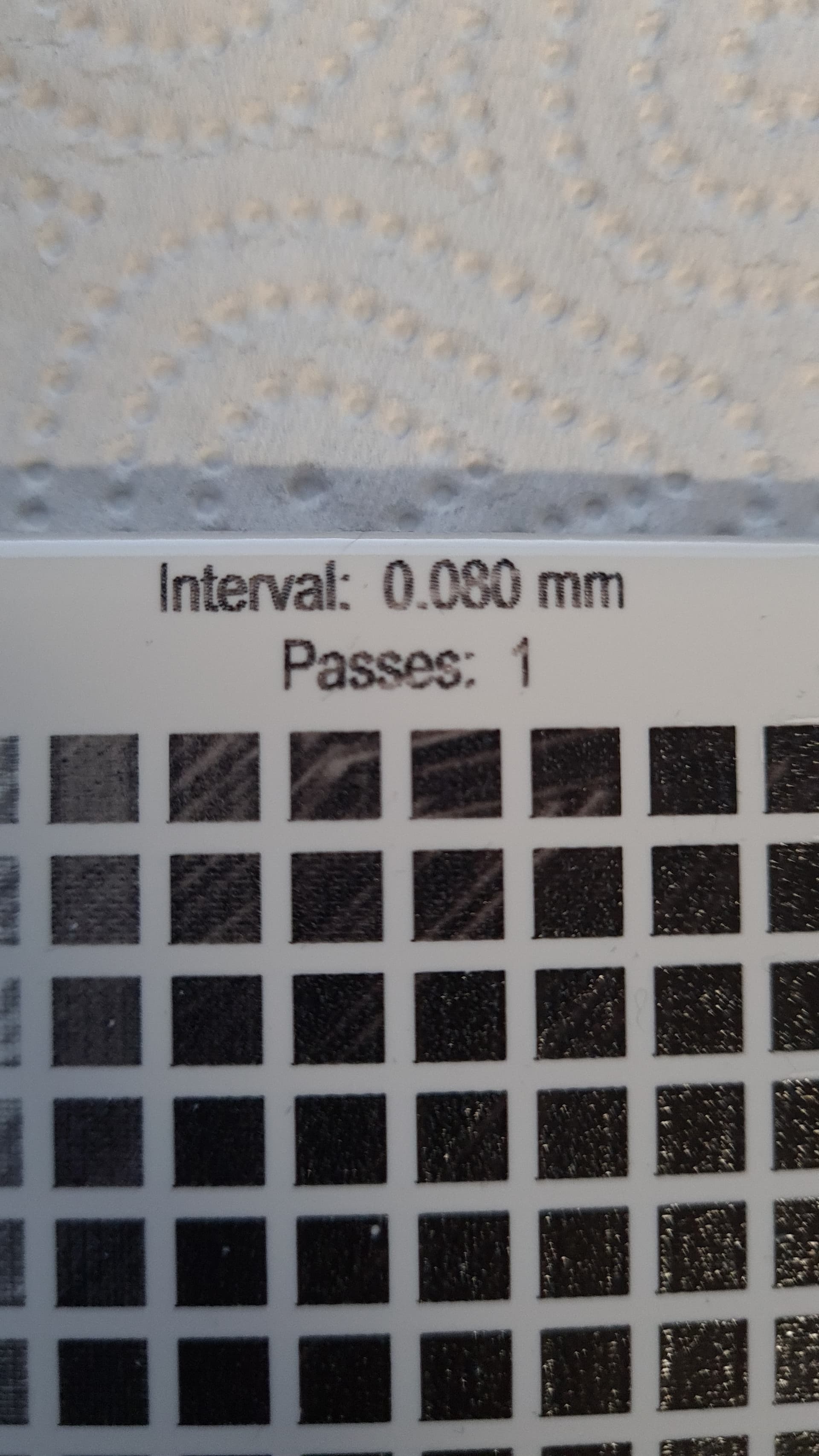

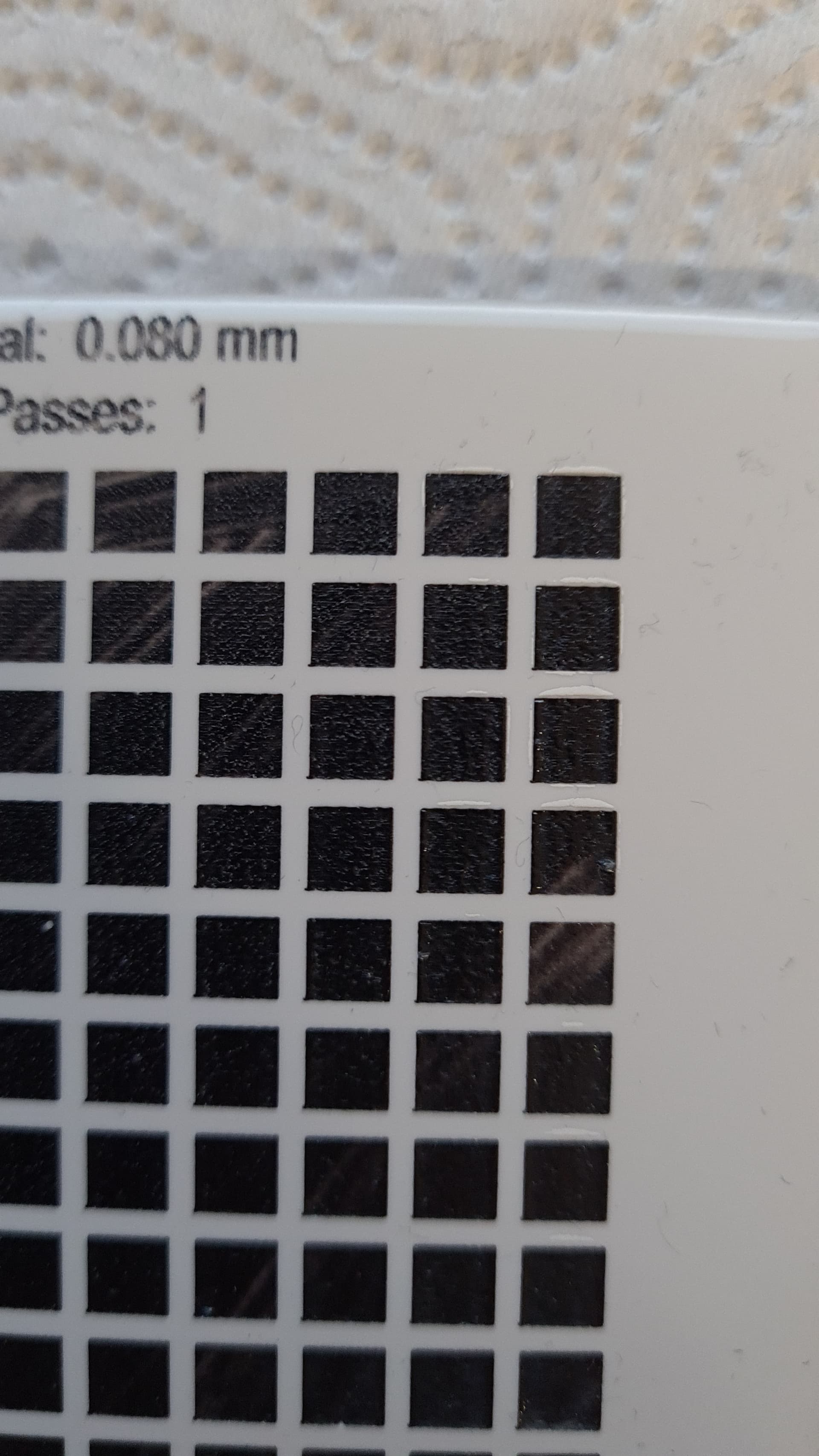

Hello, new here. I have already tried the NWT method with alcohol and TIO2, but now I would like to try this method.
I used cheap white paint, 25g Tap water and 29.25g TIO2, equivalent to 3 13g spoons (if I did it all in a small gramera)
As a result I obtained a thick mixture.
To paint I used a sponge brush. Attach picture.
Before using the laser I want to check if those lines that were left are okay or should I paint again?
I was playing with colors before, but I want to improve my blacks
Thank you all :smile:
You should add more water so it will (or should) flow out to a nice even coat. Takes a little longer to dry, but you will get better results.
