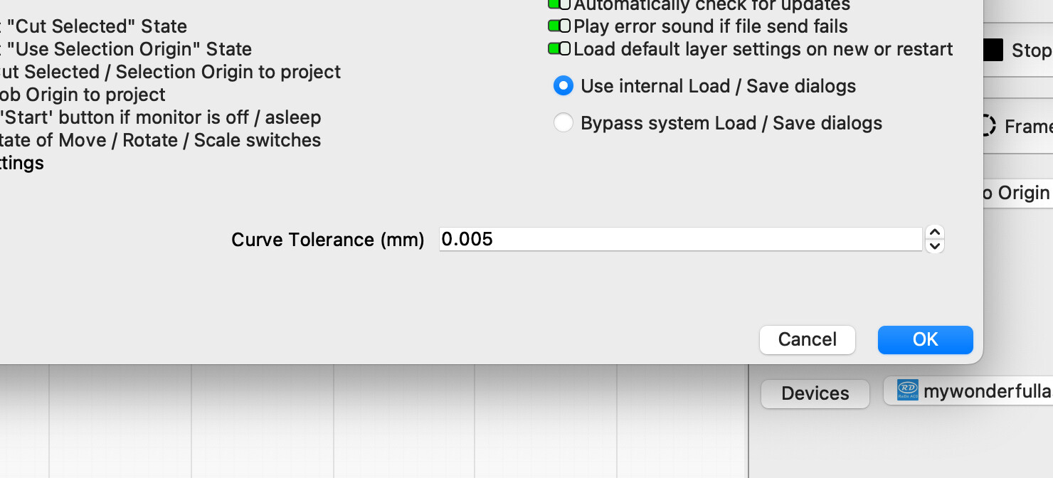

Birleştirme sırasında daireler oval olmuyor
This behavior is due to the fact that LightBurn occasionally works with approximations and tolerances. The curves that are created using the Boolean tools deviate from the originals within a tolerance value set in your LightBurn settings (FileSettingsFile Settings → you’ll find Curve Tolerance in the bottom right). The larger this value, them more “error” is allowed.
Try reducing Curve Tolerance and Welding the shapes again.
