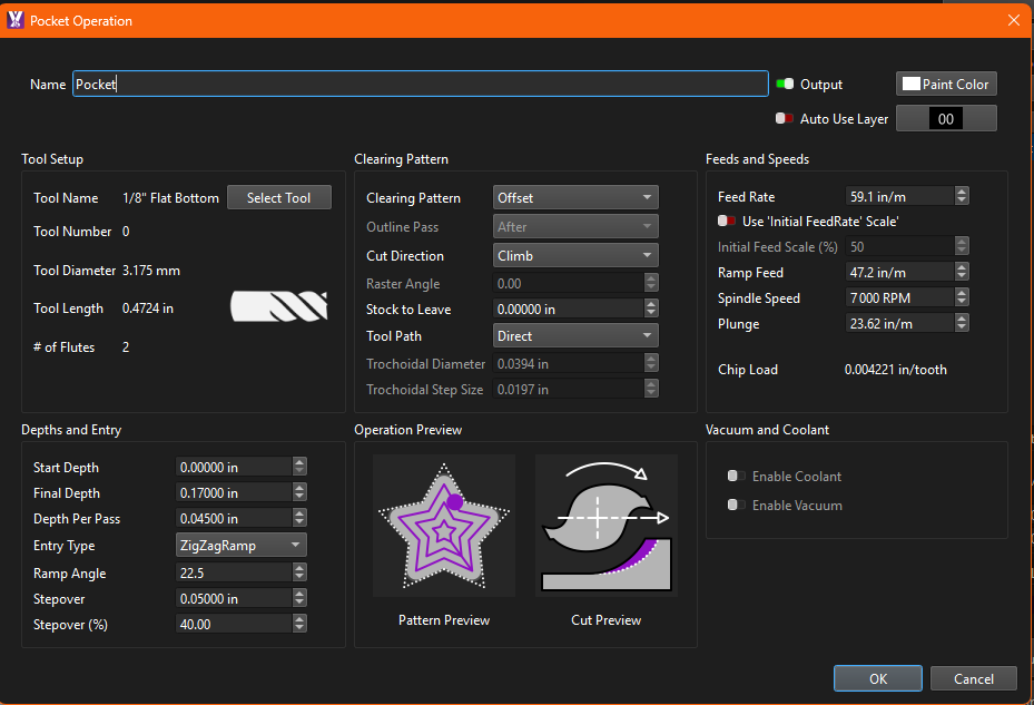

I’m new to CNC machines, so please bear with me. It is starting it correct XY position, but bit goes like 1/4" into wood. Here is what I have.
I have Probed bit on Z axis.
Set Z to 0 where bit is paper thickness from wood.
Stock Thickness (Z): 19.5 mm
Operations settings are:
Starting Depth of .00000 in
Final Depth: .17000 in
Depth Per Pass: .04500 in
Any advice on what else I can check. I must be missing something.

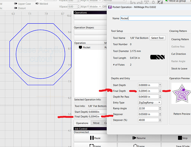

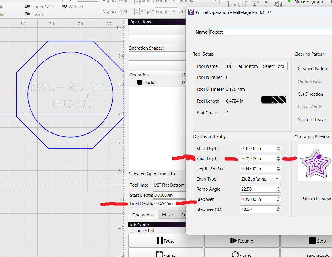

Not sure where you got your expected numbers, but they do not match your program.
Everything was set to Metric, but I do not know if it was your settings or mine. But this is what I got when switching to Imperial in both Settings and Device Settings.

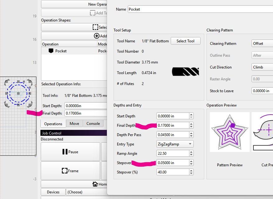

Now that is weird. With both Setting and Device Setting set to Imperial this is what I’m showing.
Looks correct on mine. This is with RC7.
