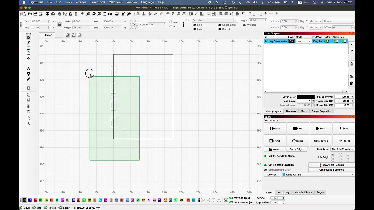

Why does Boolean only work on 2 shapes but not on groups?
Working on Tabs and Slots. I can do one at a time but not the side as a whole.
 ![image](https://forum.lightburnsoftware.com/uploads/default/original/3X/0/f/0f4207287ce5ab40355dd4d68a3631f439bd0efb.png)
It would save so much time otherwise.

If your small squares are grouped and your large shape is closed, you can use boolean operations without any problems.

If using the square tool it should be closed, yes?
Thanks for the reply, I’ll check it out.

> [@ehendrix](#):
Boolean operators only work with closed shapes.
