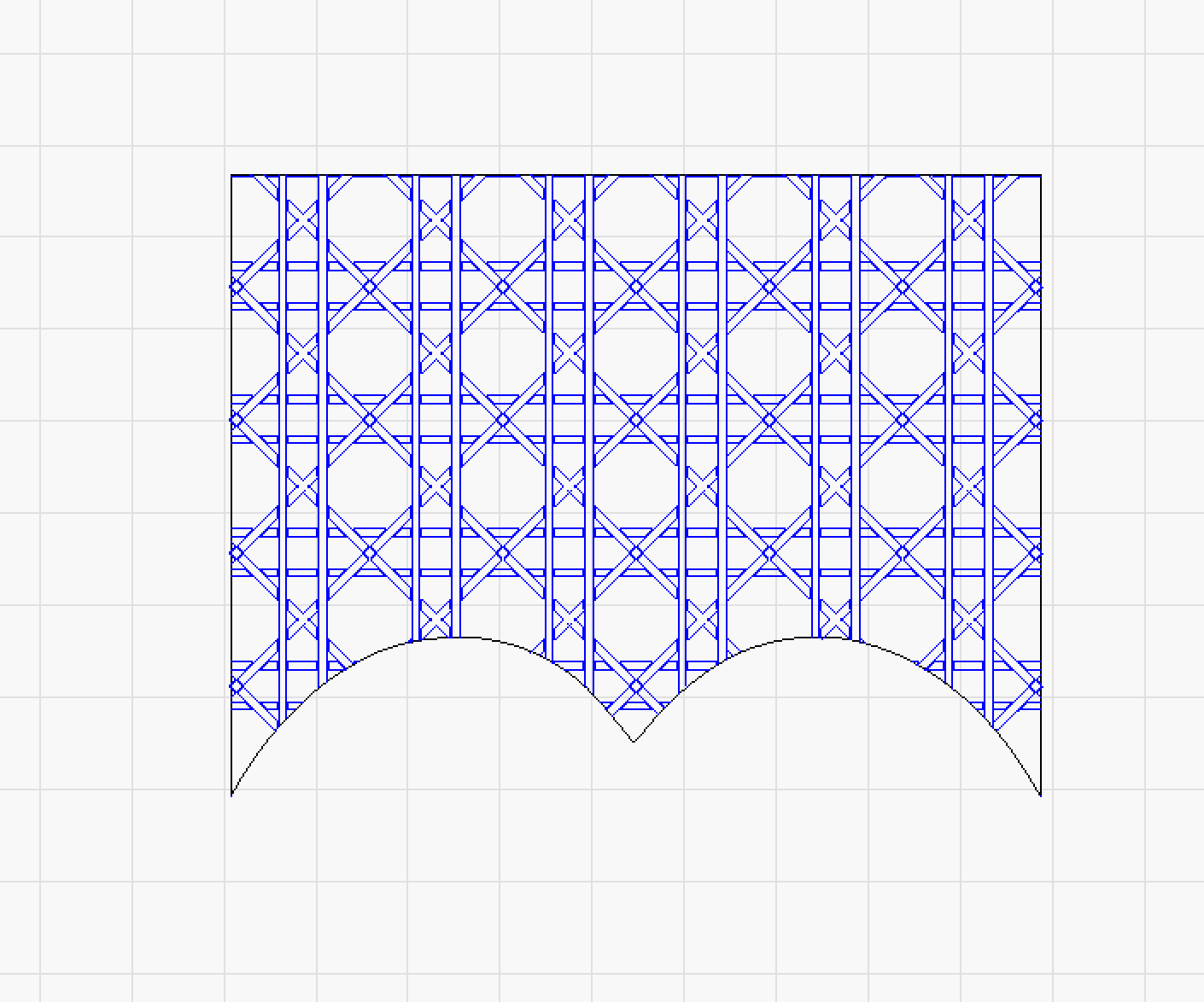

I have created a rattan weave pattern I would like to use as a fill for some empty space. It would be an etch and not a cut-out. The attached file has the rattan pattern I created and the space I’d like to fill. I’ve tried making this work and clearly I’m missing something but because of a time commitment I’m reaching out to see if it’s possible or not, and if so the steps to make it happen, short of node-editing the life out of it which wouldn’t be fun.
Image 1.lbrn2 (256.0 KB)
Anything like this?

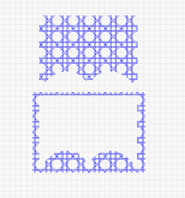

The Cut Shapes Tool is the way to go for this.
Just make sure to duplicate (CTRL/CMD + D) the outline of the space you want to fill before using it as the cutting shape, if you want to keep that outline afterward.
Yes and thank you!
