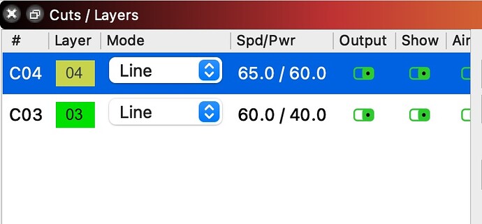

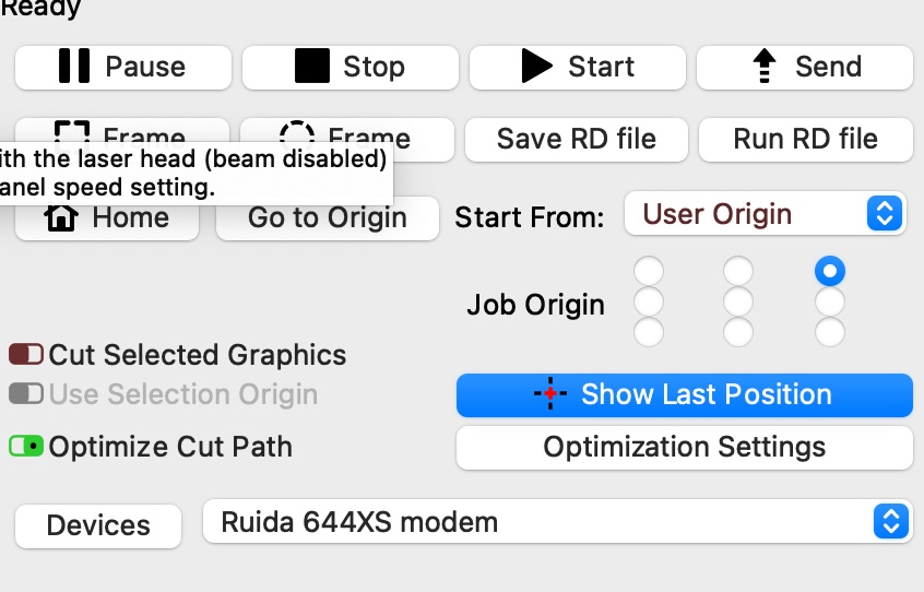

I’m using a Bridge to connect my Boss Laser 1420 to my Macbook Pro M1 running Lightburn in the latest version (diagnostics at the end of this post).
I’m thrilled that the Bridge has solved most of my vexing problems getting files to the Boss. Thank you.
I can successfully set it up and send a file. It’s a simple one with a square and a rhombus.
See attached screenshots.
The file arrives at the Boss.
The head starts moving and acting like its working. It moves around just like it’s supposed to.
Except, it doesn’t cut or leave any mark on the wood. The laser lights up and yet nothing happens.
What am I missing?
Thanks

finally got through to Boss.
they shipped a laser with a bad door switch. And the way they let you know that the door isn’t closed is by acting like the laser is broken.
