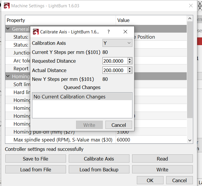

![image](https://forum.lightburnsoftware.com/uploads/default/original/3X/8/8/8899ad8f844815fa30c4d989324108fc91b8b406.png)
The calibration doesn’t show any changes, or a way to have the machine calibrate. Am I missing something here???

In the field `Actual Distance`, you indicate the measured value of the output for the indicated input `Requested Distance`. In other words, if the input design was 200 mm, what was the actual output size? Once those values are different you’ll have the opportunity to `Write` the changes back to the controller.

Make a design explicitly for testing. A long rectangle along the Y-axis. The larger the shape the less prone to measurement error.
> [@RDSawShop](#):
> I should come back to the calibration page too see if the requested distance matches the actual project distance across the Y Axis?
The calibration pages allows you to calculate and implement the necessary changes to account for the difference between the planned design dimension and the resulting actual dimension. LightBurn will use the input values to calculate a new steps/mm value which is then written to the controller.

> I made a test burn @279.4 sq. Ran it, (x, 279.9,)(Y,291.5) Thats a 12mm overage. So If I understand what your saying about the calibration, I would enter the value of 267 to compensate for the overage?
No.
In the Requested Distance field you would enter 279.4. Then in the Actual Distance you would enter 291.5. Then LightBurn will calculate and populate $101 to account for the difference. If you then run a test again the actual burned size should match the designed/requested size.

I am responding with no joy. After attempting multiple tests The output of the laser is different than what’s requested. there is no consistency, I have checked the physical machine for loose fitting parts or excessive play, double checked belt tension, all is good.
I played around with the calibration settings, nothing changes.
Nothing has worked right since the updates. I think I have to uninstall the machine and start from scratch yet again.

> [@RDSawShop](#):
This implies that something didn’t go right. There’s no scenario where a change to the steps/mm setting ($101) would not have had a direct impact on the output.
Try confirming that a change was indeed made. Run this to extract the latest GRBL configuration and please return the output:
