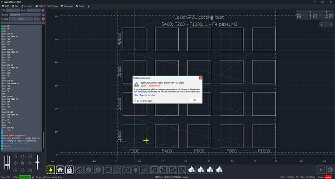

Brand New OMTech K40+ Unable to fire laser XY axis and framing no problem

Not my first rodeo but my first CO2 bronco!
I tried laserGRBL, which I haven’t touched in years. It also coughed up blood but this was the error when I tried to burn something.
Thanks!
Bob
The limit switches are detected as activated. Send the question mark command ? in the console to check which one.

<Idle|MPos:54.775,3.022|FS:0,0|Pn:Y|Te:35.85>

This shows that the Y limit switch (Pn:Y) is activated all the time. Check the cabling and make sure nothing is blocking it. If I remember correctly, the switches are inductive, so other metal can disturb the signal.

What I just discovered is that I change the point of origin from upper left to lower right as stated in the setup guide, I am able to operate without any of the errors shown above. It does appear that the water protection off is a known problem and is responsible for the laser not firing.
UPDATE: This worked for a while but now back to as before. If I place a box in the middle and move the head away from the home point in the upper left, towards the middle , then hit the frame button, the head moves to the 00 y axis and then of course errors out. Like the laser wants to move into negative and reversed mode.
