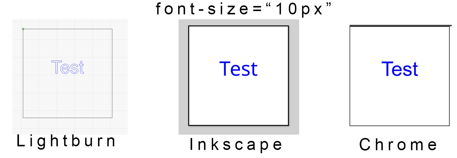

I’ve provided a sample SVG in my previous comment. You’ll get the same importing it into Lightburn (I’m using 2.0.05 which I believe is latest).
After some more investigation:
This SVG has `font-size="10px"` which renders the same in Inkscape, Lightburn and Chrome. This is also the same size text that you would get by creating text directly in Lightburn and setting it’s height to “10”.
```xml
&lt;?xml version="1.0" encoding="UTF-8"?>
&lt;svg xmlns="http://www.w3.org/2000/svg" viewBox="0 0 50 50" width="50mm" height="50mm">
  &lt;rect x="0" y="0" width="50" height="50" fill="none" stroke="black" stroke-width="0.5"/>
  &lt;text x="25" y="25" text-anchor="middle" font-size="10px" font-family="sans-serif" fill="blue">Test&lt;/text>
&lt;/svg>
 ![image](https://forum.lightburnsoftware.com/uploads/default/original/3X/5/2/521b7fb1c3b3d4126bfa176da1b292d4a93e9c3a.png)
Next up, it’s probably worth mentioning that Inkscape lies when you enter 10mm as your text height, and explicitly saves 10px in the SVG that it generates, and if you set it to 10px in the UI, it actually writes 2.64583px to the SVG (which is that same 3.7795px/mm factor again).

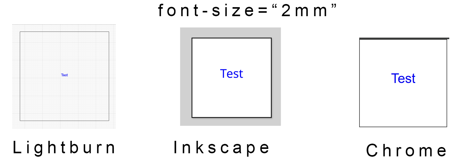

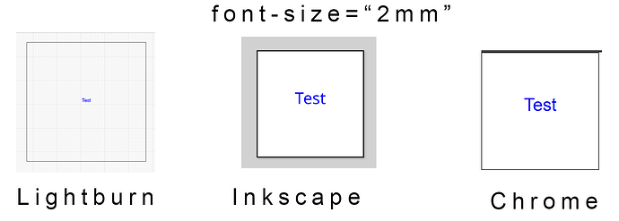

This next SVG has `font-size="2mm"` which renders the same in Inkscape and Chrome, but differently in Lightburn.
```xml
  &lt;text x="25" y="25" text-anchor="middle" font-size="2mm" font-family="sans-serif" fill="blue">Test&lt;/text>
&lt;/svg>
 ![image](https://forum.lightburnsoftware.com/uploads/default/original/3X/1/f/1f81514d0e7da4e5fc53b89f9523e7149a298a1a.png)
Firefox and Opera also match Chrome/Inkscape.
