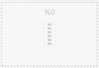

I would expect when I set “Align Y” to “Middle”. To align it in the middle.
Whatever I change Align to, it stays the same.
 ![screenshot_2024-06-10-175727.994](https://forum.lightburnsoftware.com/uploads/default/original/3X/2/a/2a5a220789d210f84d6529bc7ac2c32cd74cc547.png)
While pressing test (Current = 0)
 ![screenshot_2024-06-10-175739.059](https://forum.lightburnsoftware.com/uploads/default/original/3X/1/8/18b66d1b641a81f37f029091e1d63466e1cff36b.png)
While pressing test (Current = 1)
 ![screenshot_2024-06-10-175732.043](https://forum.lightburnsoftware.com/uploads/default/original/3X/e/3/e35d0f408c2c165f0296aeaf4c5a0bda73e900b8.png)

Hi
could you please upload your LBRN file?
Also on %1 do you have any max width set on shape properties?

max width is the default: 0.000

multiple reasons:
- a hacked way to get vertical text
- unknown length
I don’t know the length of the vertical array.
Sometimes it can be 3, other times 7. This will result in a similar bug which doesn’t align middle.
 ![screenshot_2024-06-10-185311.441](https://forum.lightburnsoftware.com/uploads/default/original/3X/a/a/aa3d2bc4dcd49d721c18260d1580d74c1adc8112.png)
 ![screenshot_2024-06-10-185313.599](https://forum.lightburnsoftware.com/uploads/default/original/3X/3/4/34532c34e6fe1b51b1be56d83cb4e8113d01df9c.png)
 ![screenshot_2024-06-10-185317.876](https://forum.lightburnsoftware.com/uploads/default/original/3X/1/c/1c71626ab6cfbc5b0b7ba84698b47a368e795e6a.png)
[align\_lightburn\_multiple\_values.csv](https://forum.lightburnsoftware.com/uploads/short-url/1frPcthAg4Nzr6HBRrL8dpJQ2bY.csv) (32 Bytes)
[align\_lightburn\_multiple\_values.lbrn2](https://forum.lightburnsoftware.com/uploads/short-url/eok6234b7cq0AAGLdbZx5QLST2E.lbrn2) (41.9 KB)

I see what you mean.
Investigating
