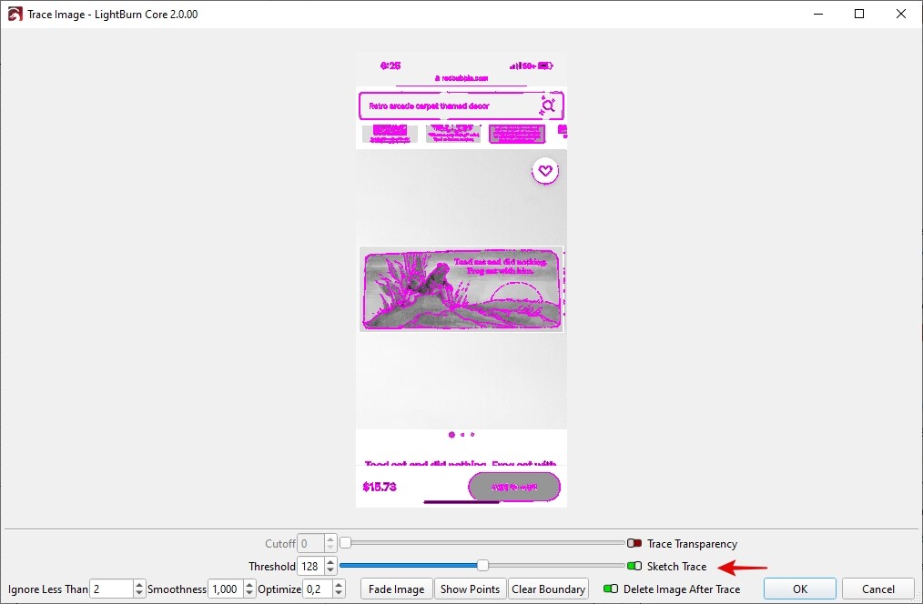

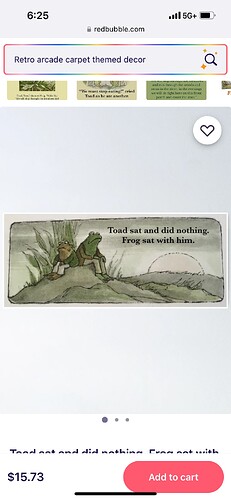

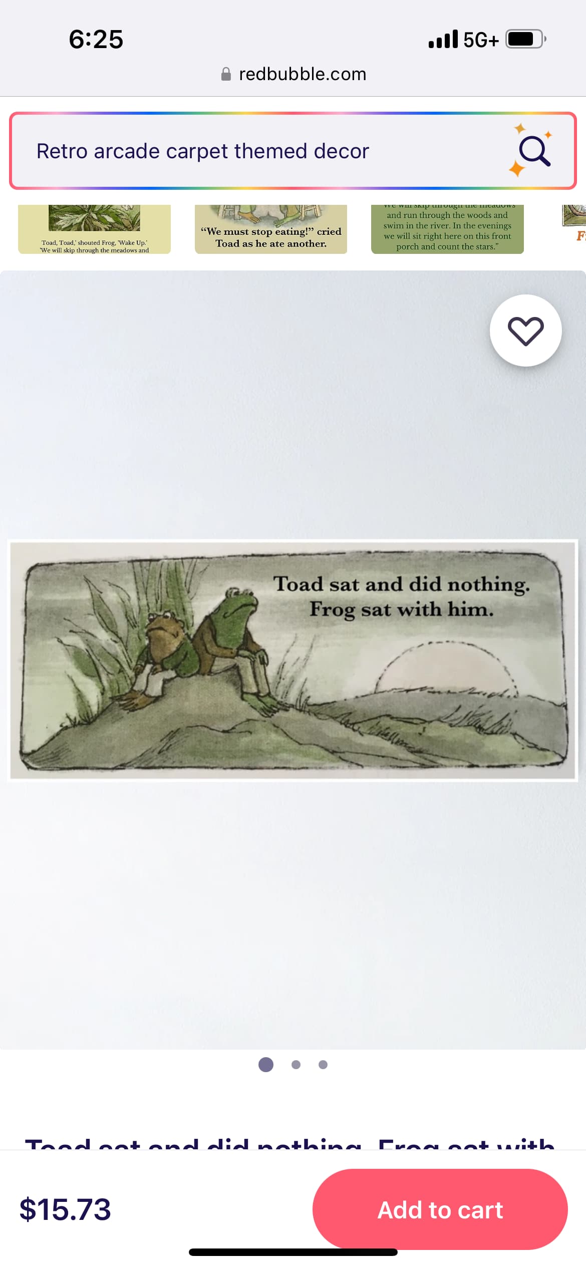

Good evening!! How would I be able get an outline of this picture to burn this picture onto a piece of wood?? I’m using an Ortur Laser Master 2
Copy the picture
Import the picture into Lightburn
Right click on the picture
Select TRACE
Press OK
The photo is of very poor quality and there are a lot of different colors or shade. This won’t nicely trace.
Can you get a better image?
It’s doesn’t really trace that neatly. There are a lot of breaks in the lines
I’ve been looking online and that’s the best I can’t get. When I trace it through Lightburn it comes out with a lot of broken lines
That is because the image has poor contrast between the light and dark areas.
My solution was to buy a tracing light pad and vellum paper. Throw in a fine tip felt pen and a reasonable time tracing and you might get something acceptable.
Using “Sketch Trace” do not make miracles but could help.
The best solution, would be a better quality picture as mentioned before.
