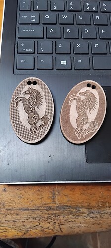

Thanks for that Danny
“You want to Fill, right?
Just put the circle and star on the same layer and select both at once.”
I was practicing skills, but couldnt figure why it wasnt filling in the correct area…read your words and the penny dropped!
Thanks LB’ers.
