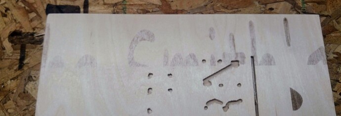

One picture is the xy zero the other one is what is going on. Sorry it’s so light but look at the top left and you can see the “T” where it is burning into the chip board. At the upper right you can see the start of the “S”. Like I said this is on a piece of 12"x12"x1/4" plywood. The letters are are way bigger then called in the design. I think! :))

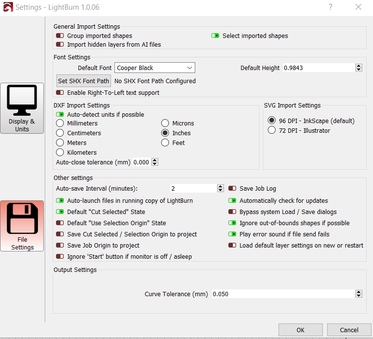

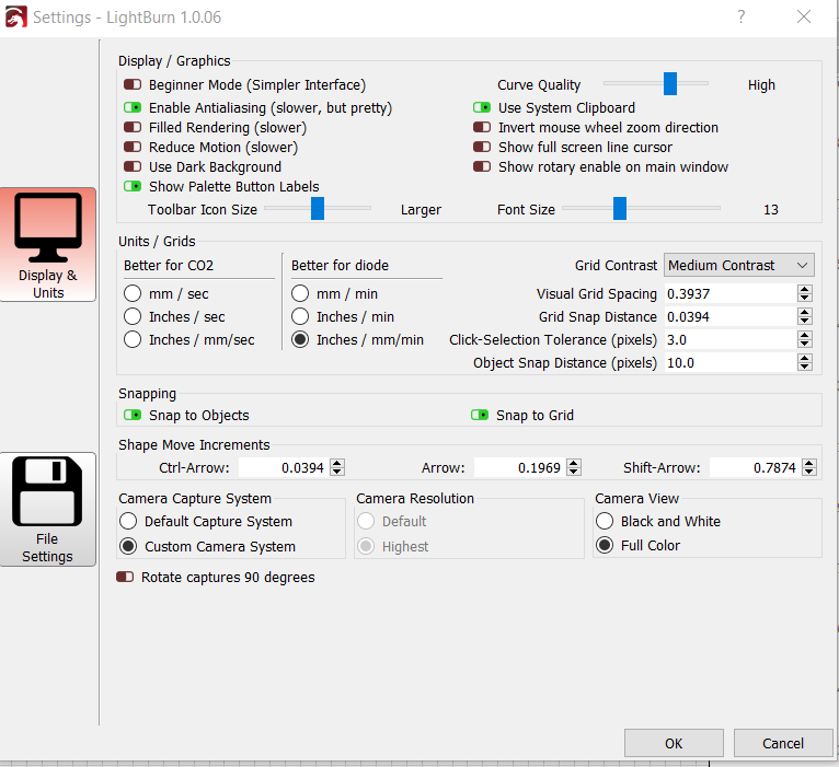

That could affect your understanding of the actual size if the DPI settings were different. First thing to confirm is what dimensions were understood within LightBurn to see if it matches the burn dimensions.

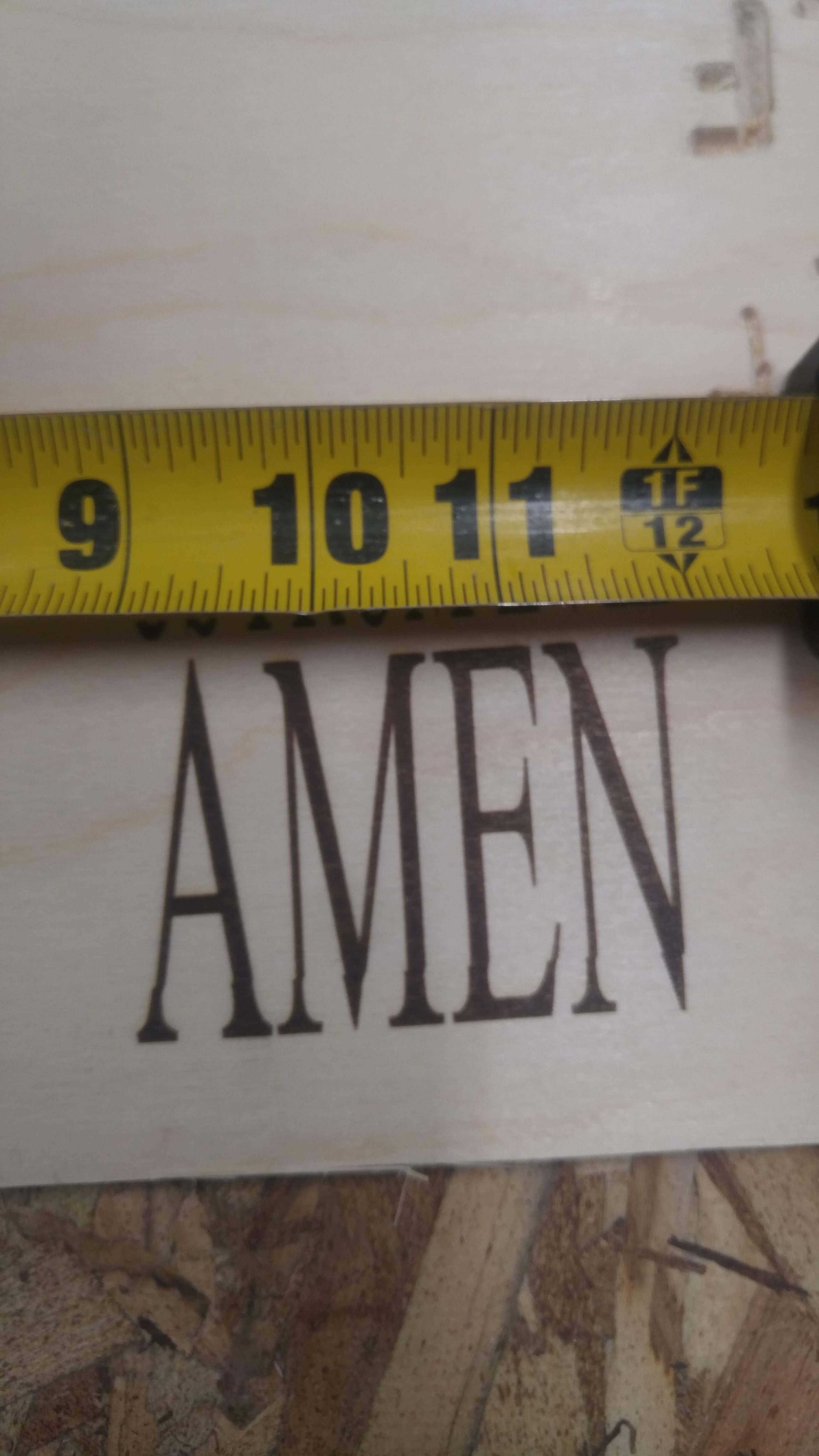

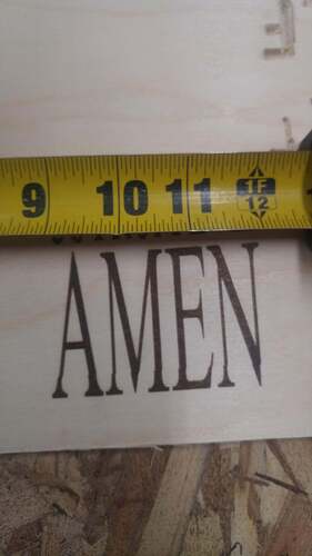

Here is new data. As you can see the letters and word are much bigger that what the file says what they should be.

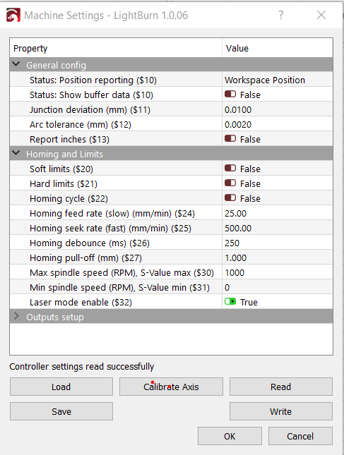

can you do a simple test?
thake a ruler, place the 0 of the ruler near the laser head, move the laser head, with LB move panel, by 50 mm or inches in X or Y, as you like, then look at the ruler and tell us if the distance is correct.
$13 is ‘feedback units’ - Sets position feedback units from mm to inches. $13=1 for inches or $13=0 for mm
Your machine still isn’t configured properly. But most of the ‘checking’ is turned off… May be standard for your machine…

Roberto,
I set the laser to move 4" and in actually moved 5 1/4".
@Jayhawk714 ok in LB in machine settings there is a button called “calibrate axis”, go there and tell me if there in something you don’t understand
I do not see the “calibrate axis”.
not there, in “machine settings”
Sorry about that! :stuck_out_tongue_winking_eye: I take it I input the measurements that I gave you for the x axis and then measure the y axis and put those in?

just one thing… pay attention cause in firmware setting we talk about step/mm, not step/inc, so watch out for the measures you take :wink:
I suggest you take a backup of your configuration if you haven’t already done so.
