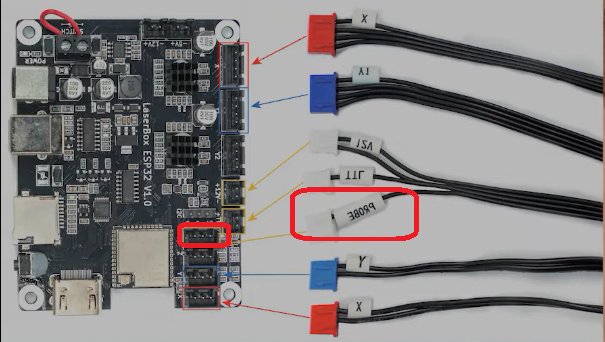

Ok… this is the board

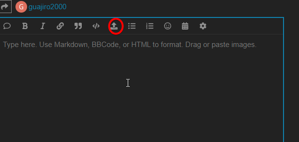

Open picture in your pc, use snipping tool to take a screenshot to your clipboard, then Ctrl + V here (or right click > paste)
Or use the upload featuer in the tool box above
ok. thank’s … do it
This is the motherboard that I have to replace but the new one does not have a connection for the PROBE cable.
I don’t know if it is essential in the machine or not since I don’t know what function it fulfills.

Probably just a universal board for laser and CNC, which is used to set Z to surface of project.
is odd is in the bundle of wires that take PWM and 24v though
So i am assuming it goes stright into the laser module

The manufacturer on their website says that it is a “flame detector” but I am not sure.
Best to write to them asking details on how to swap boards then just in case.
They can be used for various purposes.
Only guessing, but it’s probably the same cable used for the auto focus on the L2 and either packed by accident or “not used” on the P series but included because it’s cheaper/easier than managing multiple SKUs

I transcribe the response from the ATEZR technical service so that other colleagues know and do not have the same doubt, thank you all:
Dear valued customer,
Thanks for your message.
My pleasure to serve for you.
As mentioned in our previous email, this section was originally a gyroscope on the laser. And currently, this feature has been cancelled. So this doesn’t work anymore
