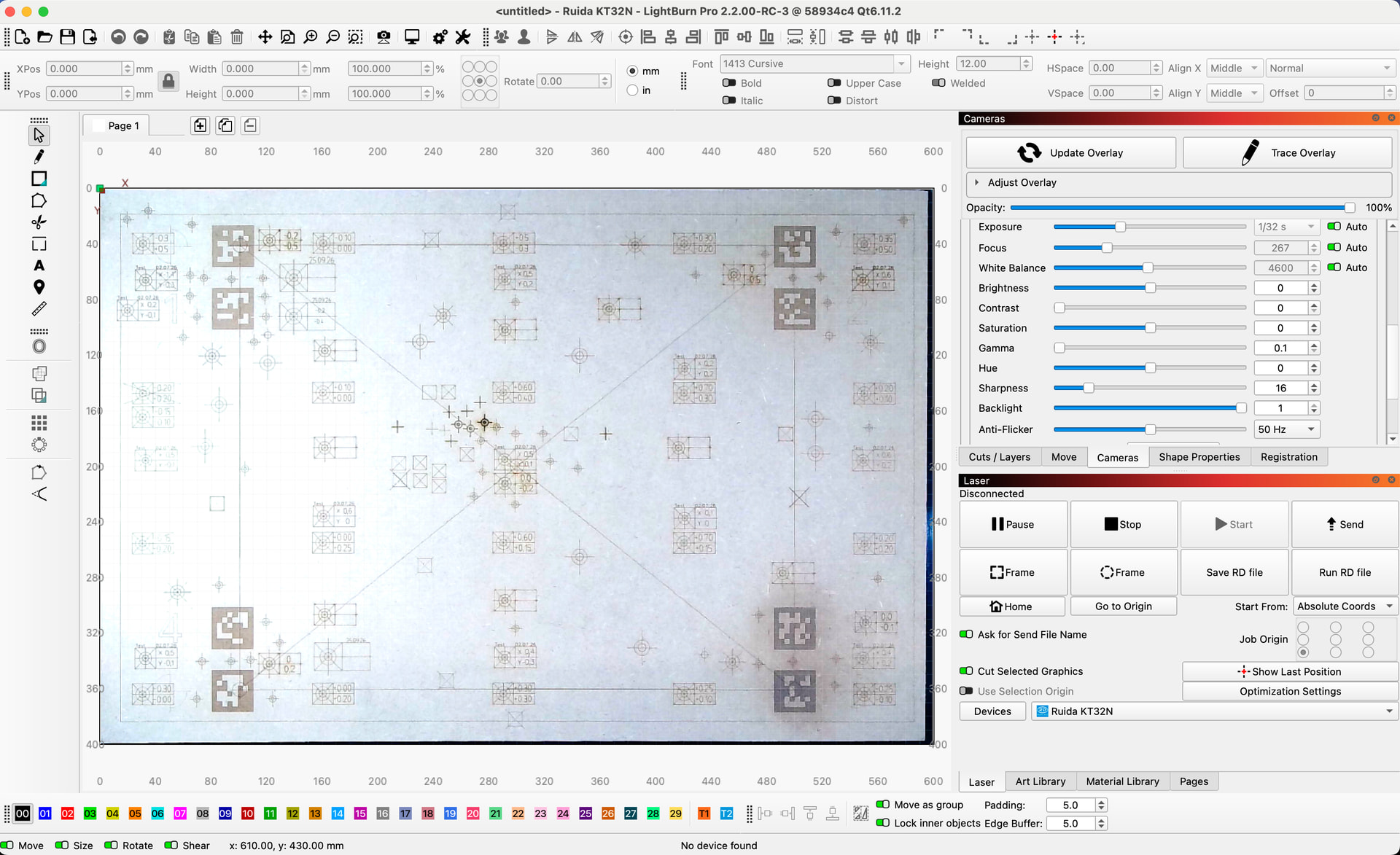

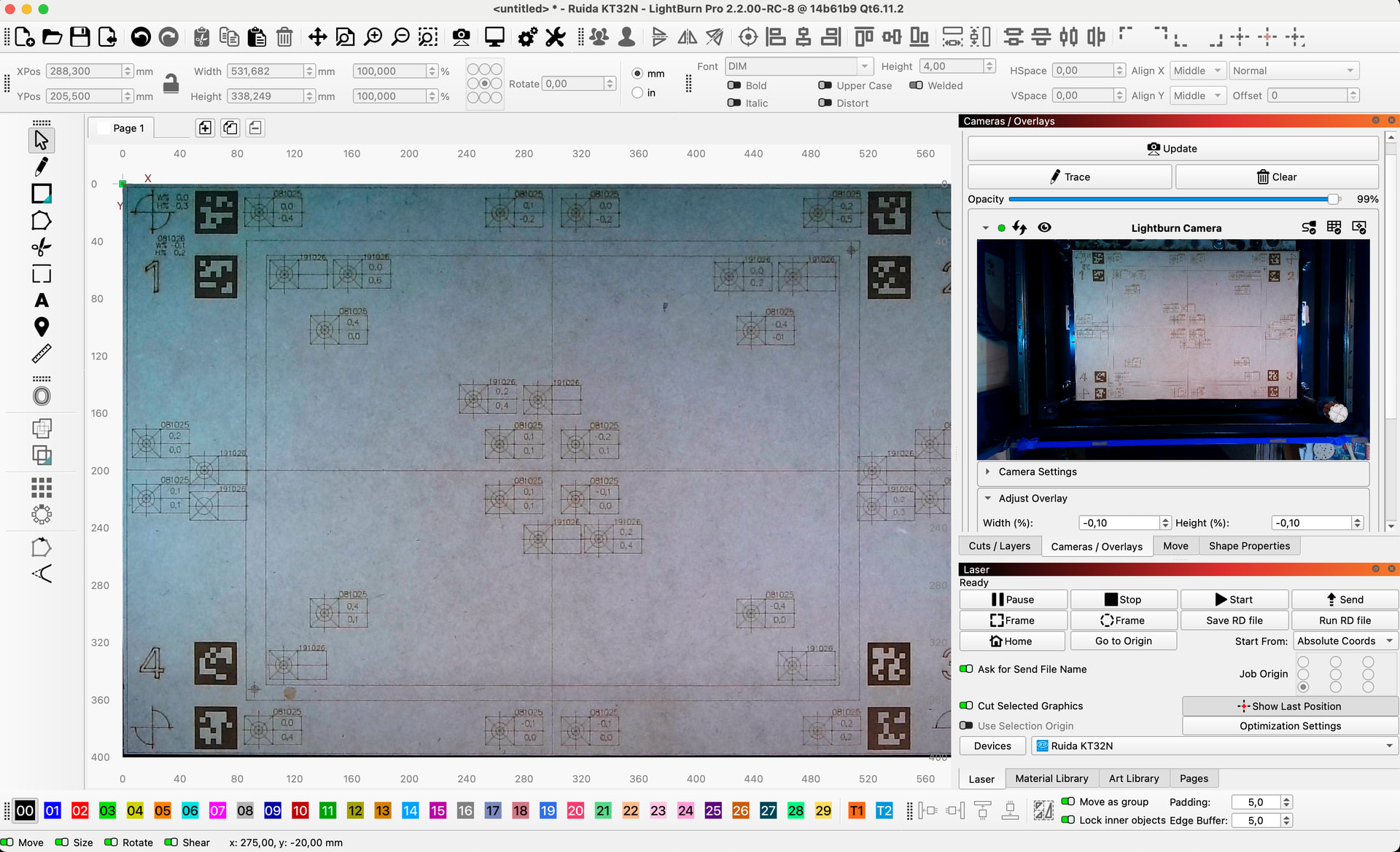

 ![Skærmbillede 2026-10-05 kl. 17.23.13](https://forum.lightburnsoftware.com/uploads/default/original/3X/f/c/fc4f9a3a77470d7400ca5db1be61641d8507a616.jpeg)
I check and fine-tune my calibrations in different ways. First I determine and correct for barrel distortion, if necessary. I do this by engraving the largest possible frame, refreshing the camera image and measuring the deviation from the center of the four sides. If this deviation is even, it can be compensated with width and height % settings.
Then I have a template that I engrave distributed over my entire laser bed area and measure the deviations and note them down. Finally, if none of the values ​​are above 0.5mm I make an average calculation of all deviations for X and for Y and use the result for my “basic fine-tuning”

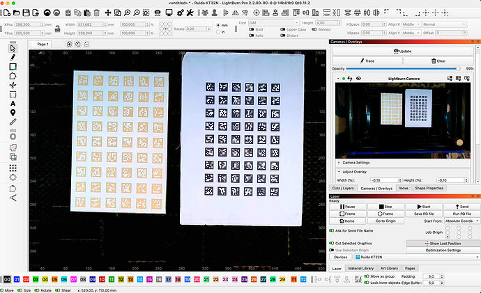

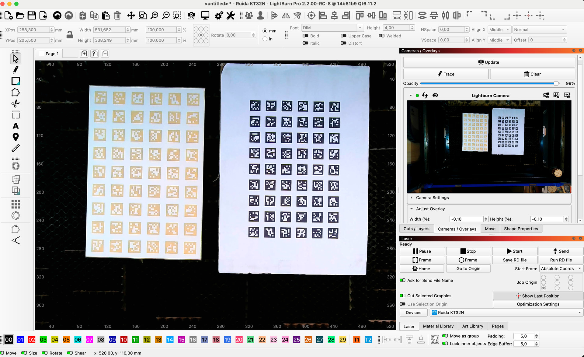

I have printed AprilTags on paper and glued it on cardboard in 2 different sizes (only to test/find the best) and I have engraved it in an ABS-like material (I actually think it is more a kind of modified PC that is used for panel protection) which has a reddish appearance but is very well recognized by LB and which I use as my “standard”.
 ![Skærmbillede 2026-10-19 kl. 11.52.25](https://forum.lightburnsoftware.com/uploads/default/original/3X/0/8/08300bd5d8aef85a09dac3688332c5c4f1dc769b.jpeg)
For workplace alignment I use MDF boards, works well here.
 ![Skærmbillede 2026-10-19 kl. 11.55.33](https://forum.lightburnsoftware.com/uploads/default/original/3X/3/b/3b5484725a2df6647c1f5e2cd9e3ac8c0f075b55.jpeg)

Regarding your questions, I can only comment on my own LB camera, it has a certain optical bias and unfortunately it is (always) also unevenly distributed.
I don’t know what influence it has, but I calibrate over my entire workspace, all the way to all edges and corners and with different angles. Typically I do about 15+ calibration positions.
I do the same with workplace alignment, but with a perfectly flat target plate. Again with the largest possible distance.
To determine and adjust the deviations, I do the tests that I show/describe a little higher up in this thread. The deviation should (for me) not exceed 0.5mm on the entire area. I typically use a minimum of 9 reference measurements and calculate an average for general use.
I have the largest deviations in the center and BR.
If I need to use a camera for a task that takes up about a quarter of my work surface, and I want extra high precision, I determine the specific area separately, i.e. I test and calculate/adjust the deviation only for this area. But it is very rarely necessary, with a little clever design 😉 I can easily “compensate” for 0.2mm.
