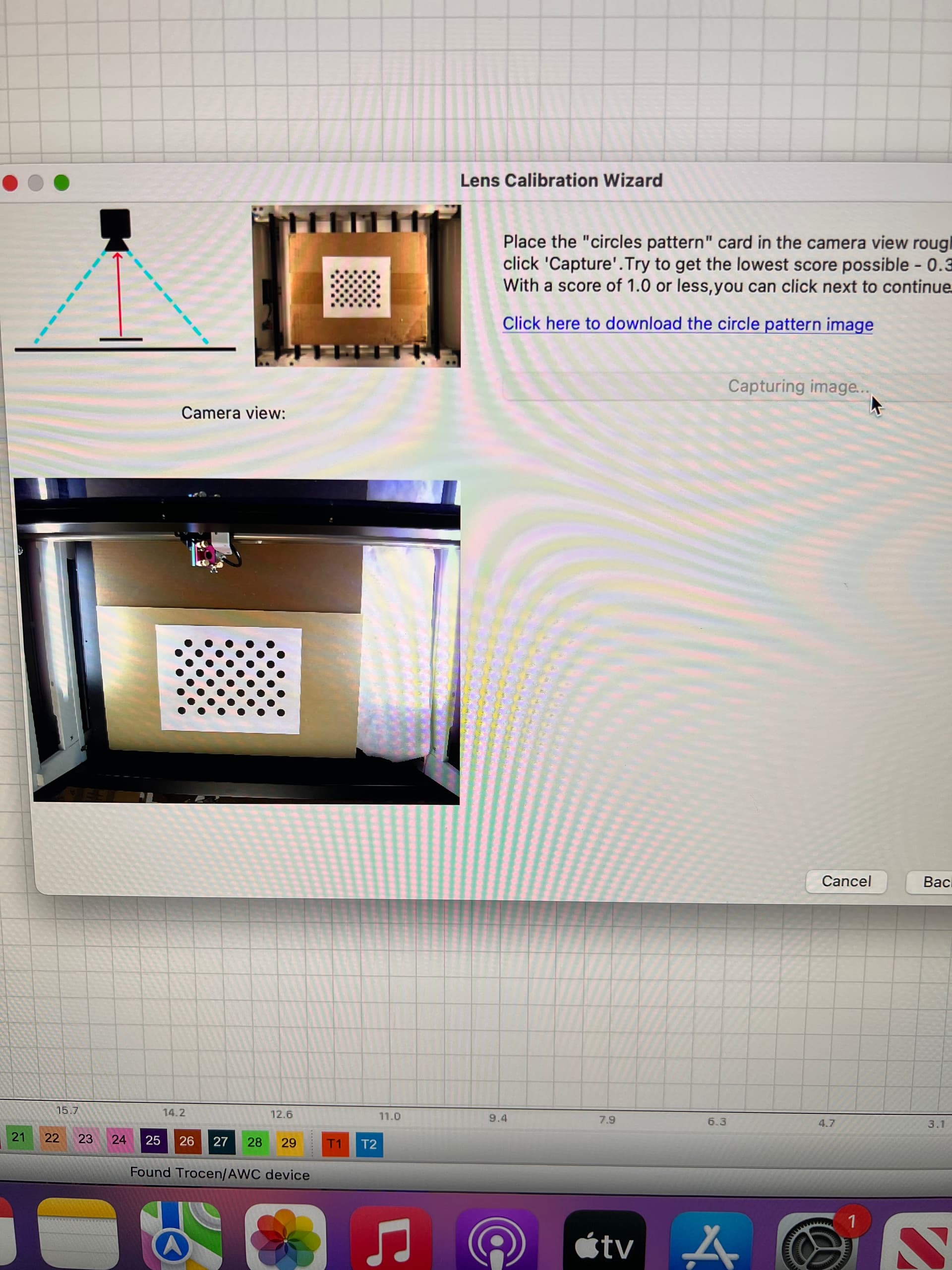

I’m attempting to align my new Lightburn camera on a new laser and a new iMac and I’m unsuccessful so far. I have the alignment wizard going, I have the engraved alignment design done and when I get to the point where I hit “capture image” to do the actual alignment steps, I hit the capture image button and nothing happens. I do have the image showing so the camera is working, but it won’t capture the image for alignment if that makes sense. Im running my iMac with Monterey OS. Laser is a LightObject 80w Ranger with Trocen controller. Anyone have any advice for me?

Here is what I’m seeing. When I hit the capture image button, nothing happens. And the next button remains greyed out.
Did you first go through the Camera Calibration process? Were you able to get captures during that process to work correctly?
That was weird too. I chose the camera and it said it was calibrated and didn’t have me proceed with any additional steps. It said calibration complete and had me move onto alignment.
Ok. Just started the calibration process over. This time selected the full calibration option. And no, it also doesn’t allow me to capture image.

Oh. I completely missed that the image was appearing for the calibration. It may be getting confused because of the holes in the bed.
Can you completely cover those holes and retry the capture?
I did give that a try also. I covered the entire bed Same issue:(.
There’s something in the image that the calibration process can’t reconcile. It could also be that the image isn’t centered in the overall field of view. Ideally you’d want the pattern to fill 1/9th of the overall view.
If it’s easy, try removing the camera from where it’s mounted and move to an area with very even lighting and a completely bare background. It needn’t be mounted for the calibration process.
Also, you should adhere the calibration pattern to something solid. Any ripple in the pattern will be interpreted as camera distortion.
