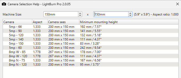

@jrhaim Use the “Help > Camera Selection Help” window to assist in the camera selection. Here’s a screenshot for a workarea of 150x150 mm.
The numbers after “mp” are the viewing angles. Yes, a random Chinese camera with similar specs will be just fine.
You will measure the distance between the camera and the workpiece. If this distance is way larger than the “Minimum mounting height” in the table above, you will lose resolution due to the cropping.
