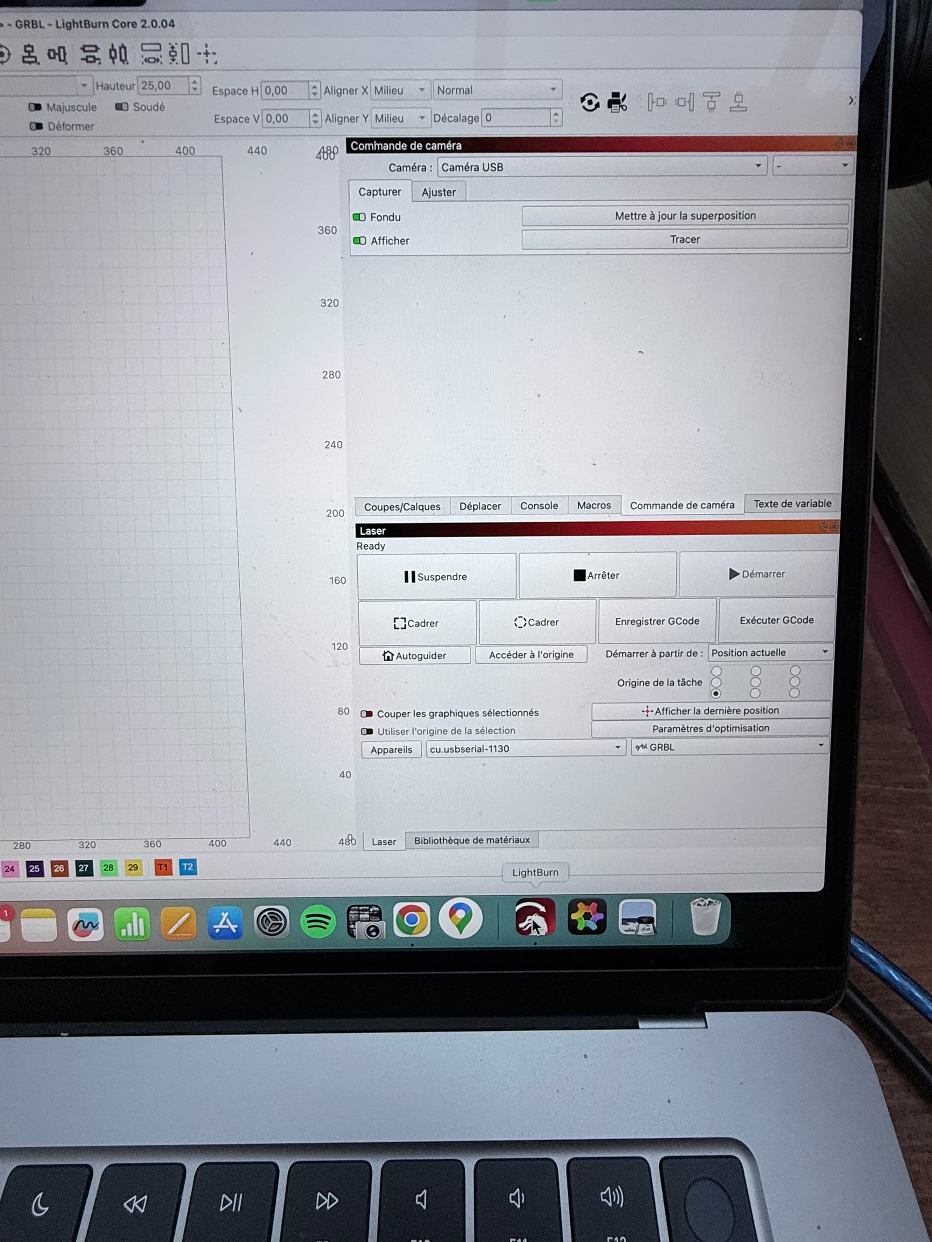

Hy, Lightburn 2.0.03 doesn’t recognize my USB camera. I’m on Sequoia 15.6. The permissions are fine. I can use the camera via my computer. What’s my problem?

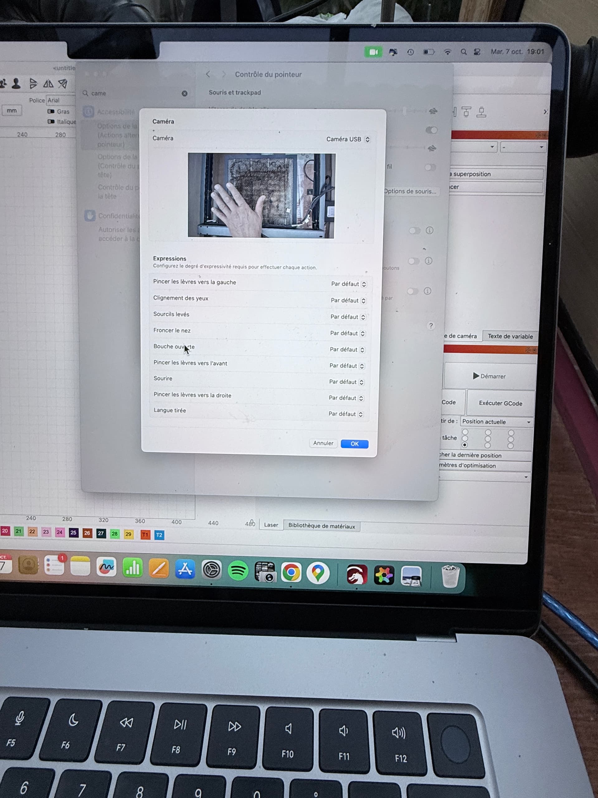

it’s work with my computer but not through LightBurn. no problem with MAC or USB.
Which program are you using to test the camera?
Make sure it’s closed before opening LightBurn to avoid collisions.
Can you select the camera in the dropdown menu here?
YES I CAN SELECT it in the drop down menu.
it works when I open on my Mac bookair the setting menu and setting camera!
no problem from mt usb-c

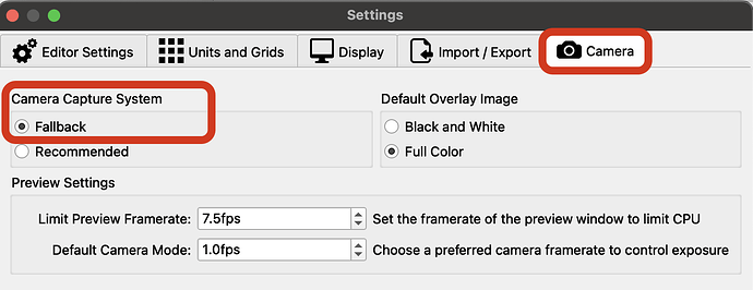

Please let us know, if this helps:
I can’t find this menu cause I’m on acmer P2. your topic don’t help me sorry
The screenshot above is from the “Edit > Settings” in LightBurn. This exists regardless of which device you have.
texte en grasthanks Aaron it’s work like that
