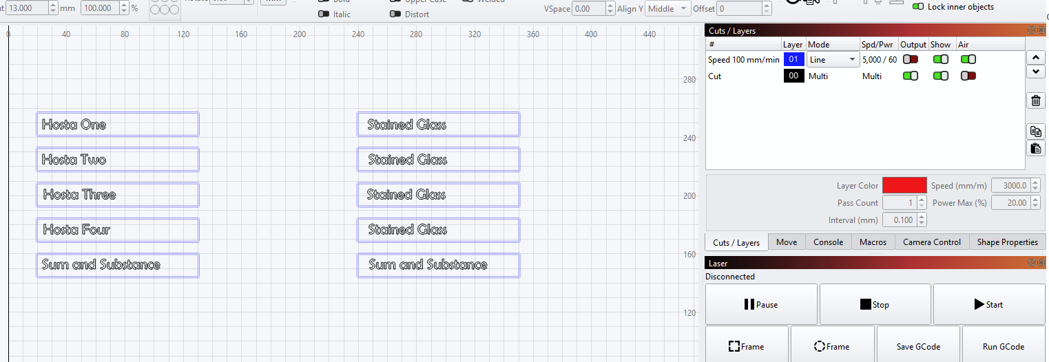

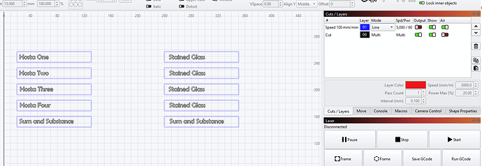

I engrave knives as plant labels. To do that I have 10 rectangles burned on a piece of ply (or cardboard) which is fixed and locked in place. I disable the output of the rectangular, and place the text in it. Now if I put the knife handles in the rectangular, the text comes nicely where I want it…
Every time I start up, I mark the rectangles again, to make sure everything is aligned.
This is how it shows in Lightburn
