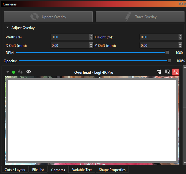

If you view the Camera tab in LightBurn, you should get a live (or rather, by default, a ~5fps video)
 ![image](https://forum.lightburnsoftware.com/uploads/default/original/3X/c/5/c5039ef3561622d8ee3d8cf42ec33e4d7c53c65d.png)
If it’s the overlay on your work area that you’re not seeing the refresh with, click the ‘Update Overlay’ button in the camera window.
If neither of these options work, can you take a screenshot and tell us what camera make and model you are working with?
