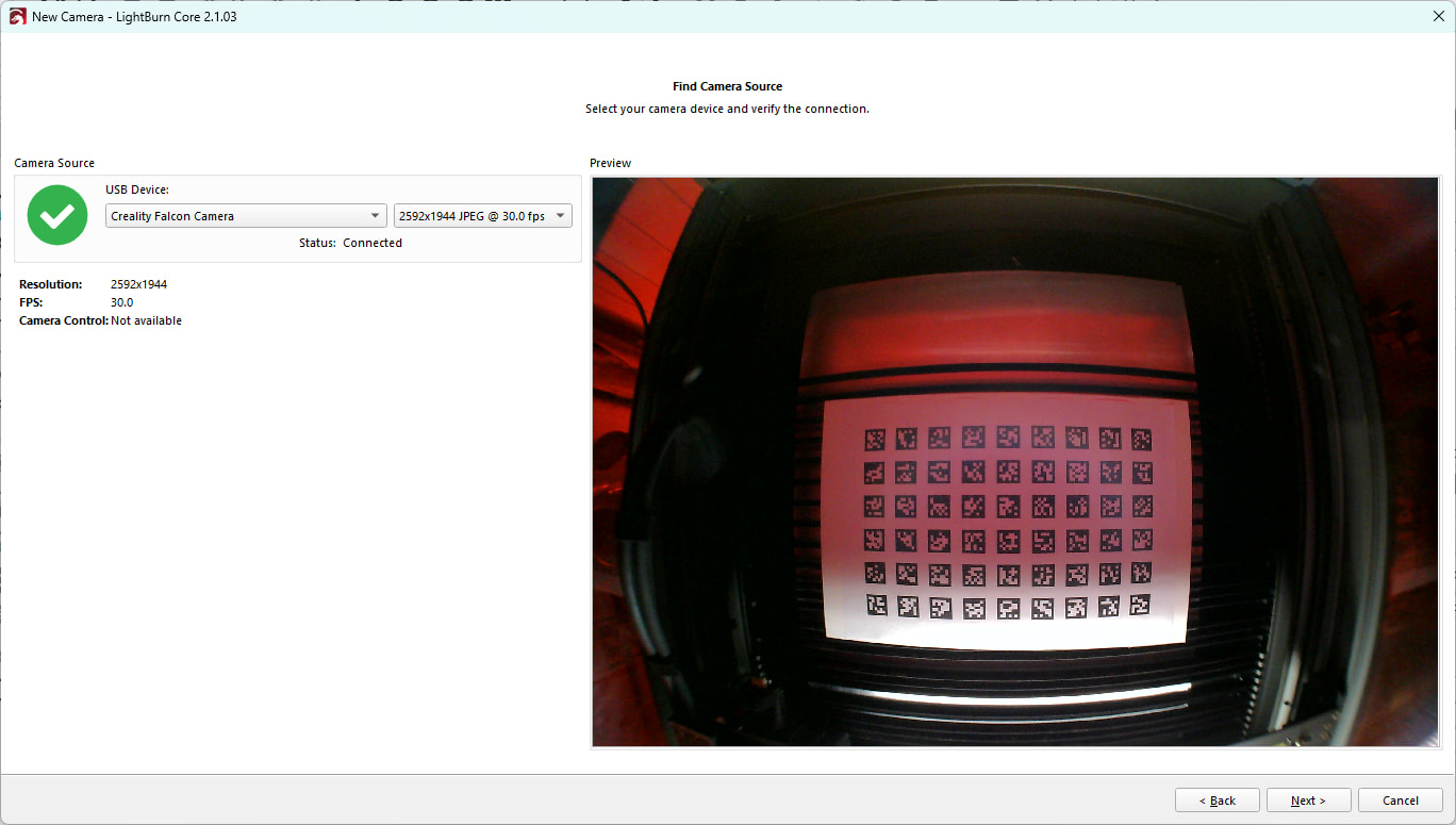

So, you were able to calibrate the lens with the printed AprilTags card? That would confirm that the camera is working and the permissions are correct.

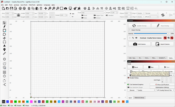

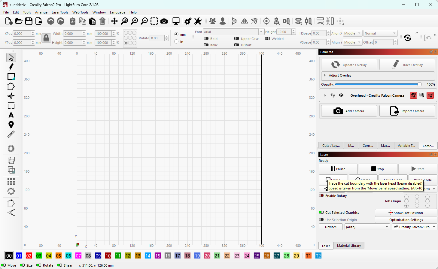

If possible, send us a screenshot of the entire LightBurn window, including the Camera window and the exact version you are using.
calibration worked fine, yes but the system says: “no camera connected” and “connecting”
Please send us the screenshot so we can see what you see.

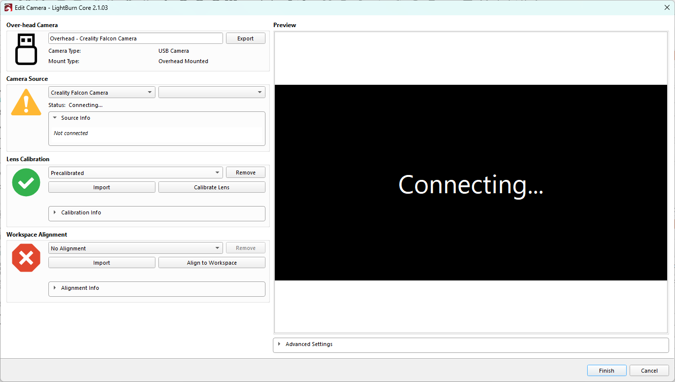

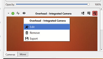

Also include a screenshot of the “Edit Camera” window, accessible with a right click on the camera name:
If another app was accessing the camera when LightBurn was started, you might need to restart LightBurn in order to re-gain access to the camera.

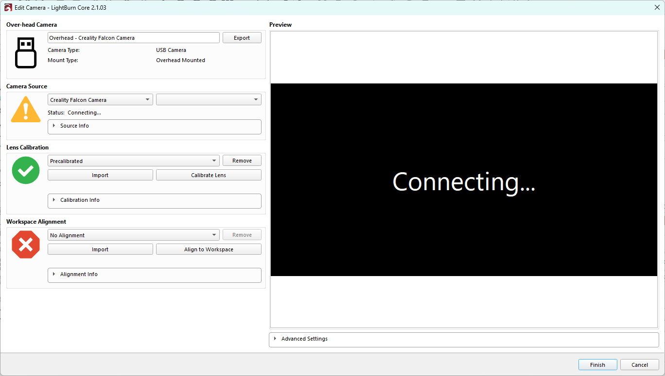

Here are the pics. Lightburn version: 2.1 running on Windows 11
Thank you for the screenshots.
Was the first one taken around the same time?
Please see if it connects, if you change this to “None” and back to “Creality Falcon Camera”. (The connection might take a few seconds)
Other than a connection problem, I can’t think of any reason why the camera isn’t connecting in the second image.
Is it still listed in the Windows Device Manager?

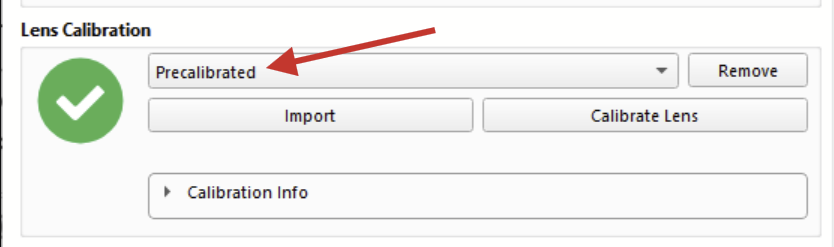

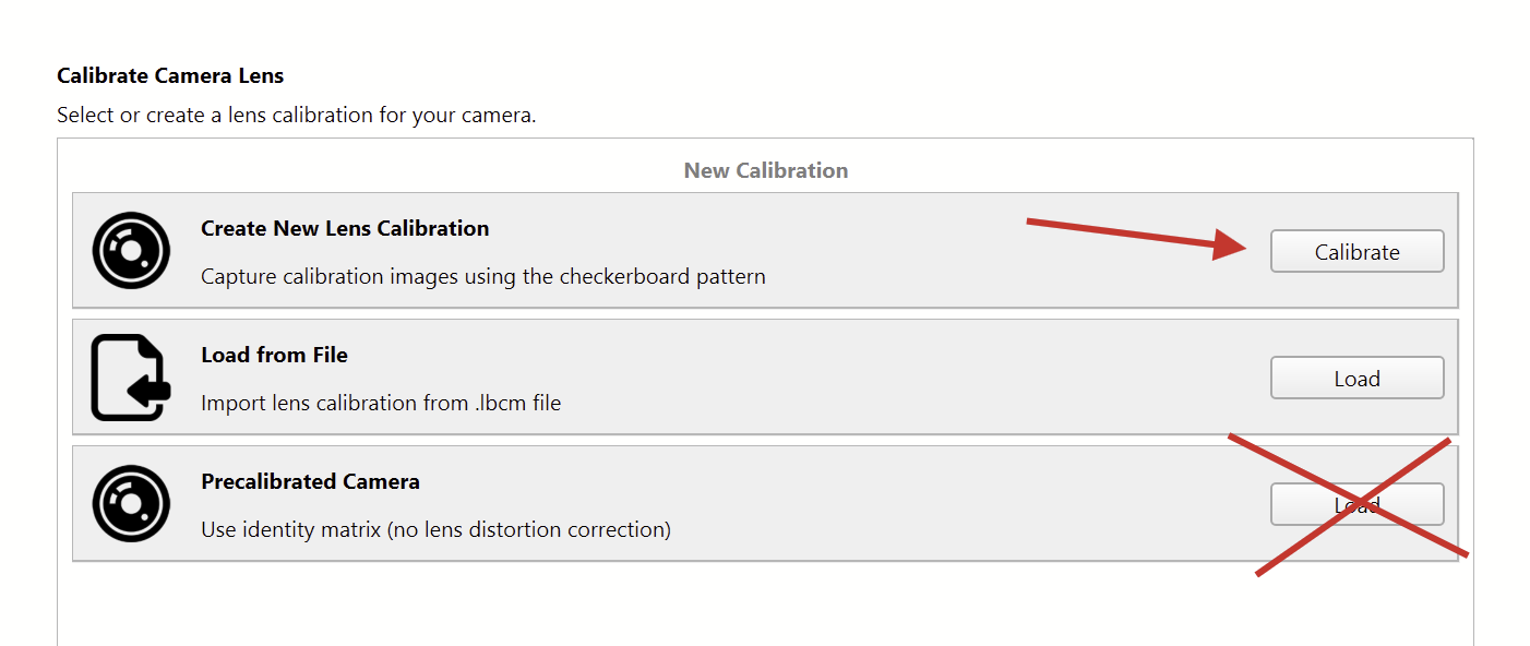

It appears, you’ve used the “Precalibrated” setting here:
This is only meant to be used on specific cameras which have the distortion precalibrated from the factory. You will need to calibrate this camera with the AprilTags to correct the bulged image before performing the alignment.
It’s probably best to remove the camera and follow our camera setup playlist here:
