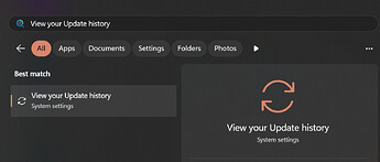

If Windows Updates are the only variable that changed, I’d recommend looking at the Update history.
Do you see anything in that list that could be related to USB drivers or cameras?

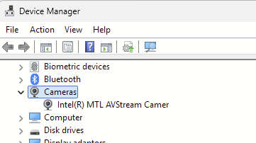

Does the camera appear in the Device Manager, and can it be used with the Windows Photos App?
Hi Arron
no, it does not show up in my Device Manager only the laser and how do I find the Windows Photo app as I found a Photos app see below, as not sure this is it

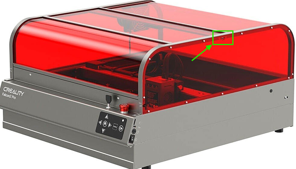

The Falcon 2 Pro has a separate connection for the camera here:
You’ll need to use a USB-A to USB-C cable. A USB-C to C cable will likely not work.

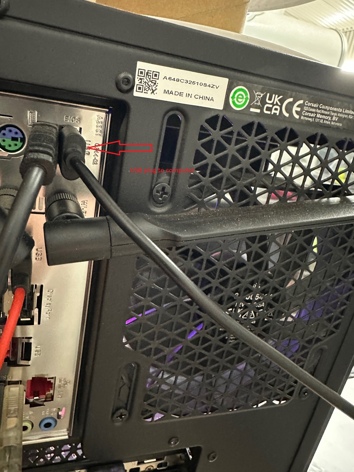

Hi Arron, I know this. I have been connected to this USB C plug all the time as well as the one for the laser.
Connected with a USB C thru a USB A connection to my PC. This is where I have swapped both of the USB C connections over from the laser to the camera connection, with knowing that both cables are working with the laser connection bi=eing the only connection I can see on my Device Manager

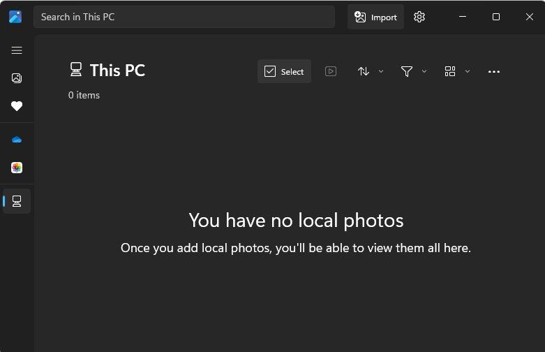

Sorry, I meant to say Windows Camera App.
But if the camera doesn’t show up in Device Manager, no program will see it either.
Since you’ve confirmed that the USB cable is working, I suspect that the camera itself is defective.
If possible, try it on another computer. Or reach out to Creality directly.

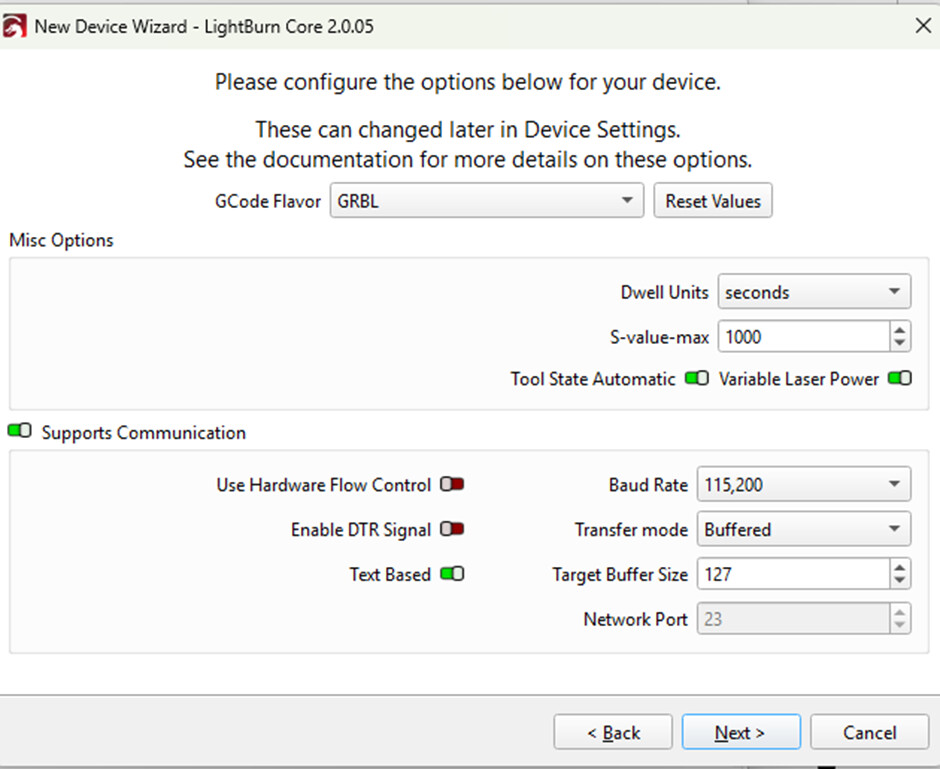

My issue is that when I go to set up in Lightburn Devices and Create Manually I can select Custom G code then press Next then select Serial/USB then Next, then populate the next page and press Next then accept the Origin page but with the next page as below the Network Port is greyed out so I can’t select any of the USB ports from the selection above
I think that the 2nd USB Generic Hub connection is from the USB Extender as Port# 12
Also in the USB Serial Converter is Port # 2
How can I change the Network Port to not be greyed out so I can select my port options?

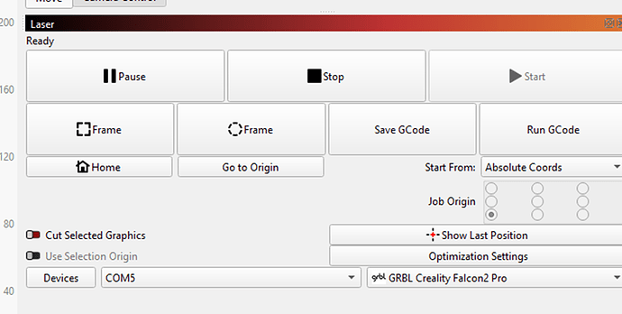

The “Network Port” in the device settings is greyed out because it has nothing to do with the COM port.
Serial COM port numbers are associated with arbitrary numbers and can change over time.
Select whichever Port disappears in the drop-down list when you unplug the laser.
You should see a response in your ‘Console’ window when you’ve selected the correct port.

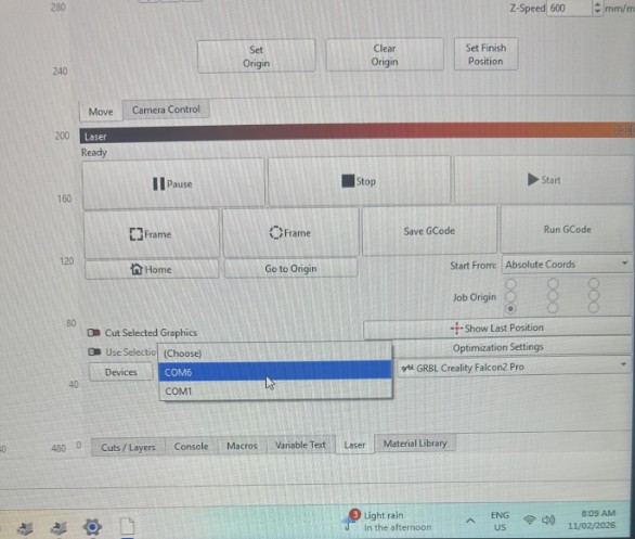

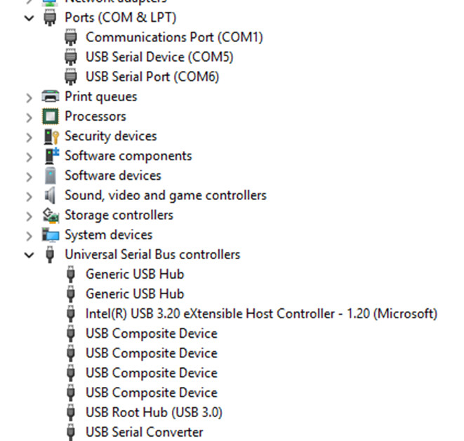

Using the non powered USB that displays as Com 5 under the Ports(COM & LPT), I can select that in Lightburn, see below

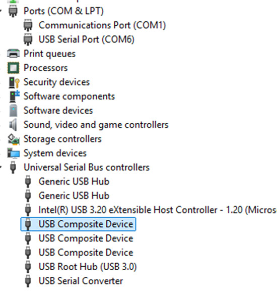

When I use the powered USB connection (now via a Network cable) the selection of Com 5 isn’t available to me anymore as the only options available to me now is in the Universal Serial Bus controllers in Device Manager.
This is why I need to be able to select it in the Devices and Create Manually to be able to select the Network Port option.
The powered USB extender displays all options of connections in the Universal Serial Bus controllers even though they might not be plugged into the USB Extender that’s why I need to select which one might be the laser port
See below as neither COM1 or COM6 are the laser option.

USB Hubs don’t usually display as COM ports. It’s one of the devices that are connected to this hub.
Forget about the “Universal Serial Bus Controllers”. You are looking for the COM Port of your laser.

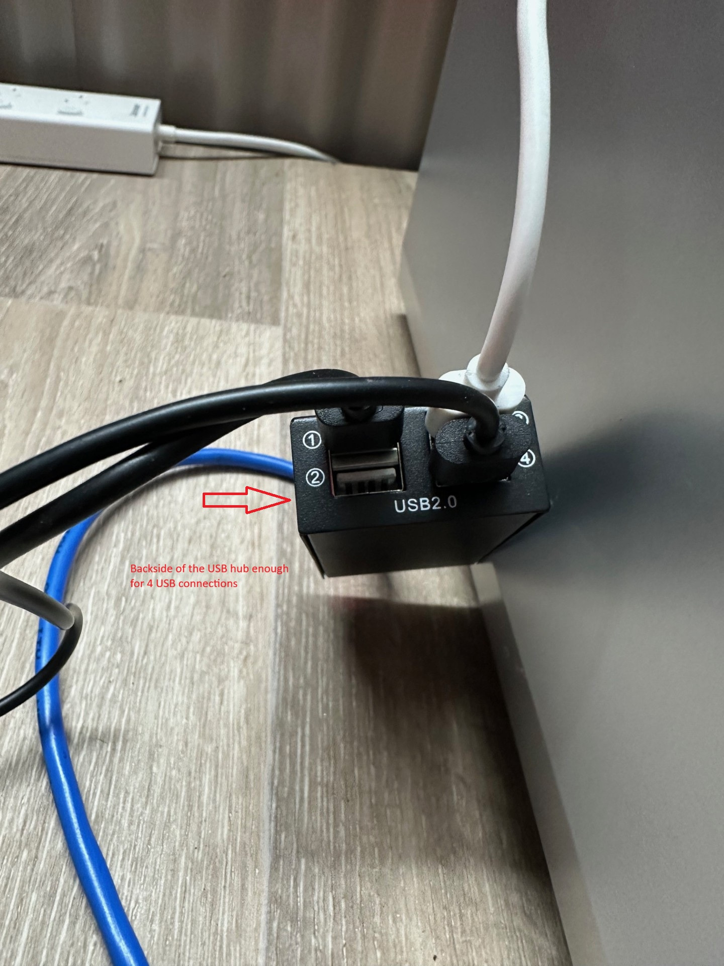

I don’t understand what that means. Can you show a picture of what you are using here?
Again, since you are connected over USB, you don’t need the Network Port. That’s why it’s greyed out. (Network Port 23 is the Network Port, not the COM Port. This is only relevant, if you are trying to connect over WiFi, not USB.)
You manually created the Device. The COM port needs to be selected afterwards, in the “Laser” window.
There is no “default port” because these numbers are assigned by Windows and can change arbitrarily.

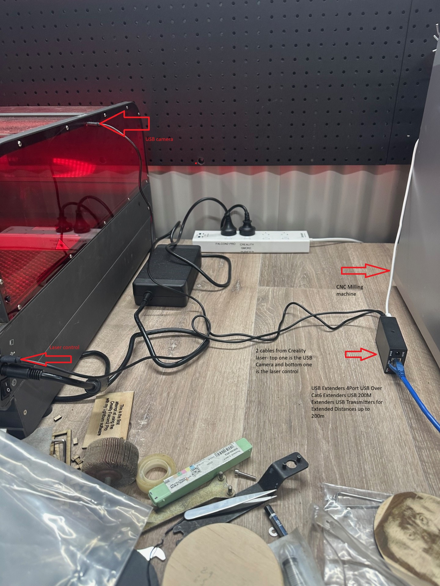

Hi Aaron,
thanks again for the reply
I bought the 5 meter cable
The ethernet cable is 20M long
I wanted to use the powered USB connection through the ethernet cable as wanted to cleanup the number of cables I have on the floor.
Do you know what Windows does when defining a USB connection is either a Ports (COM & LPT) or Universal Serial Bus Controller as it appears to me that the other machine that connects through the same ethernet cable appears as COM6 yet the other USB cables are not, but created as Universal Serial Bus Controller ?

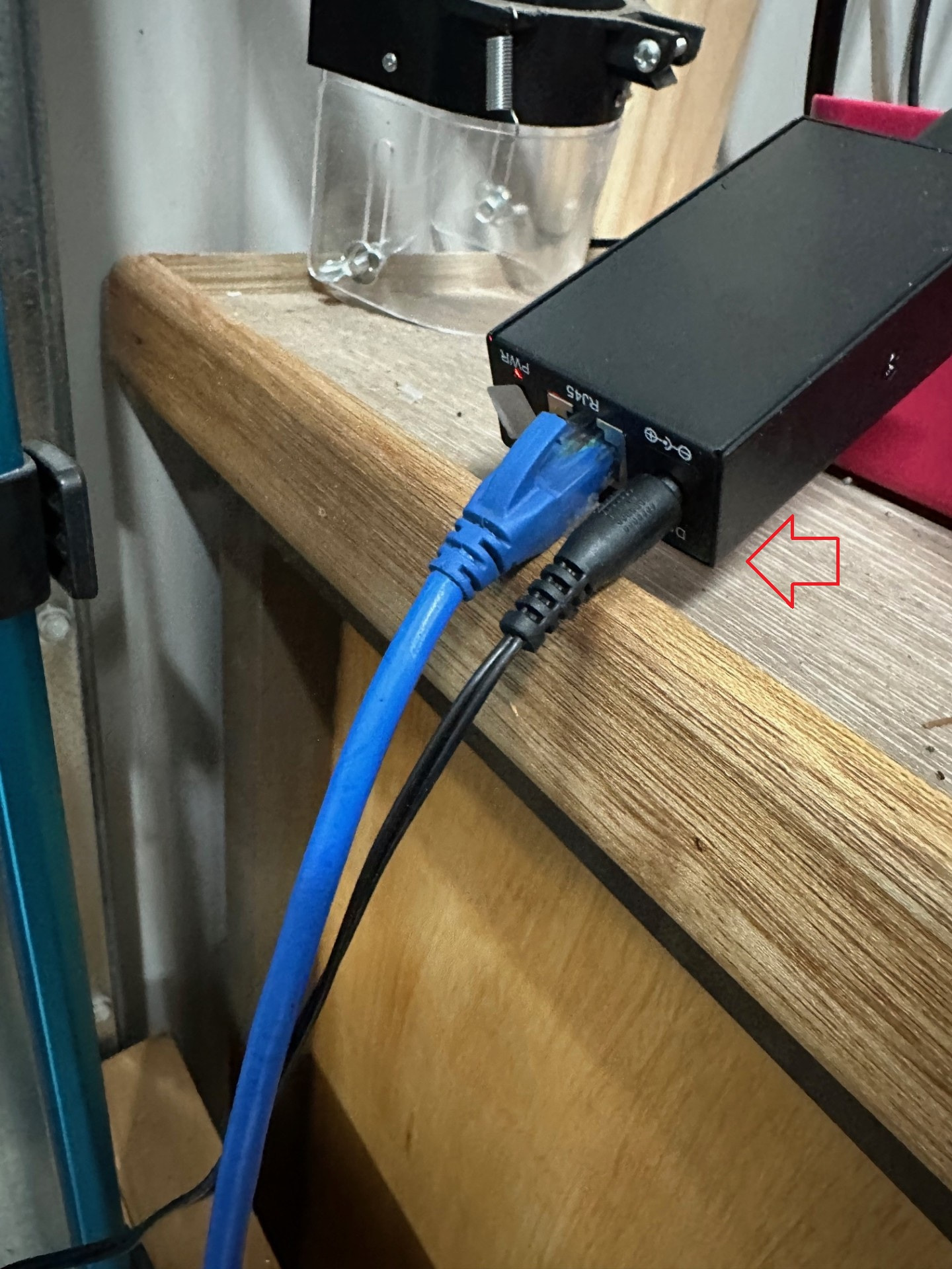

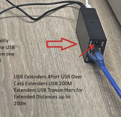

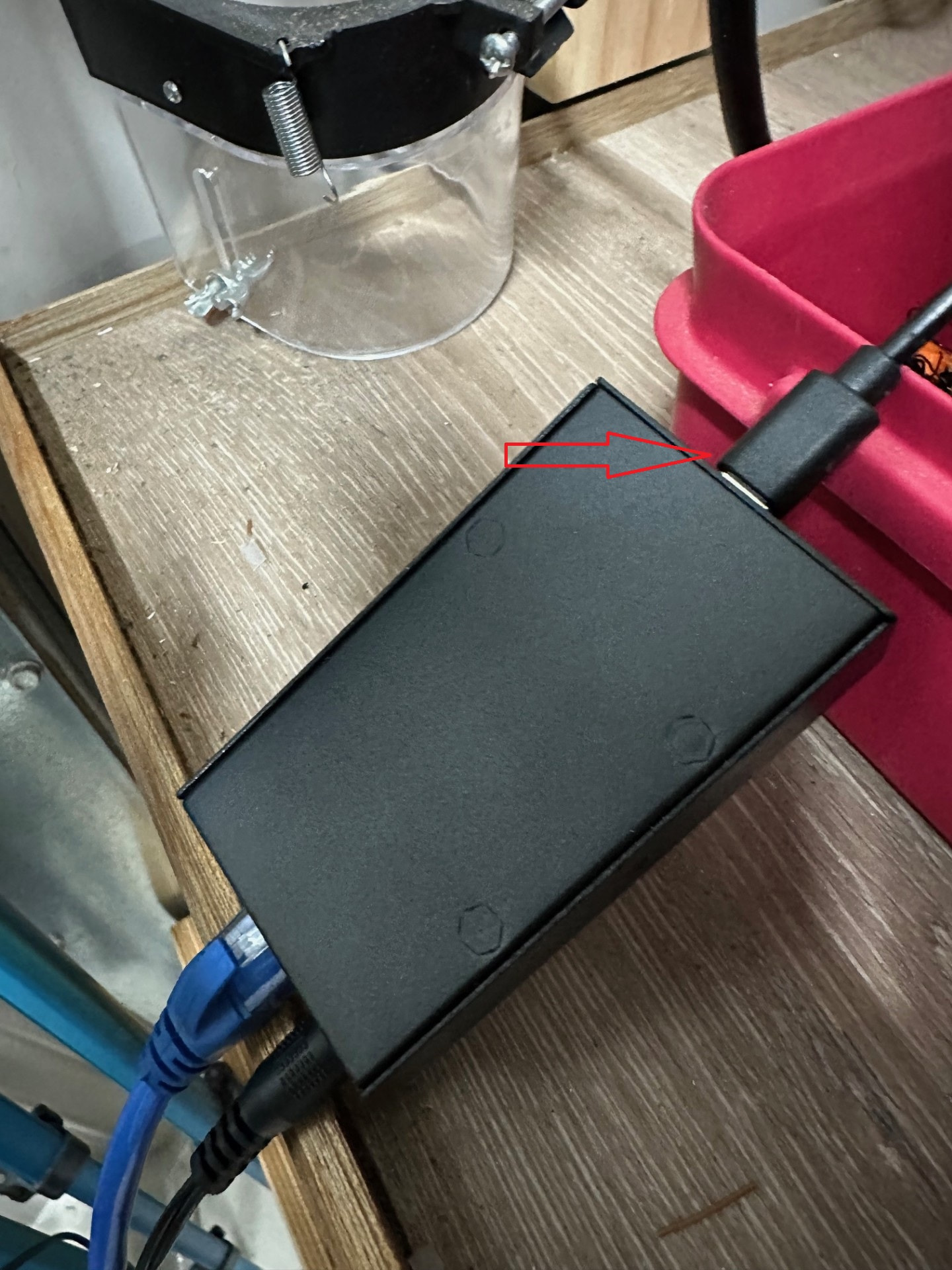

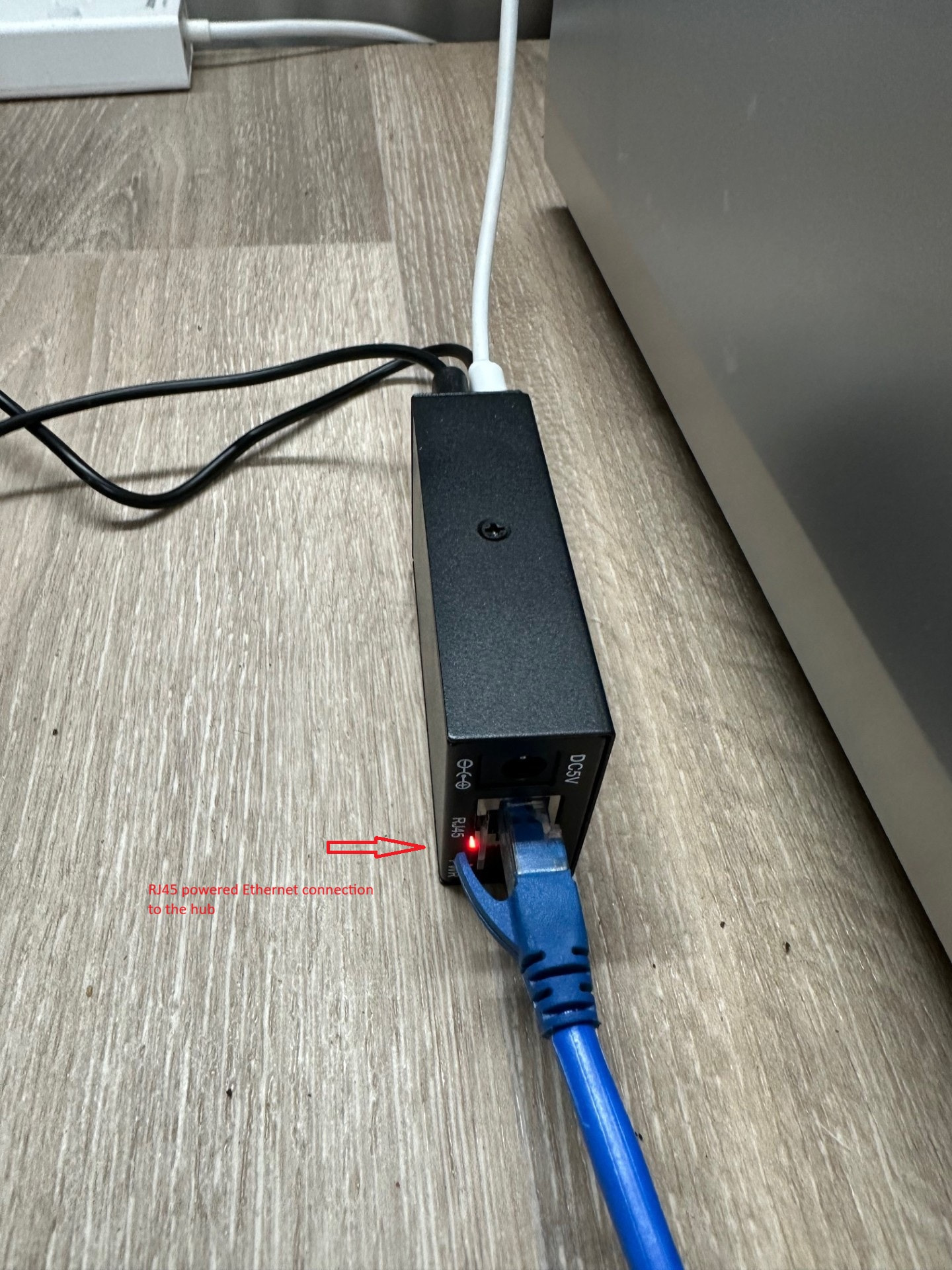

Thank you for the pictures. That does clear things up.
It appears to me that the Laser/CNC side of this “RJ45 USB HUB” also needs to be powered separately:
(The red light on the RJ45 is on, but this does not necessarily mean that the box actually receives power over Ethernet, “PoE”)
The “PWR” led is off!
Do this, please:
Connect the correct power supply to the extender on the laser side, and see whether you get a COM port to select in LightBurn.
If you don’t, do yourself a favor and test it with a direct USB connection from the laser to the computer.
The Falcon’s camera should also appear in the Device Manager.
Same goes for a mouse, or keyboard connected to one of the USB ports on the backside of the hub.
