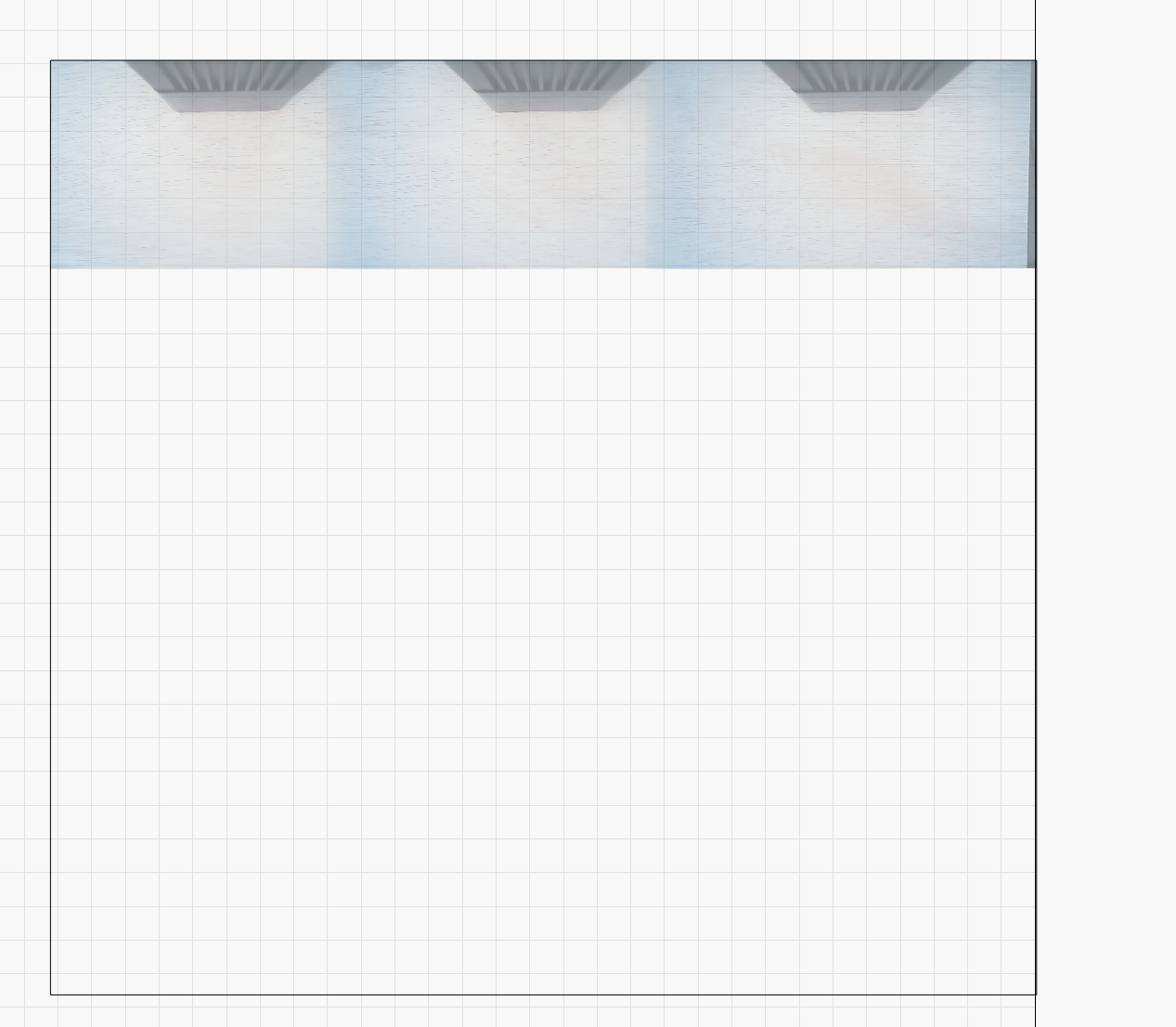

Currently I am trying to get the camera overlay working on my Creality Falcon, where I created a custom camera mount for it. I did set successfully up the “Calibrate camera alignment” with the “camera is mounted to the laser head” option. But when I am trying to create the overlay is only taking pictures of the first row in the back, by then the capturing overlay progress bar has reached 10%, then it stops generating the overlay and finishes it…
What gets generated:

I’m not certain but I don’t think the whole bed would normally be captured.
If you select an object on your workspace and then hit “Update Overlay” does it scan within the proximity of the object?
Thanks for your response,
That seems to work better and is doing multiple rows now!
But not when the complete bed is selected (Even selected if I create full width/height rectangle). It looks like the software is getting stuck or something trying to capture the complete width.

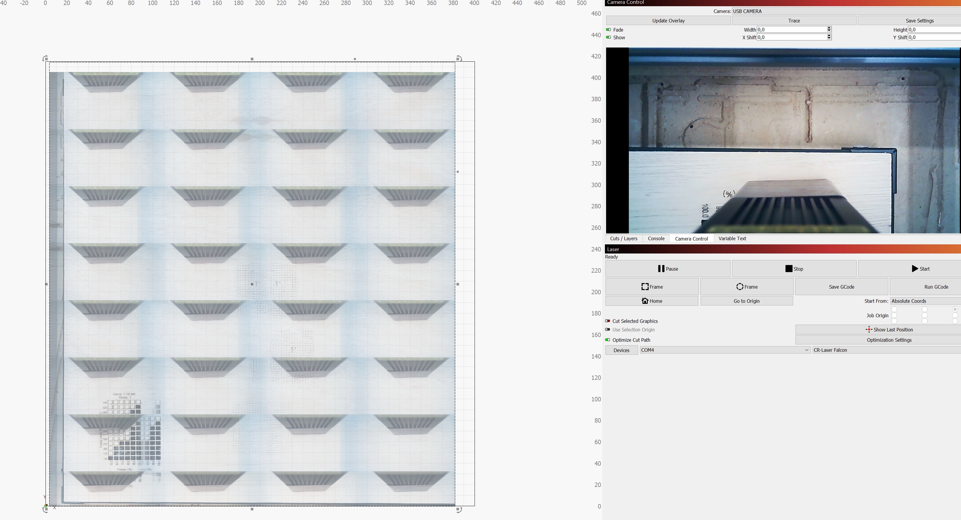

The issue only seems to appear when its reaching the right end
Its working fine when I keep a bit of free space on the right so I think its a bug in the software maybe:
(Don’t mind the overlapping, it seems not been configured well enough that its perfect…)
