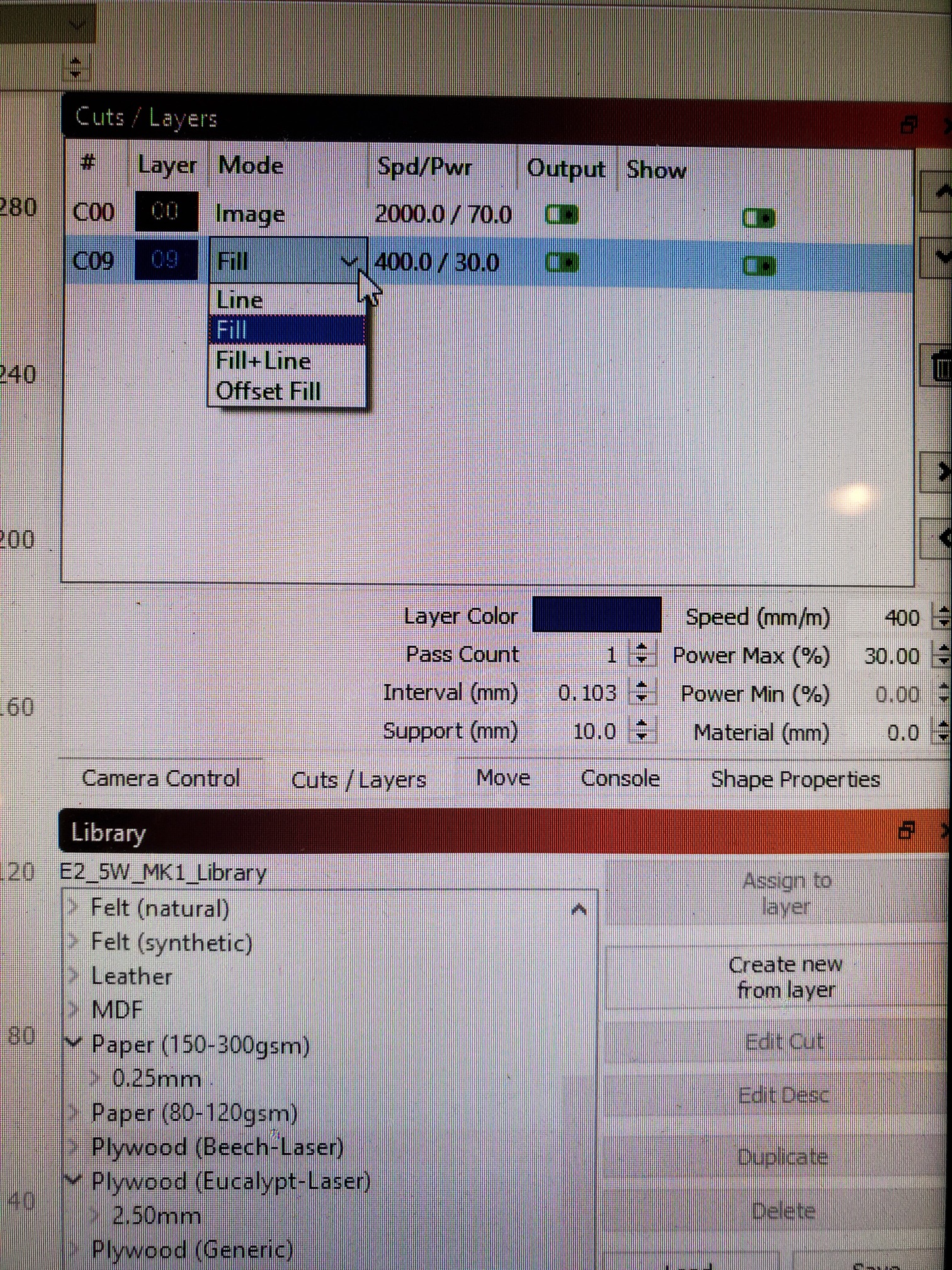

Can an image that is traced be dithered? If so how? When I paste an image it goes in as image and that can be dithered but when I traced it comes up as a fill.
Can someone tell me how can I change a fill mode to image? I do not have that as an option.
I also tried going into the library but it won’t let me sign a layer as image.
Can some let me know if this can be done. I don’t mind the fill but I would like to have some images of trace dithered or me being able to select the image mode I want. I am not able to do that on a trace.
Any help would be appreciated. I’ve only been doing this for a month and a half. Thanks.!

After tracing the image, go to the edit menu and select “convert to bitmap”. This will make it an image that can be dithered.
Oh my… thanks a bunch!!:blush:
