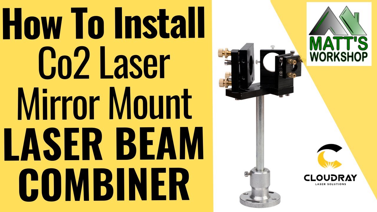

Hi, maybe this may be of some help.
[![](https://img.youtube.com/vi/Eh1ZSW4hMSs/maxresdefault.jpg "Co2 Laser Upgrade - Laser & Red Dot Beam Combiner for CNC Co2 Laser Machine") ](https://www.youtube.com/watch?v=Eh1ZSW4hMSs)
<div class="post-metadata">
**Author:** ![Kris1](https://forum.lightburnsoftware.com/user_avatar/forum.lightburnsoftware.com/kris1/32/21487_2.png) [@Kris1](https://forum.lightburnsoftware.com/u/Kris1)\
**Post date:** [May 8, 2021, 9:37pm UTC](https://forum.lightburnsoftware.com/t/can-anyone-recommend-a-beam-combiner/40434/8 "2021-05-08T21:37:52Z")
</div>
Not the same machine type but the principles are the same…
