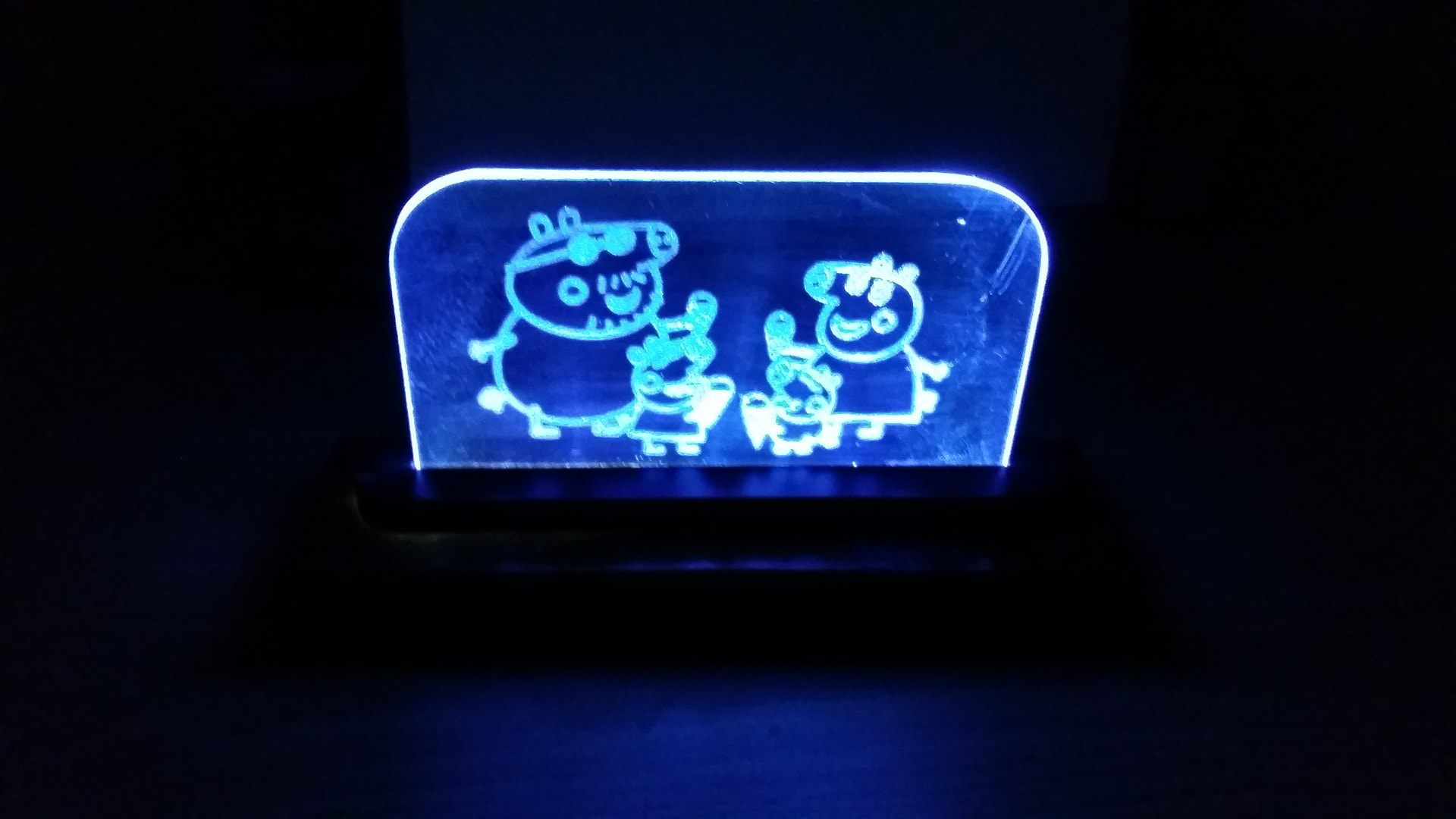

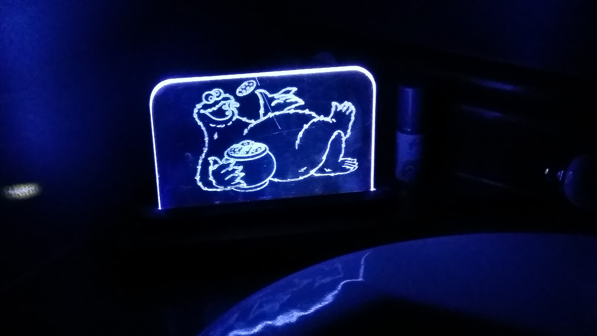

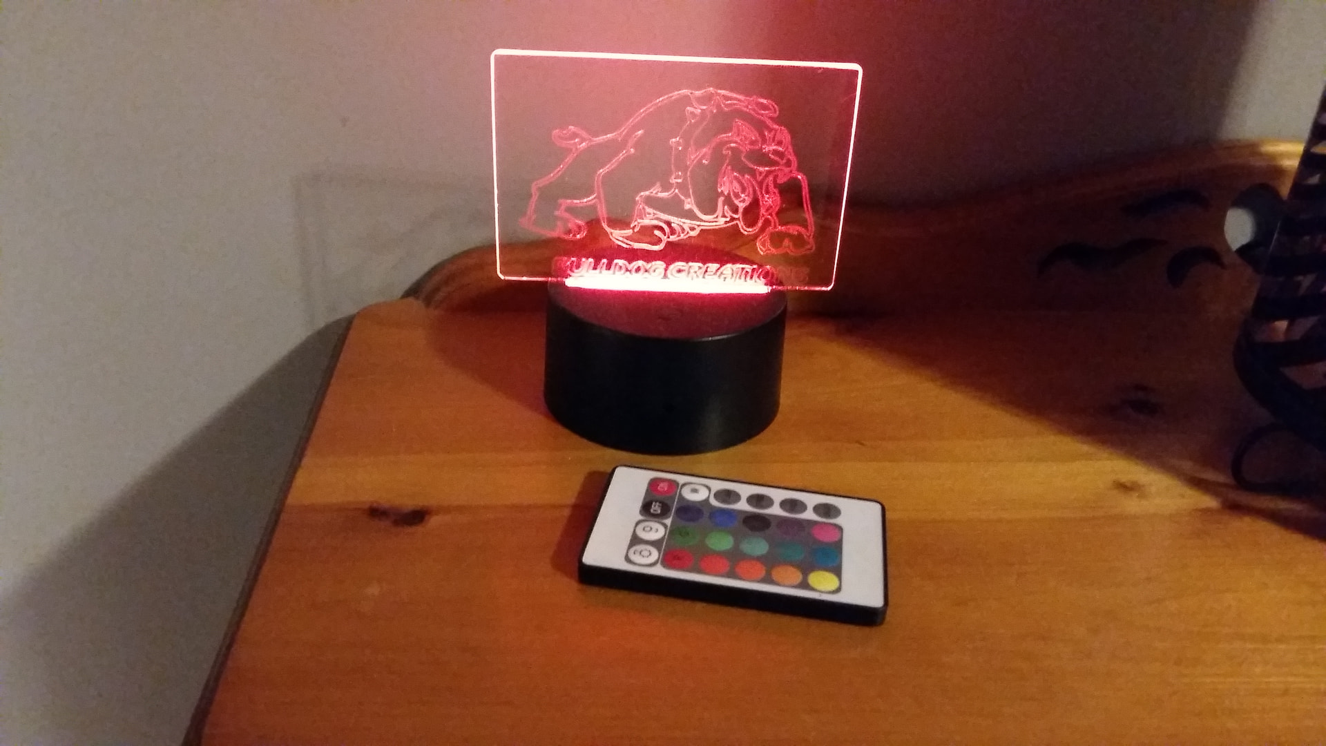

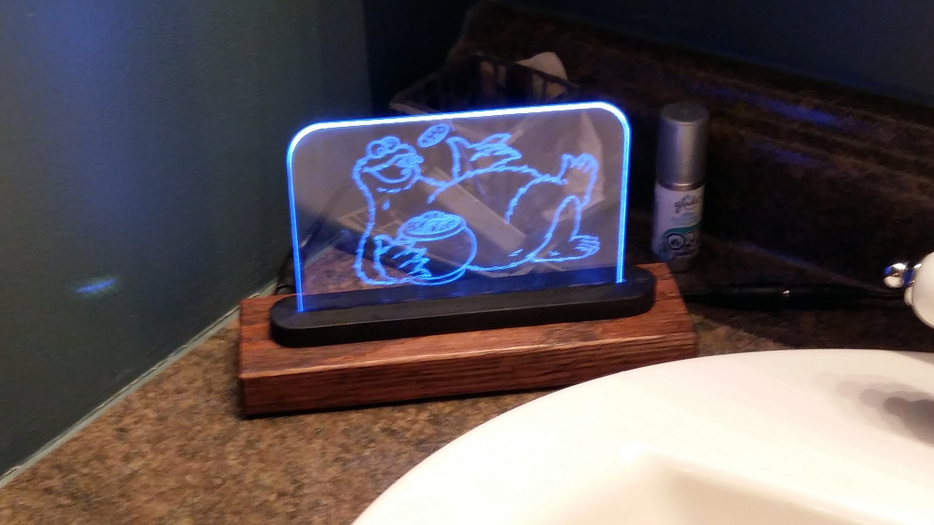

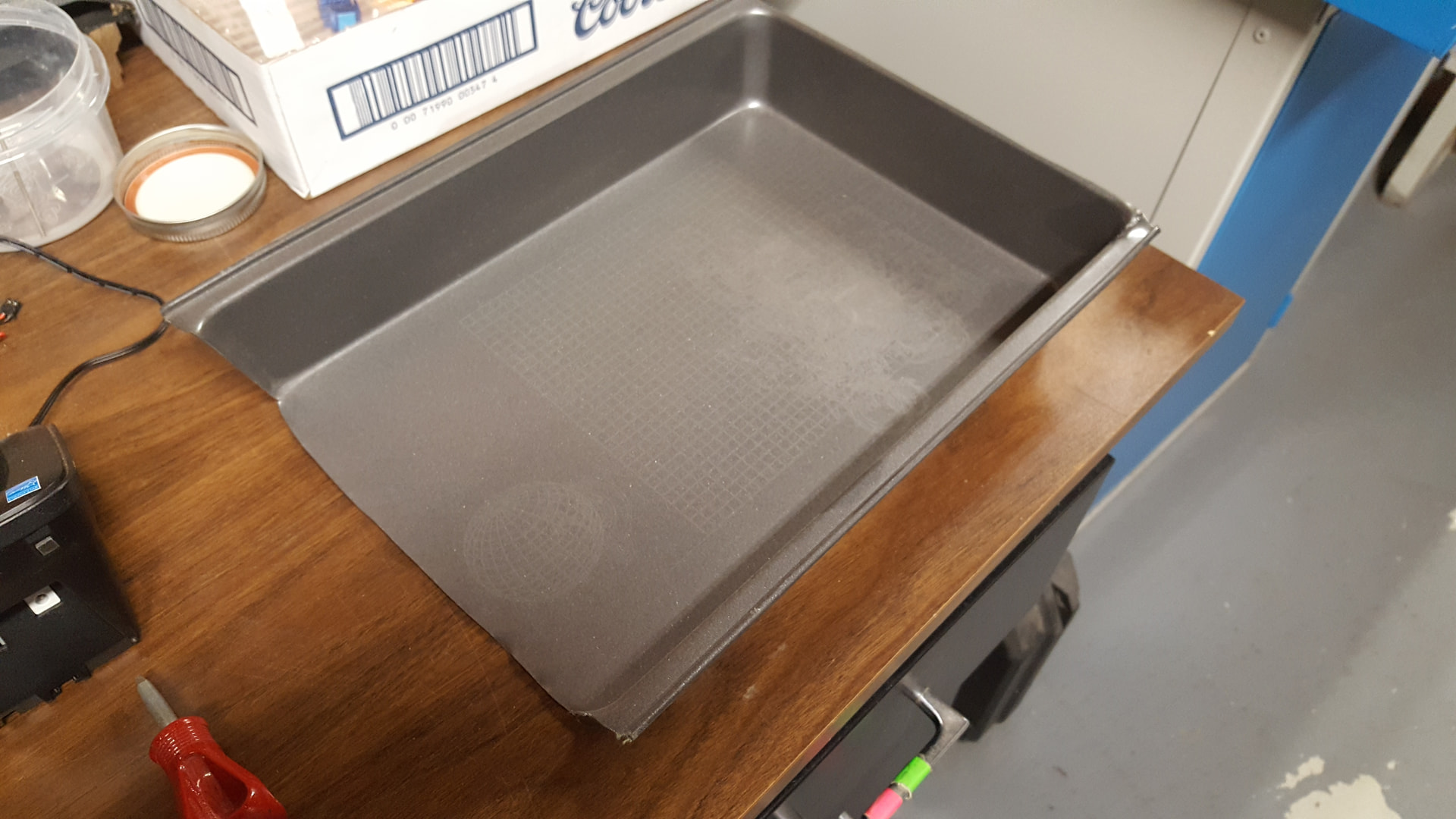

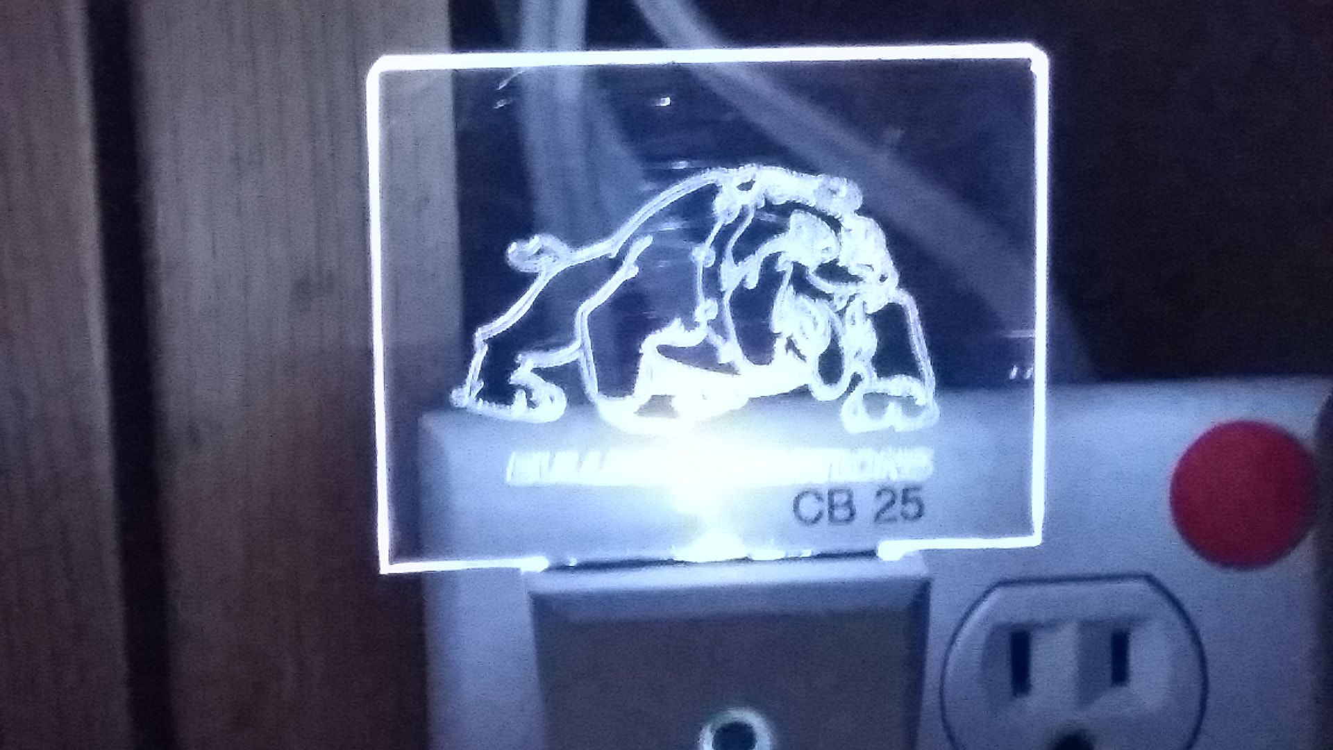

For plexiglass I use a teflon cookie pan
Place the plexiglass on cookie pan
focus on cookie pan
Then engrave
Still doesn’t cut… :man_shrugging:
Another indirect method of marking. Thanks.
