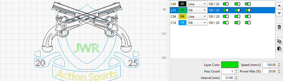

Is there a way to score layer c00 and c04, and not engrave layer c14 underneath? I’d like the line engrave to be on top of the shield. I’m hoping to use the file on my wecreat vision pro 45 if that matters.
Thanks!
Thanks!
Move all the text to layer C14. That will fill everything except the text itself.
Make sure the shield is grouped together then select the guns in entirety, use the offset tool and choose a small outward offset, outer shapes only and select resulting objects. Do not delete original. After confirming the offset, shift select the grouped shield and open Boolean Assistant and choose the correct subtract mode to get the desired result. Withthat selection order it should be B-A.
Check the preview. You can also toggle filled rendering so you can see the results in the workspace. Alt + Shift + W
Thanks, I’ll give it a shot when I get back to the shop tomorrow!
