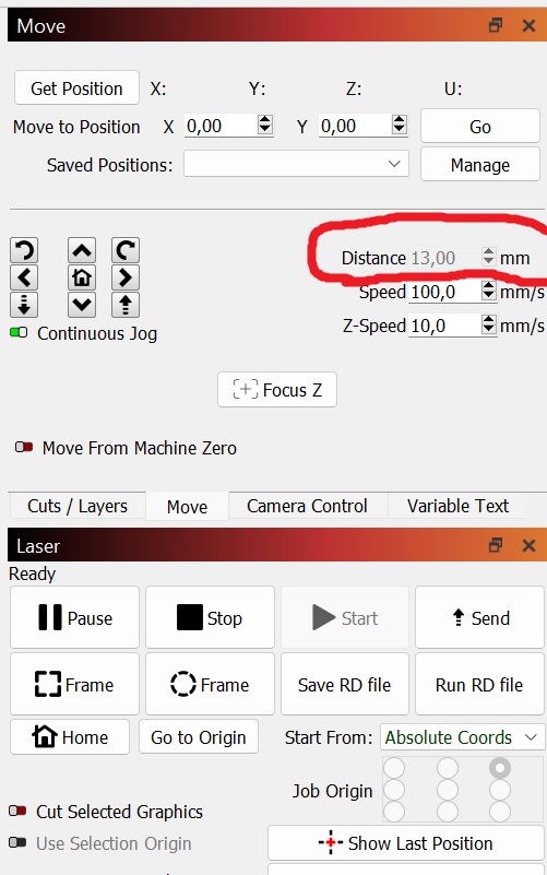

I have a Gweike Cloud Pro CO2 laser, which I operate via Lightburn.
I’ve been using this setup for a few months now, but I suddenly started experiencing issues today.
Everything was working fine at first, but in between jobs, the “set distance” field suddenly turned grey and now I can no longer enter any values.
The machine requires me to manually set the distance for every job (17mm minus the material thickness), but all of a sudden it’s set to a default 13mm and I am no longer able to make any adjustments.
The machine is connected and its status listed as “ready”, I can move the laser module via the arrow buttons in the control panel, so it’s definitely connected, I simply can no longer enter the required values.
Does anyone know what might be causing this?
You control the distance by holding the ‘key’ down… You have it set to continuous jog
Screenshot from 2023-01-30 11-20-44
I’ve always had continuous jog activated (it was activated by default and never interfered with my settings, so I never bothered to deactivate it in the past), and I tried deactivating it earlier, which didn’t change anything. After a couple of re-starts, and de-activating CJ each time, things are now back to normal. I think it may have been a glitch that allowed the setting to work with continuous jog activated in the first place :sweat_smile:
Either way, thanks for your help, problem solved :slight_smile:
