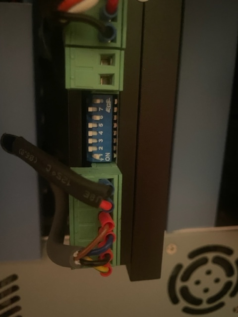

I attached my rotary and went through the steps to set it up. When I click the test button, it moves along the x-axis about 1 inch and stops. I tried engraving a 25.4 x 25.4 mm square, and the square measures 25.4 mm x 152.4 mm. Every pattern I try, even a simple box in Lightburn, is stretched along the y-axis. I went back and double-checked my steps per rotation, and according to my machine should be (6400*2) 12,800 still nothing. I changed my steps per rotation to 360, 1,000, 2,000, 6,400, and 10,000, and the image still stretched to 152.4mm. Do you think it is possible that I need an update on the firmware for the controller? Your thoughts? I have a Cloudray with Ruida Controller RDX644XG

I cannot tell what your switches are set… it requires information on the placard of the drive… not all drivers have the same steps …
I assume the two photos are the two motor drivers… if we’re using only the Y axes, that’s all we’re interested in… no need to deal with any other axes…
What kind of motor driver is it?
In the link, you can see the type of motor driver and placard that indicates what the switch settings are doing… Mine is a DM556 motor driver…
When I get home, I will tell you what kind it is. However from 5-8, it shows off , on, off, on. This brings it to 6400. So I took 6400*2(12,800) and plugged it in. But I’ll tell you when I get home. Thanks for your assistance.
How did you come up with the translation from switches to steps?
That’s the thing all my research seems to tell me that 5 is Off; 6 is ON; 7 is OFF; and 8 is ON. I looked at the chart and the value is 6400. Am I looking at this wrong? Thoughts?
Looks correct… It’s hard to fix some things if you assume the previous steps were taken correctly. and they were not… so it’s a sanity check if nothing else…

The best tactic may be to start at the digital end and work to ensure that the motor itself is rotating 1 complete rotation and back with the test button … without any ratio adjustments.
Setting your rotary to the same step/rotation as the placard you can test at the motor… it will be right or it won’t…

They seem to indicate that it’s 6400 steps/rotation not 2 times that.

It should be the 6400 according to the data they sent you. No ratio…

I just wanted to let you all know that I figured it out. I looked over the information that Cloudray sent me. In Lightburn (1.4 version) I adjusted the “Length Per Step.” I opened up “Calibrated Axis” in the Lightburn “Machine Settings.” I typed in the values Cloudray provided and hit the Write button. So, the value in the Request Distance (1.3821) gave me the 21.6623. This was the value that worked for me. I will continue to work with it and make sure I am on track. I really appreciate your assistance.
