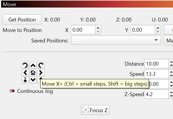

Maybe the Move Window ToolTip that reference the Modifier Keys Ctrl and Shift can help:
ahh, i never noticed that tooltip before… likely because i’ve always had it in continuous jog mode… and it could be a new thing in the pre release version i was told to download to fix the speed settings being on 0.0 on startup.
so, that big or small steps thing works just for the non continuous jog mode… which makes sense i guess as ‘small’ or ‘big’ steps does not translate to the continuous jog mode.
wonder if it’s possible to have something similar in a future build where control and shift keys can give faster or slower speeds when using continuous jog?
And maybe a hotkey to switch between continuous jog and steps per key press mode?
The icing on the cake would be hotkeys to adjust the speed, and maybe distance settings?

I had a play with these new slow and fast move keys in non continuous jog mode,
once i’d changed my controller settings to have ‘soft limits’ enabled things went better (with soft limits off in the device settings, when i pressed the move button too many times it crashed the head when it ran out of travel.. as you’d expect, turning soft limits on in the device settings means it can’t do that anymore, so that’s 100% a me issue, not sure why that’s off by default on my K40+ tho)
Next i set the movement distance to 5mm, so if i press just the keypad arrow keys, it moves 5mm per press,
if i hold down CONTROL and press the keypad arrow keys, it moves 1mm,
but if i hold down SHIFT and press the arrow keys, it seems not to be working as it moves 5mm.
BUT … if i hold down SHIFT and click the jog buttons on the screen, it moves 25mm, so the small, regular and big movements thing is working, just the big movements are not working with the hotkey and SHIFT.

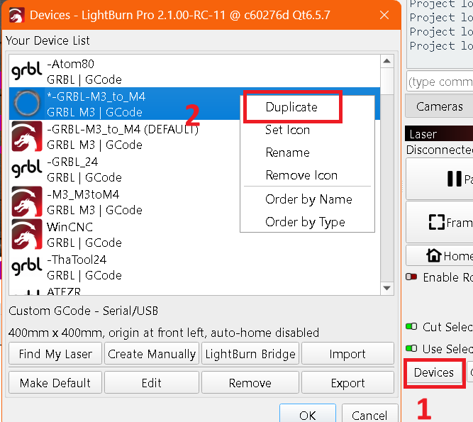

I also have a play / pause button that needs holding down for 2 seconds to start the job, then a short press and release pauses or unpauses the job (which i noticed lightburn does not re-send the M8 air command when it’s unpaused, so when i unpaused it on a cutting layer it resumed the cut on low air instead of high… it’s also not that easy to tell when the machine is paused, i accidently paused it during framing and couldn’t figure out why it would no longer do anything, a big flashing ‘Laser Paused’ box in the middle of the screen would be handy here)

You can duplicate your Laser Device and set the duplicate as Custom GCode then on your Device settings you have a few boxes where you can force the M8 command - maybe after or before the resume code…
oh that is awesome,
time to get into messing with the custom g-code settings it seems,
Is it just basic G-code commands that can be entered in those boxes, or could it be more complex stuff like perhaps an if statement that checks if M8 was active when the pause was initiated, so it only sends an M8 command when unpausing if it was on a cutting layer… so it does not turn on full flow air if i paused during engraving.
If the Custom GCode had a field for Cut moves and other for Fill moves it was easy. Unfortunately it has only a field for general Cut moves.
