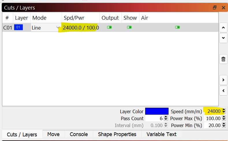

Laser is very jagged, like the perf setting is on. I’ve done everything I can think of, even return to default, unplugging, going out of lightburn and back in. Would appreciate any advice.

Well, I think I know the problem. You have the speed of the cut set to 24000 mm/min. That’s considered very fast. What I’m guessing is happening is that the motors are trying to go as fast as they can but aren’t able to keep up and skipping steps. This is why you are seeing perforations.
I suggest you start with something much more modest. Let’s say 500 mm/min. See how the results go.
Oh and generally, try to avoid going to 100% unless necessary and you’re confident about what you’re doing. This will shorten the life of the diode. Try to stick to 85% or less.

My cut set is 400, I am not seeing 2400. This was the manufacturer’s database suggestion. I have been using this setting throughout my trial, and have cut out over 30 of the pawprints. When I purchased lightburn a few days ago I have not been able to cut out one pawprint. Is there a way to reset lightburn?
The cut layer has this setting based on the file that you uploaded. This is something you would need to make sure it correct for each project.
Here’s what I’m looking at.
If you set your settings to inches this could show up for you in different units but will be the equivalent speed.
