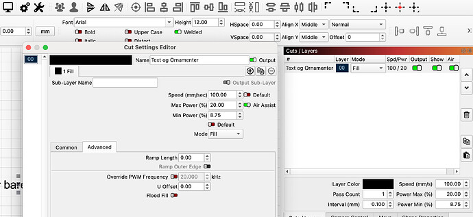

I worked with rdworks for several years and i starting using light burn and im loving it but there’s something buggin my mind since the start. i cant really engrave multiple objects in one scan. i even tried to weld everything in corel before exporting. the option is always greyed out.
as you can see the image i cant select any option and im working with vector objects.

Check if you have “flood fill” enabled, it shouldn’t :wink:
You can also decide and set in LB which mode you prefer, absolute coordinates, user origin or current position, the machine/LB remembers your settings.
turning off flood fill solved my problem.
