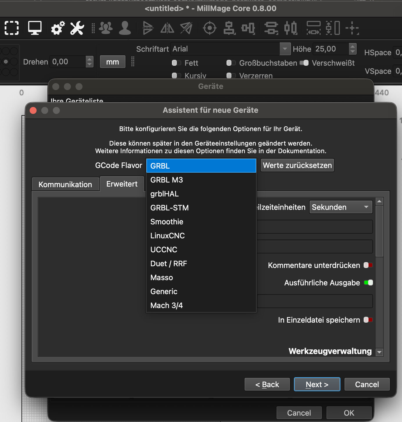

Hi,
I can’t find the FluidNC controller in list, see screenshot
Need help, please.
 ![Bildschirmfoto 2026-02-24 um 22.05.09](https://forum.lightburnsoftware.com/uploads/default/original/3X/c/a/caba97aa425f98b85689da5bc99d3af320d6274b.jpeg)
<div class="post-metadata">
**Author:** ![adammhaile](https://forum.lightburnsoftware.com/user_avatar/forum.lightburnsoftware.com/adammhaile/32/33797_2.png) [@adammhaile](https://forum.lightburnsoftware.com/u/adammhaile)\
**Post date:** [February 24, 2026, 9:14pm UTC](https://forum.lightburnsoftware.com/t/cant-fin-fluidnc/187874/2 "2026-02-24T21:14:55Z")
</div>
Just use GRBL. We don’t have a specific fluidNC flavor at this time. We haven’t needed anything different. But things like grblHAL _have_ required different handling so we have the separate flavor.
That being said, I’ve made a note to add a fluidNC flavor to avoid confusion.
**Author:** ![misken](https://forum.lightburnsoftware.com/user_avatar/forum.lightburnsoftware.com/misken/32/47593_2.png) [@misken](https://forum.lightburnsoftware.com/u/misken)\
**Post date:** [February 24, 2026, 9:15pm UTC](https://forum.lightburnsoftware.com/t/cant-fin-fluidnc/187874/3 "2026-02-24T21:15:24Z")
</div>
FluidNC is a Firmware, not a protocol type. You need to select grbl as type, since that’s the dialect that fluid is talking.
