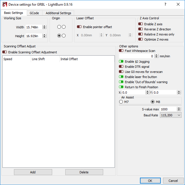

I am using lightburn on an Ortur Lasermaser 2 15watt.
I can’t get the Jog buttons to work.
Jogging is turned on in the device settings.
The machine will home, and go to the proper location and begin a job. It just won’t JOG!

On device, when you configured Ortur
Did you set homing position to front, left?

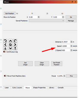

Can you show me please the screen shot of the Move tab?

Trying to jog the machine at 12300mm/sec, which is about 6 times the machine max speed is probably triggering the gsensors
Try lowering the Jog speed to 3000 and see if that works better please?

It worked.
