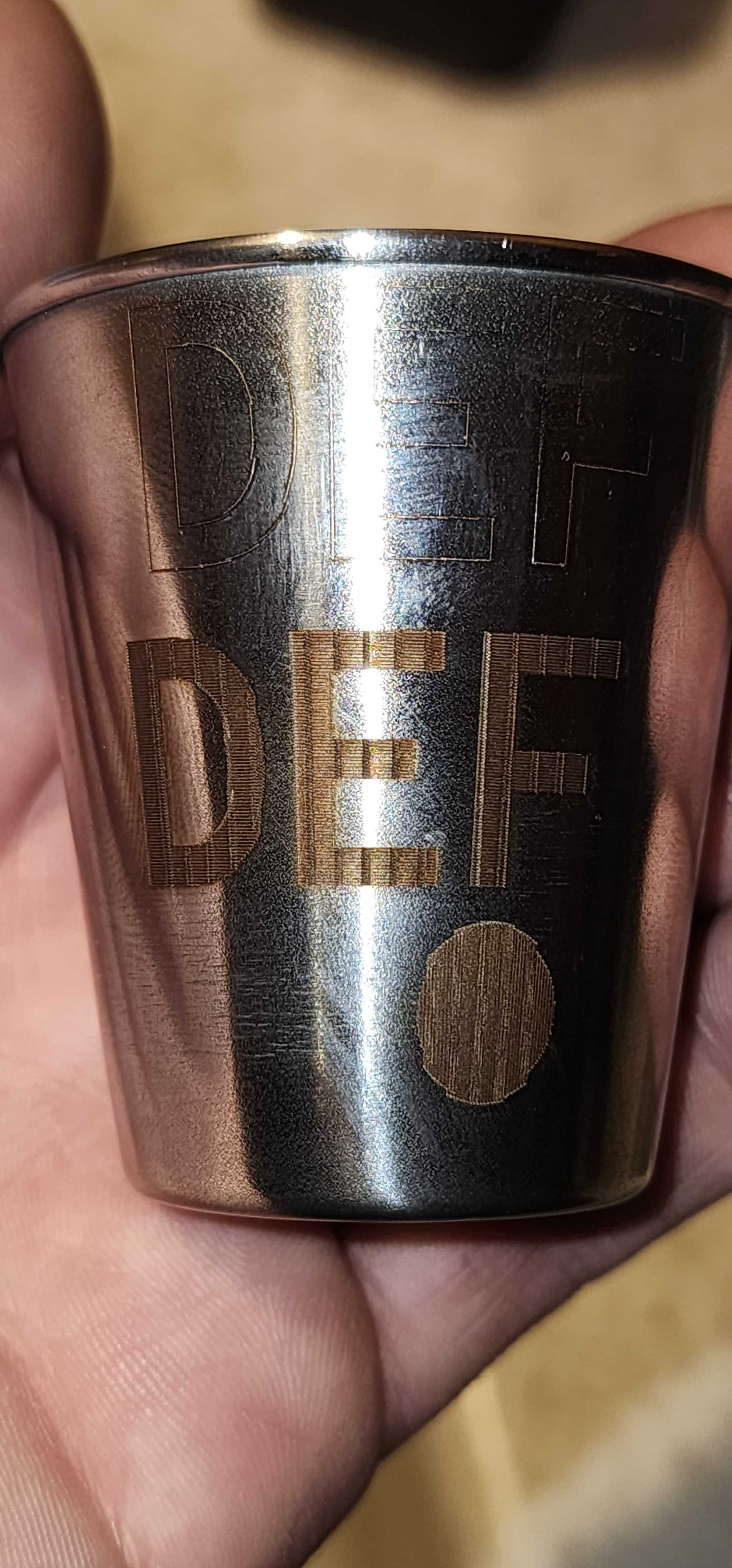

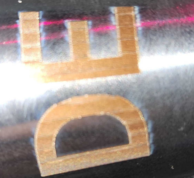

I can’t seem to get my lines to line up correctly, I’m unsure if this is me doing something wrong in the software or if it’s a hardware issue. I’ve had this machine and rotary for a few years but just never used the rotary since i couldn’t get it to line up correctly.
The Laser is a ComMarker B4 Mopa 60w
The rotary is a D80 from Commarker
The controller is JCZFiber
I’m on Lightburn Pro 2.0.05
The lines/art, no matter what it is I’m engraving, whether the object in the rotary is flat, tapered, rounded etc. doesn’t line up correctly. I usually resort to just using my xTool F1 and the rotary with that when I need to engrave cups but I’d like to be able to use the fiber laser instead.

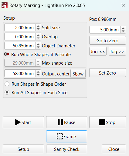

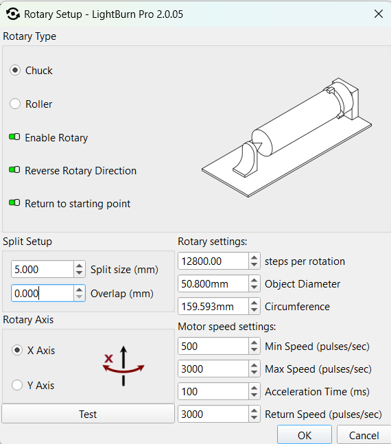

These are the rotary settings I’m using, the steps per rotation are correct per the documentation with the D80
Using the Test button and a piece of tape to check the rotation works correctly as well. I was using overlap before but changed it to 0 to see if it’d fix my problem but it doesn’t.
Any help would be greatly appreciated!

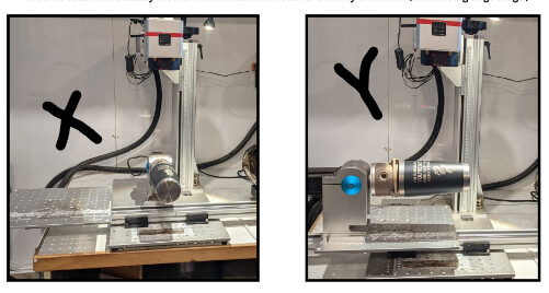

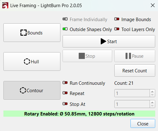

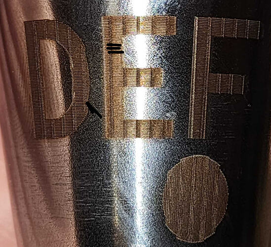

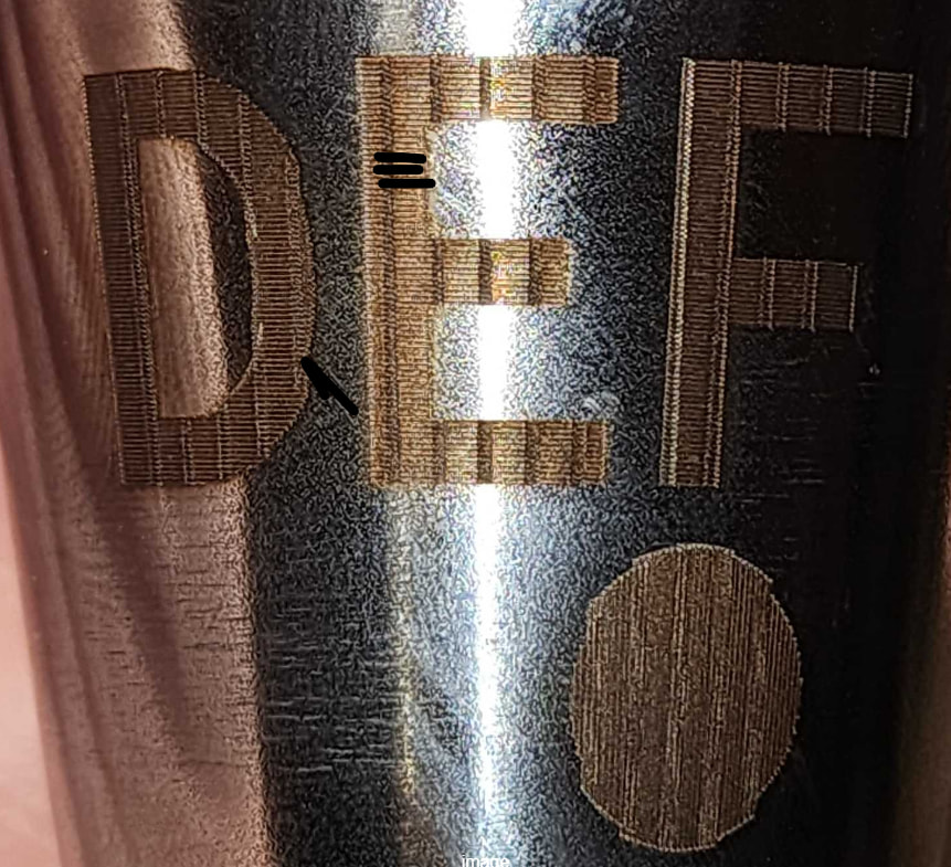

So if I hadn’t read your post and just saw the photo, I would say your circumference is not measured/ typed in correctly, or your steps are wrong. If you would, please try 3 capital letters “DEF” about 15mm high with a split of 2.00mm and 0.00 overlap and post a photo. Also, there is one more screen just before you start engraving, please get a screen grab of that. Also, double check that you are rotating on the X axis.
If you have this:
You should look like the first photo:
Might take a few back and fourths but we’ll get it straightened out.
Also post a screengrab of your cut settings.

It’s a close up photo of a metal shot glass I’m trying to engrave some artwork on, I was only trying to show that the dark lines very clearly don’t align.

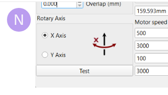

(these settings are just for testing)
I am on the x axis and oriented correctly
It looks like it’s still overlapping even with overlap set to 0
Realized I was using the outer diameter instead of the inner diameter. Seems to have made it better but I’m not sure if it completely fixed it
This image tells me the tumbler is not moving enough with each split. As we can’t enter a negative split, decreasing the diameter is probably what is needed, or your steps are incorrect. It also looks like you are scanning perpendicular on the letters, instead of (preferred) parallel to the axis, like your oval.
Increase circumference will close up split, Decrease will act like negative split and move splits apart which is what it looks like you need
Increase steps per rotation will also act like negative split and open it up.

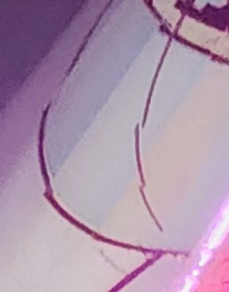

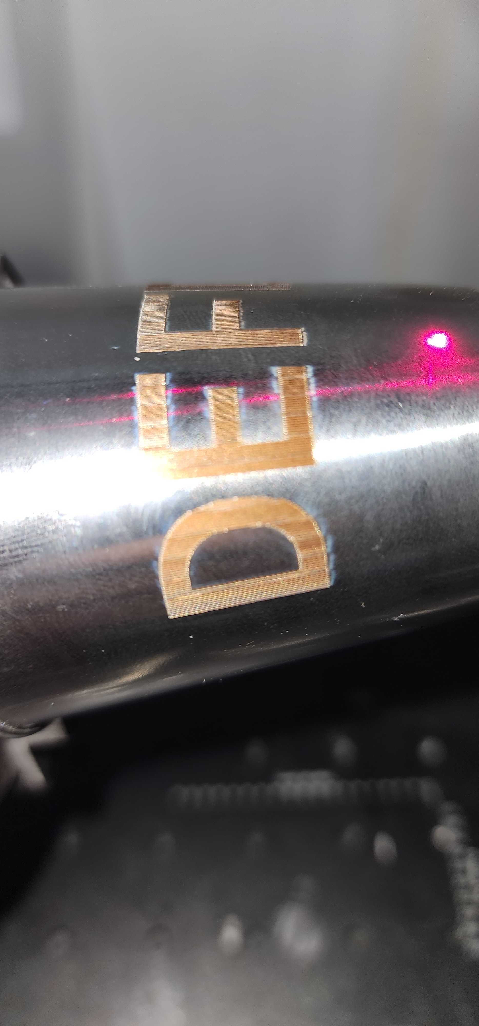

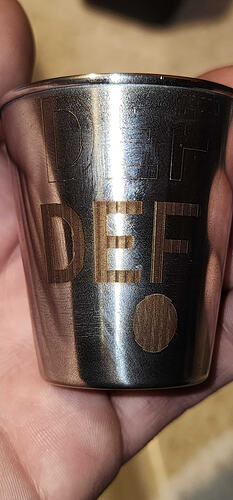

This looks a lot closer, hard to say due to focus. Your tumbler looks like has a lot of taper, adds a level of complexity. I assume you are tilting the rotary up to make the top edge level. With a lot of taper you will probably need to reduce the splits, the large split I asked for was just to exaggerate the error. What size lens do you have?

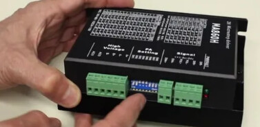

If you can look at the microstep driver, take a photo of the DIP switch positions and table. (Need to open up the case)
I see your output center is 58, that would be center of a 116x116 work area.
I realized the direction was wrong after i did the letters, thank you!
The explanation with the diameter helps me understand a lot better.
Yeah, I have it level, I did not use a taper warp though and left everything as is for this (i had tried before thinking it may be the issue)
I’m using a 110mm lens for these, I also have a 300mm lens though.
Not sure if this photo is good enough
In the photo looking for something like this:
dip switches:
So output center, a 110 lens if you are dead center under the lens with the rotary would be 55, did you determin58 was correct?
If you have enough tower to get a tumbler under the 300 lens you might want to try that, it would be more forgiving but I think the majority of your problem is circumference. Like I said earlier the taper adds some complexity. I would go back to a split size 10 times of your LI, like Line Interval of 0.0254mm and a split of 0.254mm. Taper warp won’t affect the splits. Once you get really close we have some tips to really dial it in. Try rhe 300 lens, don’t forget to change your output center to 150 +/- depending on exactly where your rotary sets.
