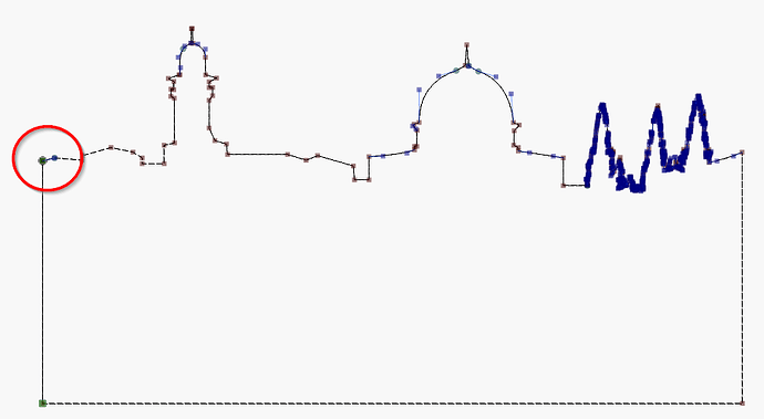

What could be the reason why I can’t mask an image? I took an image, marked it with closed lines from beginning to end, and the image cannot be cut according to the lines, but when I try to draw just a circle, I can mask it. I would appreciate help.

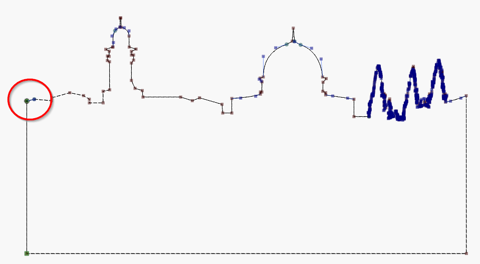

Your shape is not closed, as we suspected already:
You can check this by using Edit → Select open Shapes. It directly selects the shape. You can either manually close it or let LB do it. The functions are also in the Edit menu.
Thanks, this function is in all the version?
Yes. You can also use the node edit mode and drag the nodes together. They will close automatically.
