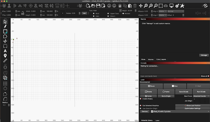

It’s possible you may need to lower the number of sidebars you have on the side of the screen, if you have 3-4 of them open. Below, I have Macros, Console, and Laser tabs each with their own screen allocation.
For instance, when I have 3 panels open on the right here, I lose the ability to reduce the size of the window, because those panels cannot be compressed further.
Well…when I closed all sidebars but two I can resize it smaller. However, having to do that is nuts. I could fit the same sidebars in v1.X without issue. The way this is, I can’t have the Cuts, Laser and Move sidebars open at the same time. I use all those and always have…:frowning:
