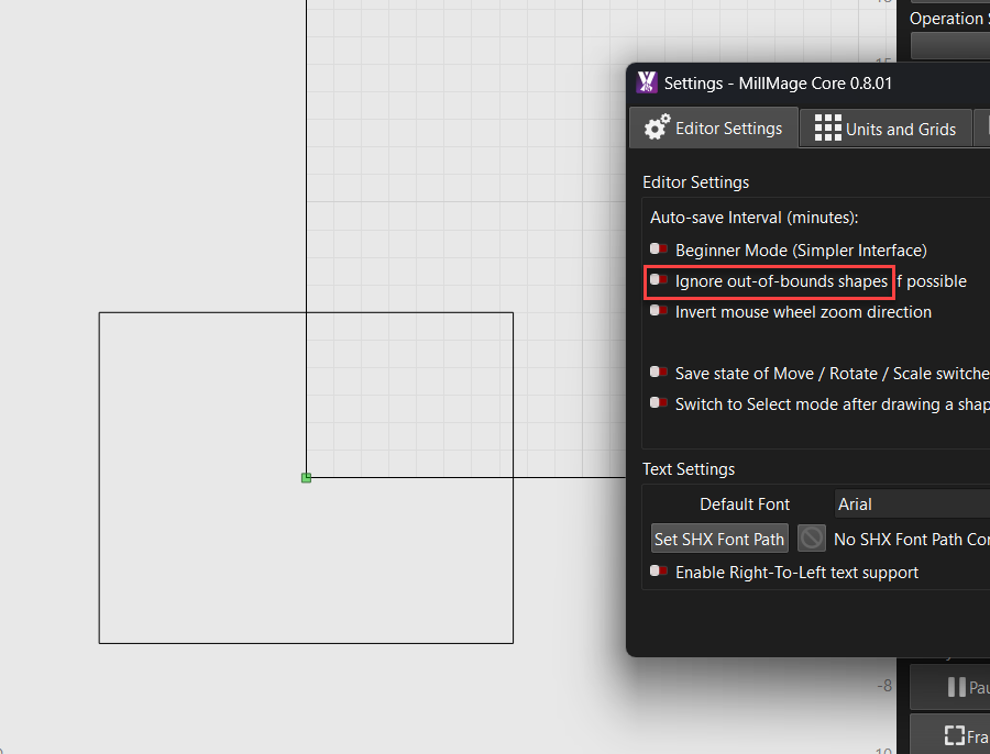

MillMage does not show the machine bed, it only shows the block of material you are working with, and the XY project origin can only be anchored in one of the corners of that material or the center;
VCarve also anchors job origin to stock material in a similar way, although it does also allow an XY offset from that position:
If more flexibility is required in MillMage, you can move your shapes/operations relative to the origin.
Shapes/operations that are outside the material will still be valid, but you would need to disable “Ignore out-of-bounds shapes”, otherwise the shape would be ignored and not produce output:
If the project origin is set in the center, the operation can be set to any position relative to the origin while retaining the benefit of a full simulated preview;
Hopefully I have understood your question? Let us know what you need MillMage to do and why - the developers will appreciate your input, and are always open to suggestions.
I’m getting out of bounds errors and I have it turned off.
I also tried turning it on. And rebooted both times
