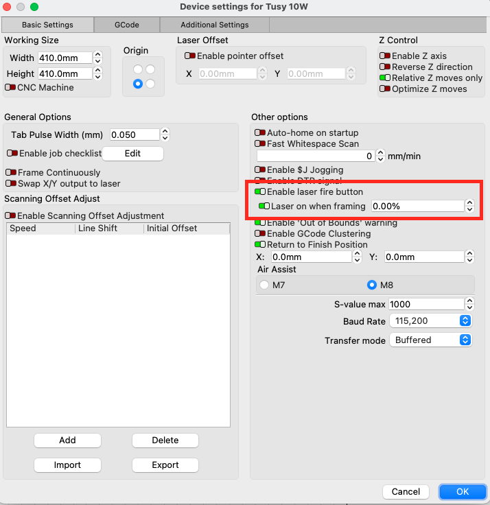

Then I tried the Use origin option it kinda worked but I was off for couple points. Also Is there an option to enable laser beam so I know exactly where it cuts? or is laser specific option this?

Congrats and welcome, glad you found Lightburn and this forum.
Read the bellow docs:
Device Settings Window (Wrench & Screwdriver Icon) Set power to .5% to 1%, just enough so you can see it withoud damaging your workpiece.
